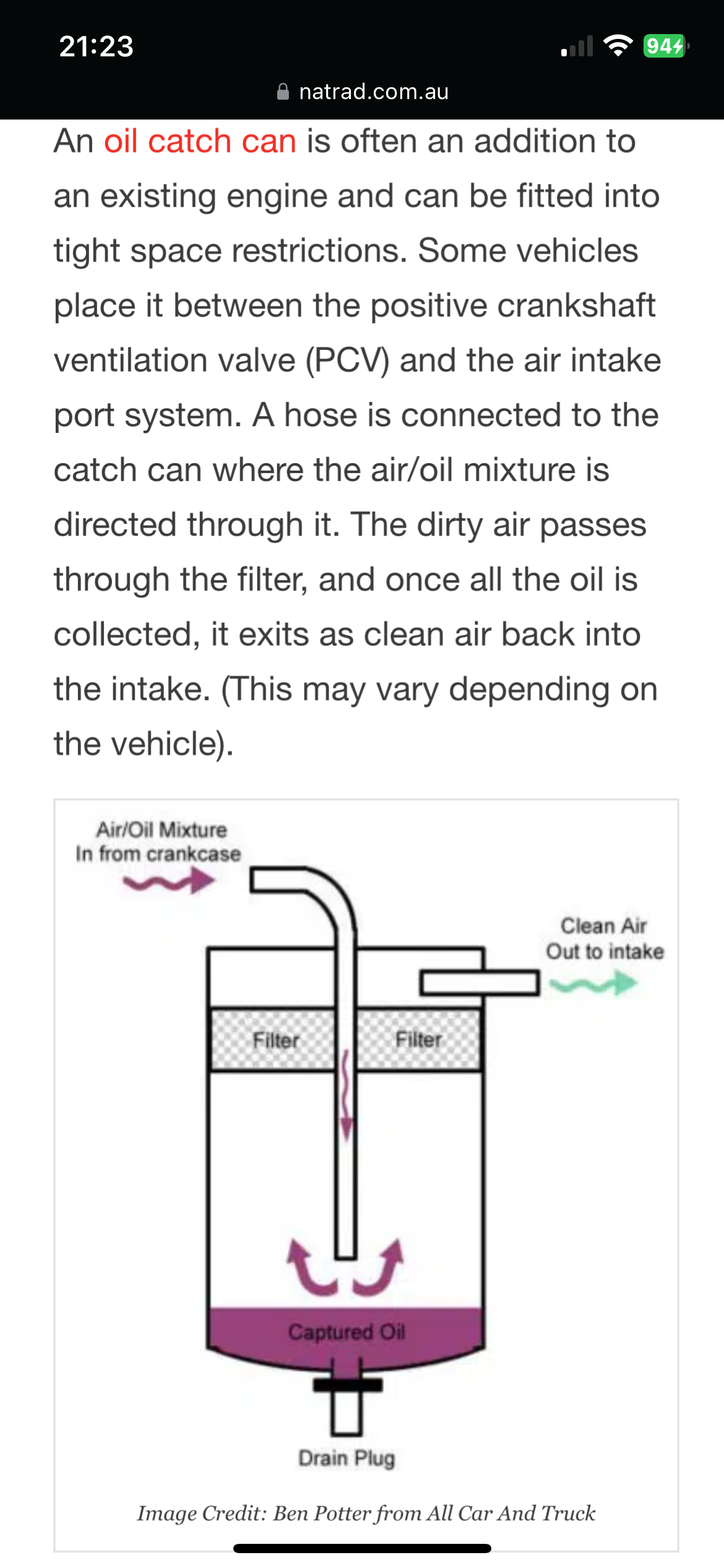

I like the idea of installing a breather / catch tank on my track use only 182 & not putting the oily vapour back in the intake, I’m still using a standard intake manifold & looking at options, I see some people just use a length of pipe with a filter on the end from the fitting on rear of the manifold & blank the larger one off, I quite like the idea of the set up in the picture I’ve stolen from an old thread on here, not seen any others like it, I take it the idea is it creates vacuum for the catch tank, would the catch tank be sealed or vented? Thoughts please people.
If that right side pipe on the catch tank is going to the inlet , that’s wrong .
Because all that would do is suck the oil fumes back into the engine , which it what you want to prevent .
All you need to do is run a single pipe from the back of the rocket cover outlet into the catch can , and vent the right outlet with a pipe and filter .
Under no circumstances must it be connected to and vacuum.
None Clio but that's how mine was set up. Caught plenty of oil and kept the throttle body clean.

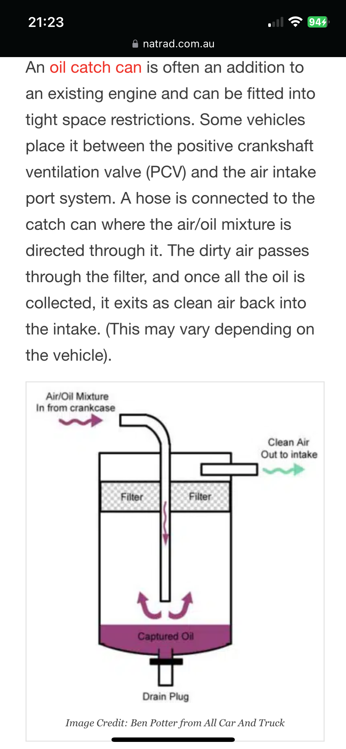

Thanks for your input gents, I’m under the impression that the catch tank filters the oil/water that comes out the rocker cover breather & the intake pipe creates a vacuum to pull the clean air back into the intake! I could be completely wrong though.
See attached picture

As above have the catch tank connected to breather plate and other port open to atmosphere for performance. It will still be pulling oil fumes in if connected into inlet.
It'll still be an improvement though surely if you don't want to vent to atmosphere?

This is how the system on the xu9j Peugeot engines were, the catch tank, which was also the filler, drained to the sump though.
The oil vapour condenses on the scouter and and drops down.
You want a mild suction on the crankcase as it reduces leaks also.
Dave!
I am setting up my catch tank soon and I am planning on recirculating the output from the catch tank back to the intake. The idea is to have the negative pressure built inside the intake manifold to help release positive pressure in the crankcase and to pull out the oil vapours more effectively via the breathing system. I guess as long as the catch tank baffles adequately there shouldn't be as much oil vapours sent back into the intake. This is just my understanding at the moment, maybe the pressure build up in the crankcase is not a big ideal on an NA setup though, not sure.
I fit this today and decided to vent to atmosphere after reading more about the topic, it is a small tank and managed to mount it at the front. Can also be mounted on the front crash bar as well but it would need a bracket. It would be more convenient for sure but it is what it is.
I ended up removing the catch tank, not a single drop of oil since I installed it and was getting in the way when removing the battery cover. At least for my use it didn’t make sense, for a track car I guess it is worth having a larger tank.
