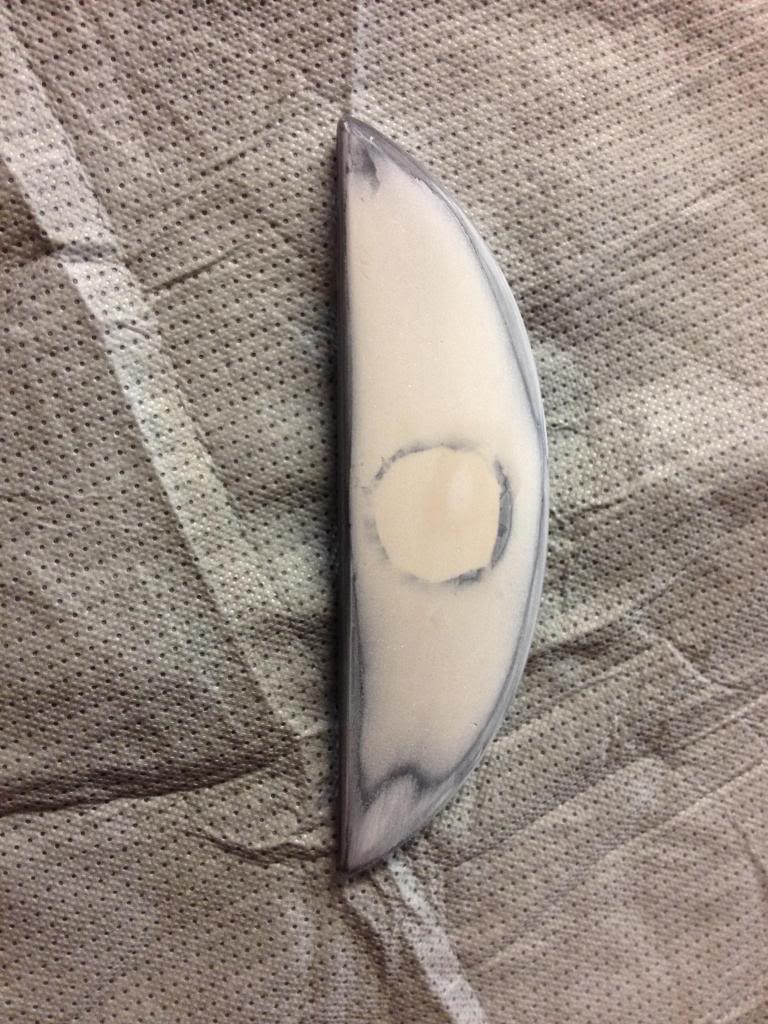

Hi what shall I use to blank the hole? It will be carbon wrapped anyway, but just need something to fill the hole.
Would a grommet or something similar.
Thanks!

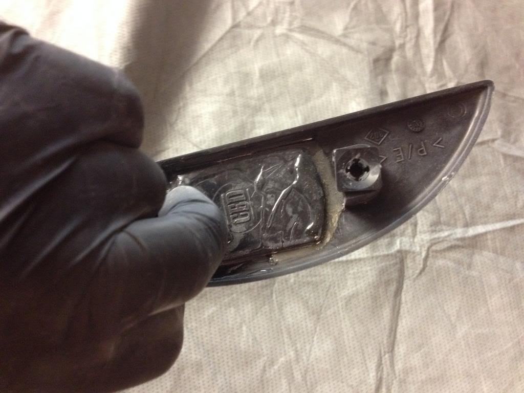

As above, thats what i used. Chopped off the raised part, blanked off the whole on the back and filled it, sand it down and lucky for you it doesnt have to be pefect as your wrapping it instead of spraying it
M.C..
I used a plastic conduit cover cut down (only a few pence from toolstation) and epoxy resin to stick it in place then filler.
