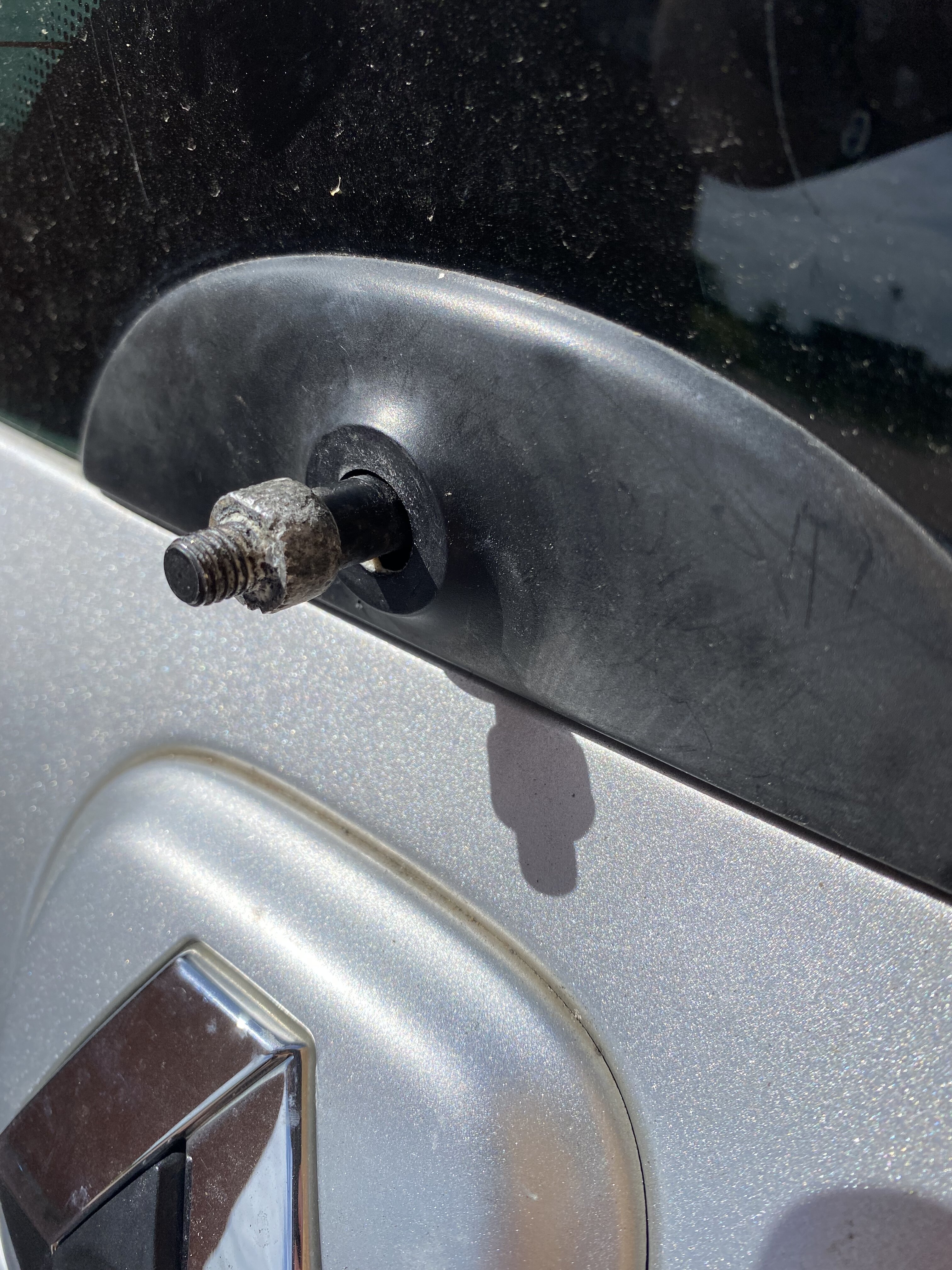

My rear wiper decided to fling off I’m not sure if it’s easier to buy a new wiper motor. I’ve tried removing the spline? But she’s welded on there good and proper. I’ve bought a new wiper arm Just stuck on where to go from here. Much appreciated 👍🏻

Wee set of Stillsons should sort that, or cut through carefully with a junior hacksaw to remove it

I used some locking vice grips to get mine off when it was like that, it made such a huge BANG when it eventually came loose :ROFLMAO:
