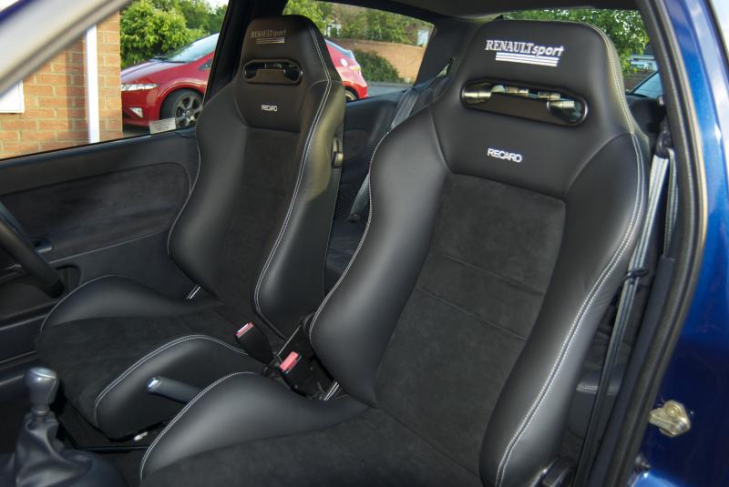

I used Integra Recaros (retrimmed). Not any lower than Trendlines, but the extra support they offer makes a massive difference. I think the aftermarket Recaro subframes are slightly lower than the Trophy OE frames. They must be as the original slider handle won't work with them, you have to use the supplied Recaro one. Moving to buckets soon though as motorsport beckons.

vecbtb, these look fantastic, did you get them retrimmed? If so, where from, that looks like a great job?!

Retrimmed by Edge Automotive interiors. Not cheap but they are in Nappa leather and with new base foams. In hindsight I probably shouldn't have bothered as I've only sat in them half a dozen times in the last 10 months! Now going hill climbing with the car so I don't need them. Before anyones asks, they are provisionally promised to Lawro!

Well lawro's car is prob going to be one of the best on the forum with these in on top of how it looks now!!
They looks amazing but also look on the piss, is it just the photo or do they lean outwards towards the doors?
