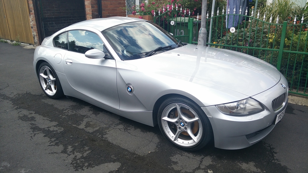

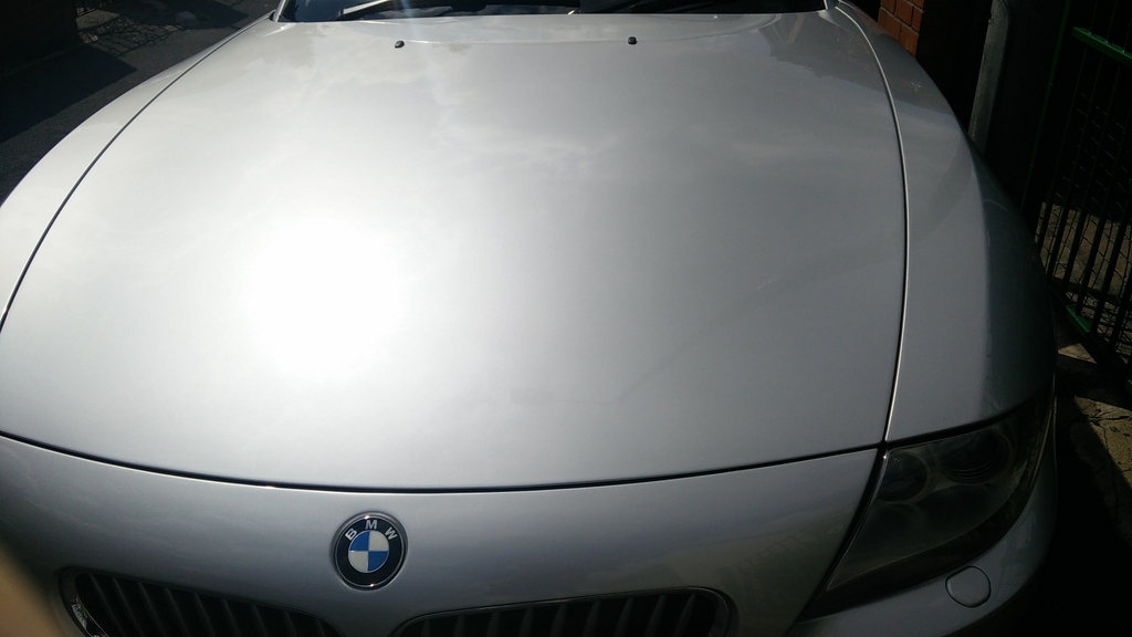

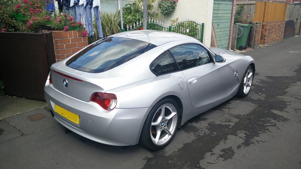

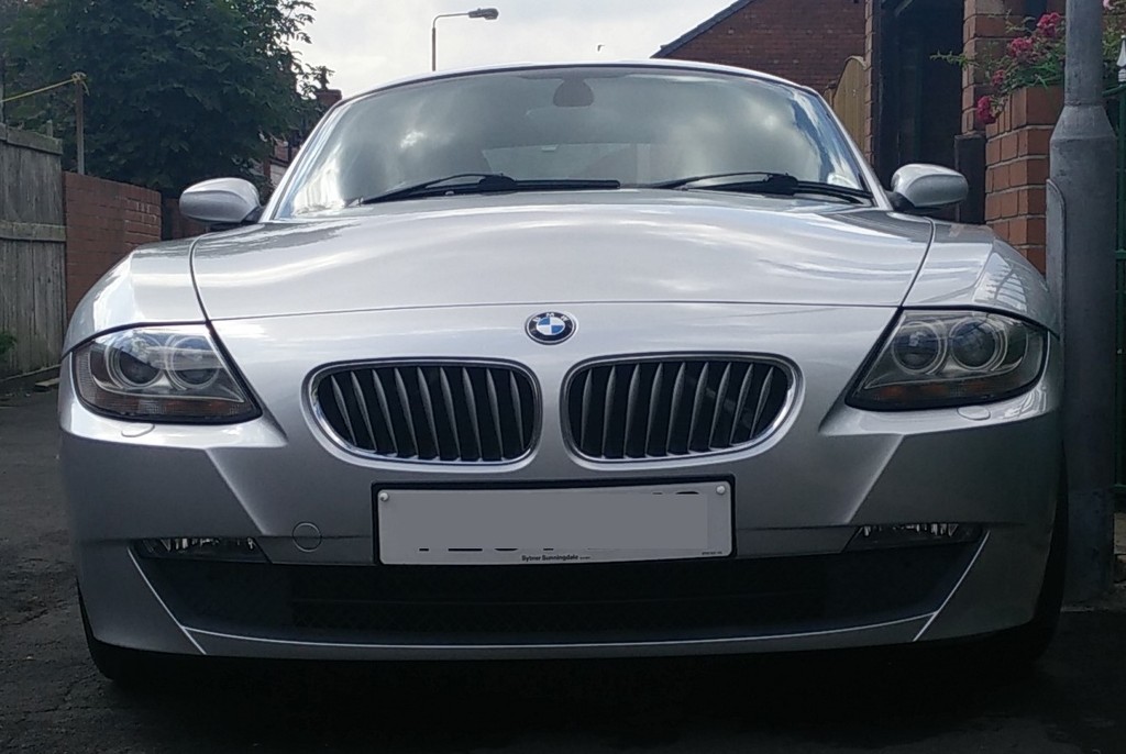

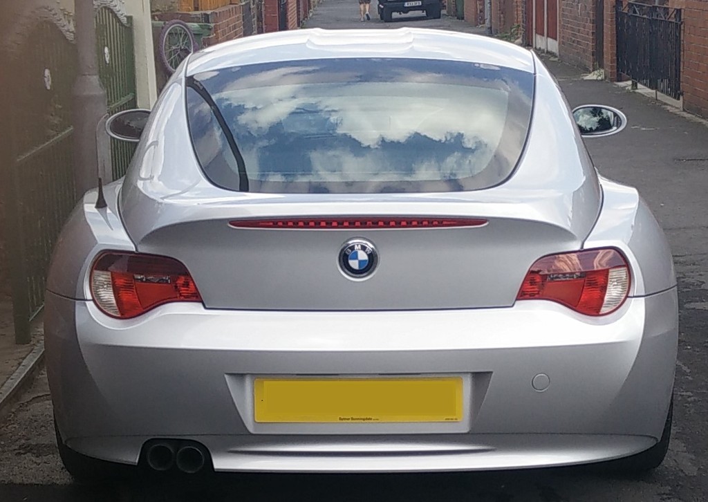

Cheers Knuckles got round to doing it all, heres the end result
