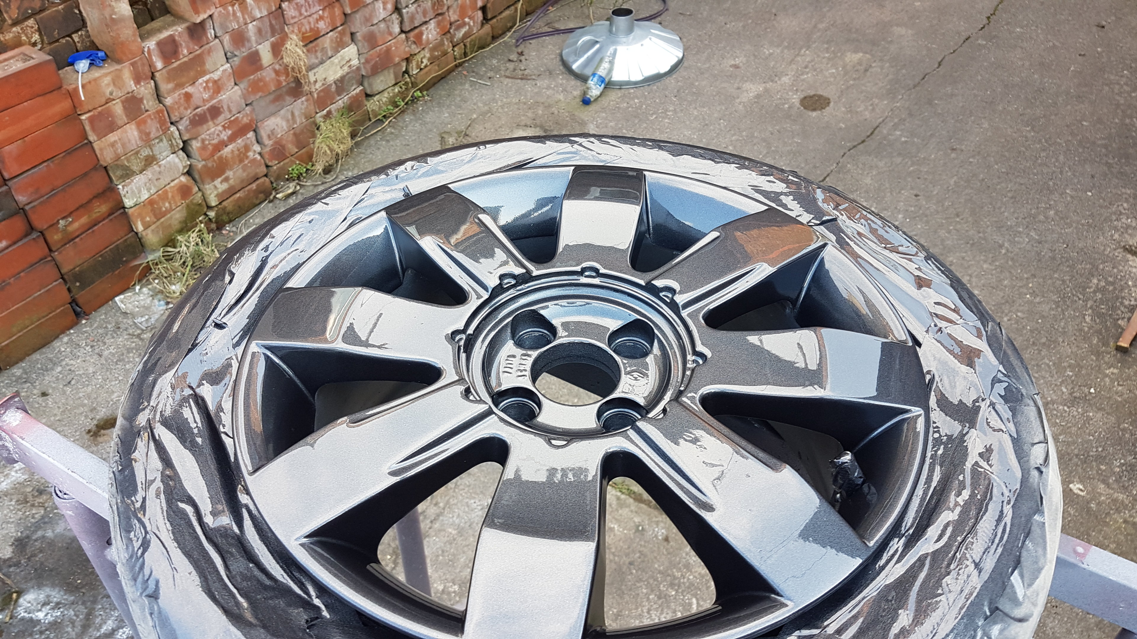

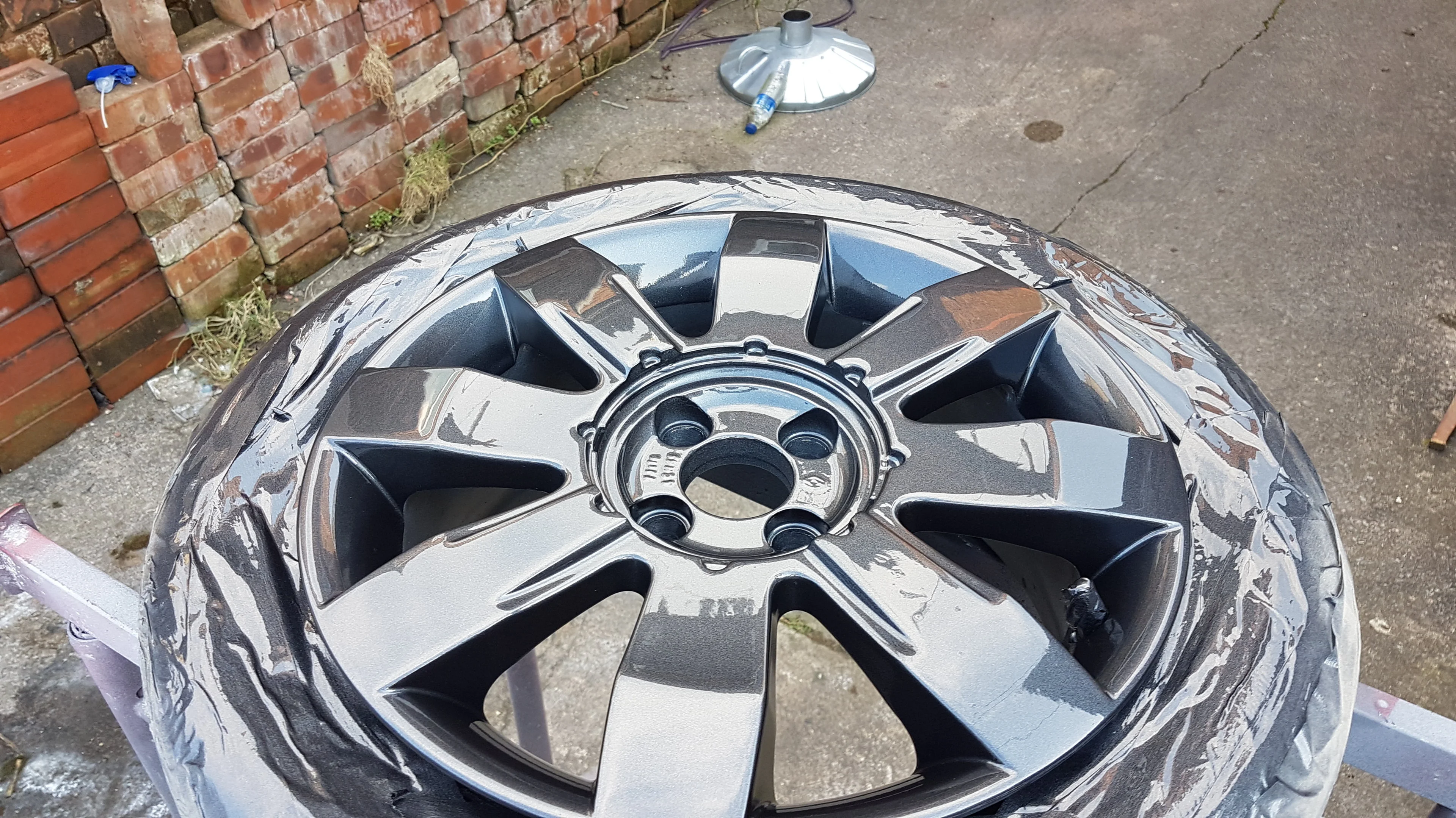

This didn't come out as glossy as I'd hoped, what's the trick to gloss lacquer?
