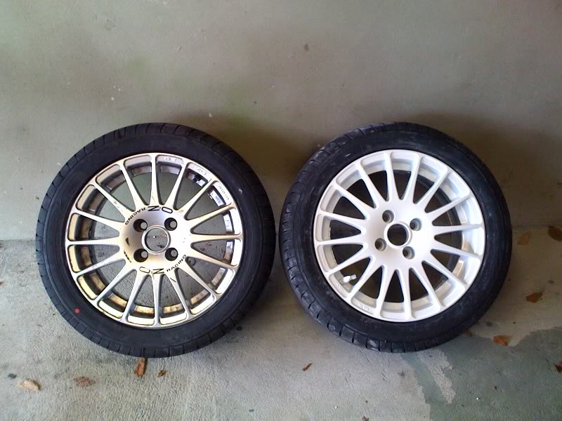

be patient ir you'll just f**k it up and have to start again :eek: , sand......fill any deep scratches........2/3 coats of primer.........3 coats of paint.........3 coats of lacquer, ended up from this
to this, only got another 4 to do now :(
