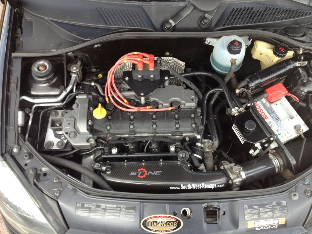

Love the rs2 on my mrs car with 197 cams, drives mint.
Sadly I don't think they are available currently though :(
This is my mrs one, I think she has done a really good job of it :)
  182/RS2/ Turbo/Mk1
She did the rs2 install and all the tidying up in the bay first of all.
Then a year or so later the aux belt slipped under the Cambelt at which point it had to be rebuilt.
I built the bottom end up with new rings etc and a set of arp bolts, she rebuilt the cylinder head with supertech valves, then we fitted the head on with arp stud and nuts and the 197 cams in it and a 182 exhaust manifold and cat between us and then mike from Mwm timed the cams in with me as he's worked out the best way to time 197 cams in a 172 as they don't work well on standard marks.
So it's about 50 percent hers internally and 100 percent her work for all the external bits.
