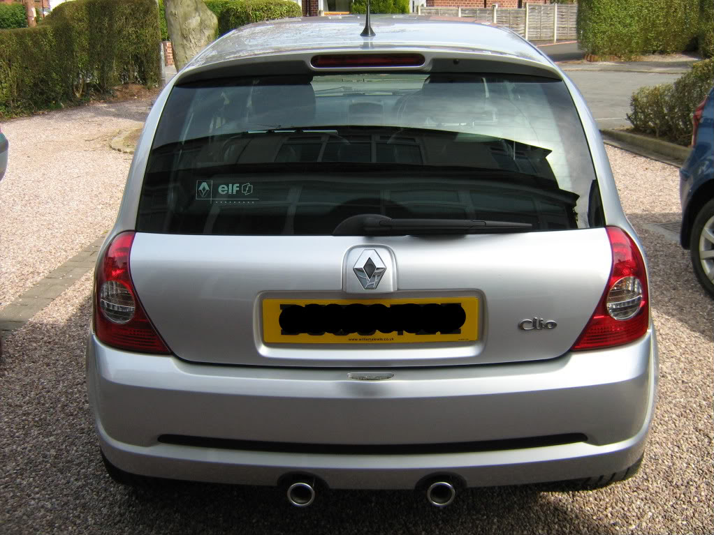

whats the best way to remove the "renaultsport" badge on the boot?
got the new style "renaultsport" badge waiting to go on
any ideas/help is appreciated.
also the clio badge, is that a clip on one?
Darren
It should look like this then mate
yes 'Clio' is a clip on.
be a bit brave perhaps and fill the holes and place the new RS badge where the clio was, same as the 197's ?
ive always used a filler spreader like a credit card! heat up with a hot air gun and its east a bit of polish and its clean, then line your new one up and done!
I did mine on the weekend. Was best in the hot weather. Used some kettle waster and then lots of rubbing with tar remover. Got a right bliser on my finger. (poor me).
