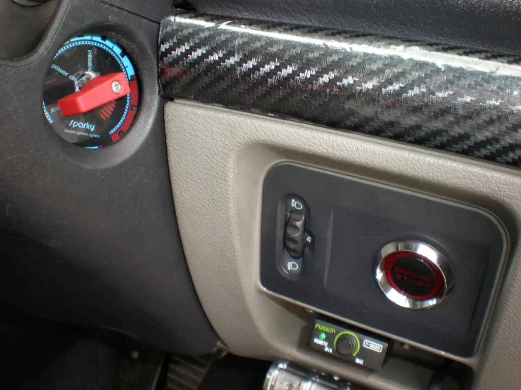

Ahh okay might give it a go after work. There is a key permanently in tr car which turns but the immobiliser sensor is rewired outthe way so you put your key in the separate hole and turn the key to power on then press the button to ignite the engine. The key permemntly in is shaped as a switch you can just see it on my profile pic I'll try to get pics up tomorrow to explain better. Thanks for thehelp

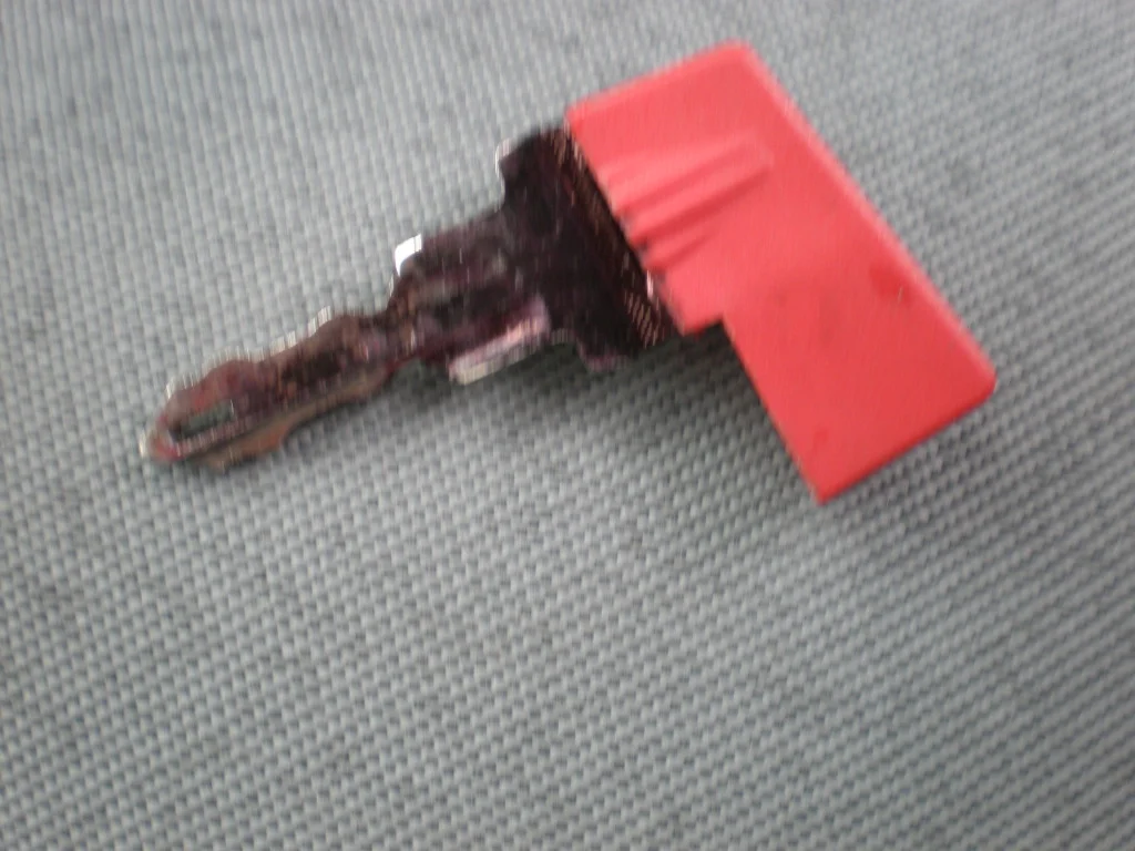

I paid £5.50 to get another key made - he used a house key as it didn't want the immobiliser part. I then hack-sawed the circle off and superglued it to the tip of this switch from a gas or water switch.

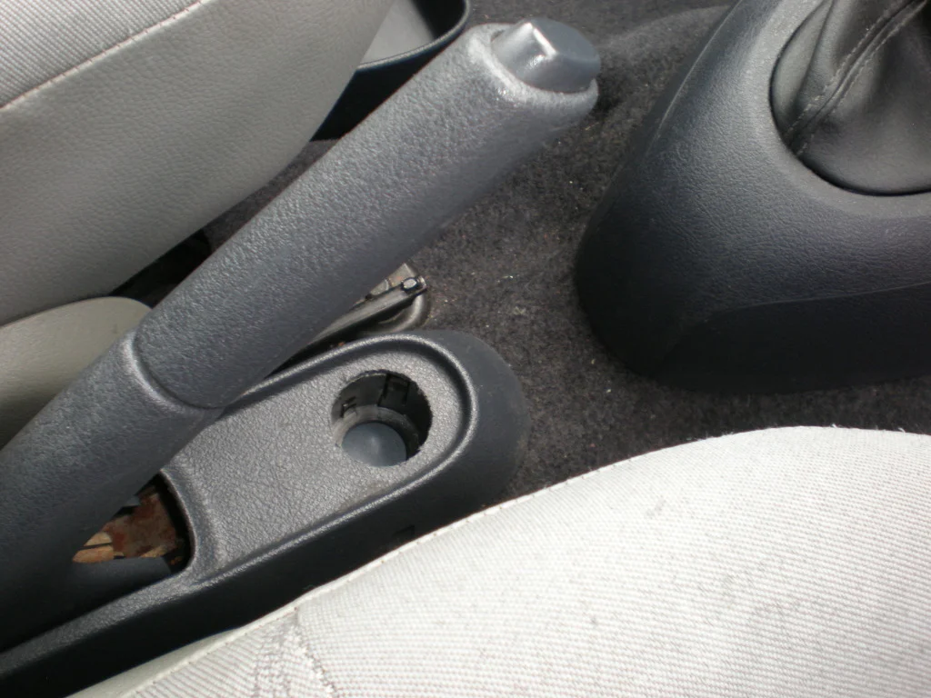

I then drilled a 35mm hole in my handbreak base which is where my immobiliser is super glued to. The base is perfect depth to hold it and not need to hang, any larger hole and the immobiliser would have had a ring of air around it. To get the immobiliser off you must cut the three cables going onto it (2 green- or maybe brown I am a colourblind person... 1 red I believe) Then extend these, if you let the cables touch one another you will blow a fuse, other than this if you choc block it back together no damage is done, I ran my cables along the steering column base under the gearstick area then under the carpet in that little gap you can see in the picture.

Finally I purchased a Type R electronic start ignition button, which came with instructions, wired the three cables as instructed and wired the fourth to a metal part of the body to ground it.
