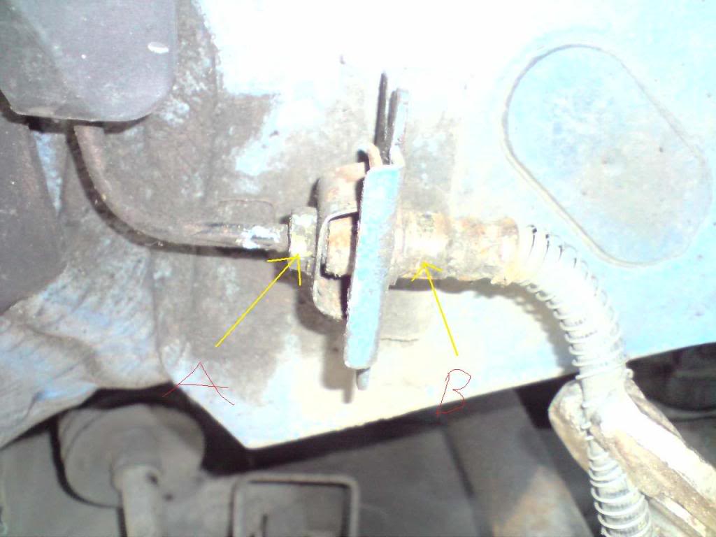

Can some one help me get these brake lines off
I was expecting to remove the lines my undoing B but B isnt a thread
do i use A
Dont want damage it
A unscrews from B (which is fixed - there should be flats on it for a spanner to stop it turning whilst you undo A)
You must unscrew A!! B is fixed onto the bracket by a pattern thread and no way will it turn. Once A is off B will just pull out.

Probably best to get a brake line spanner. They are often corroded and a pig to get off as well, get some plus gas or similar. You don't want to knacker anything by forcing it too much.
