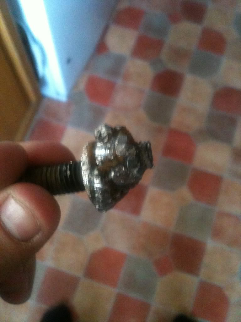

Got the fucker out tonight though, used epic amounts of welding as the welded on nuts (and a bolt once too) were just snapping off without turning the bolt. Eventually it came though :D
