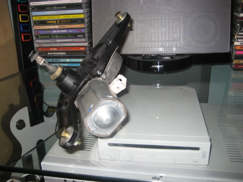

Trying to remove the rear wiper motor guys.. Got the rear fascia off but why are these 10mm nuts not frecking undoing?
They just seem to be spinning and not coming off?
Try getting small set of vice/mole grips or plier up the back to grip the bolt head if possible to stop it turning and allow the nut to free off.
The bolts have no normal hex head on them and are flat and go through thick rubber washed things.
i found just pressing your finger on the back of the bolt was enough pressure
Tried that mate, had to use the above method to get it out in the end.
