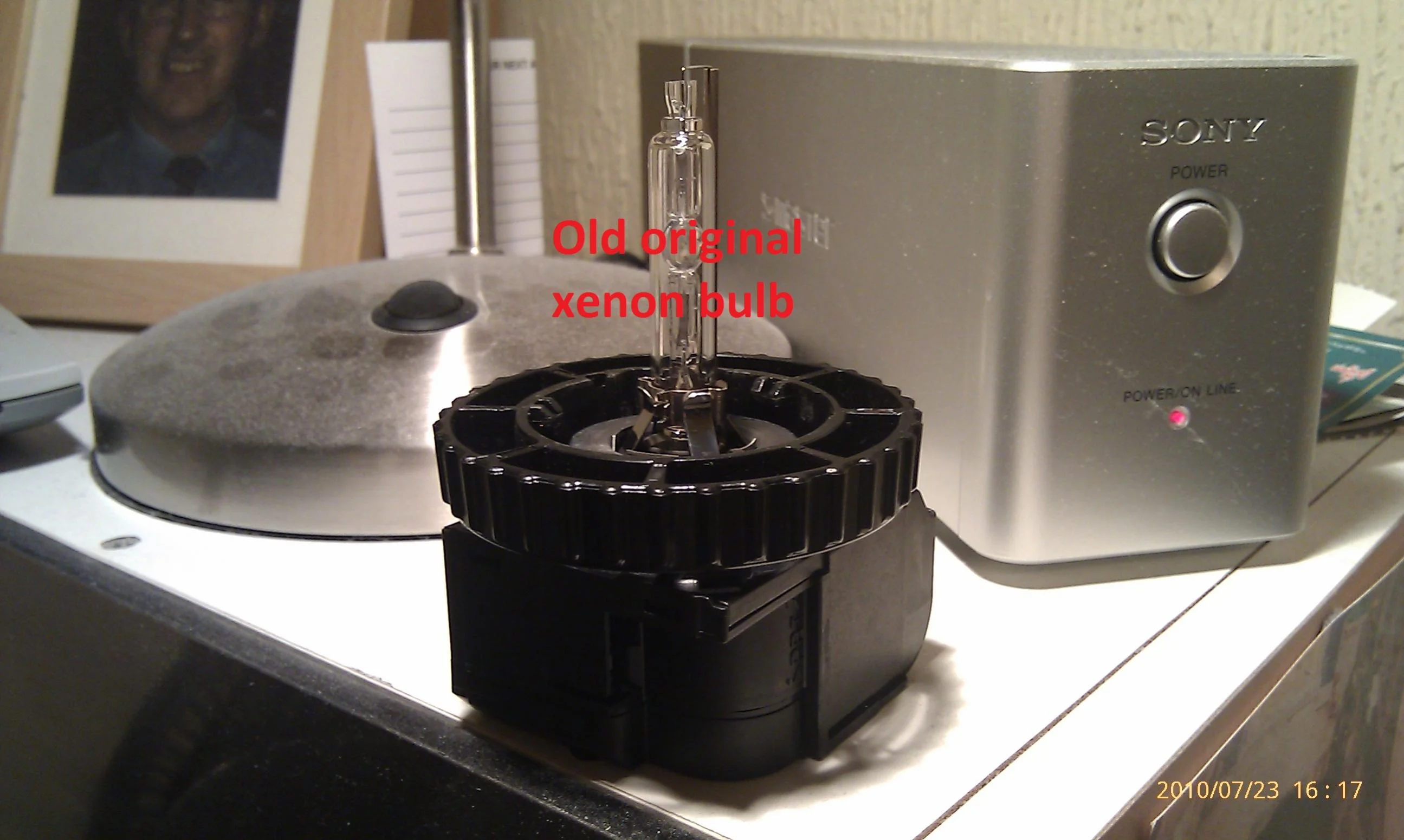

how do i remove the bulb from this ignitor? do i just pull hard and hope i dont brake anything?

You see the bit on the back of it?? (the bit touching the table) turn it (cant remeber what way) and there is then a "collett" holding thr Xenon on.
Hold the round piece in one hand and then turn the box shape thing anti clock wise, it takes a little bit of force but it will go, then the collar (round bit) will come away from the front part and release the bulb.
