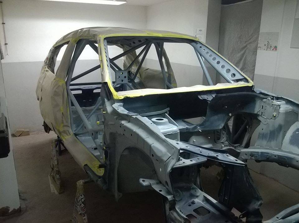

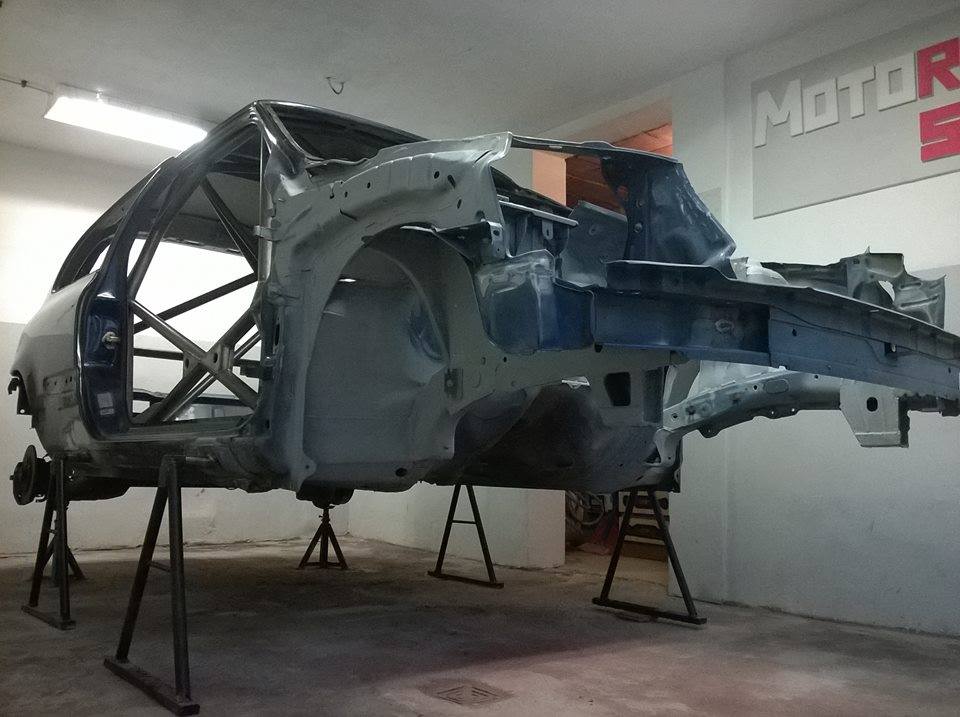

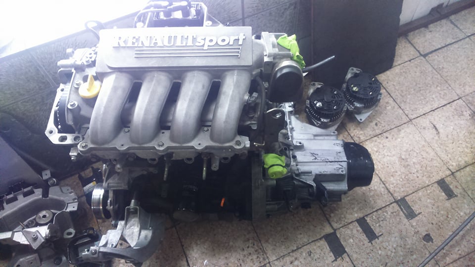

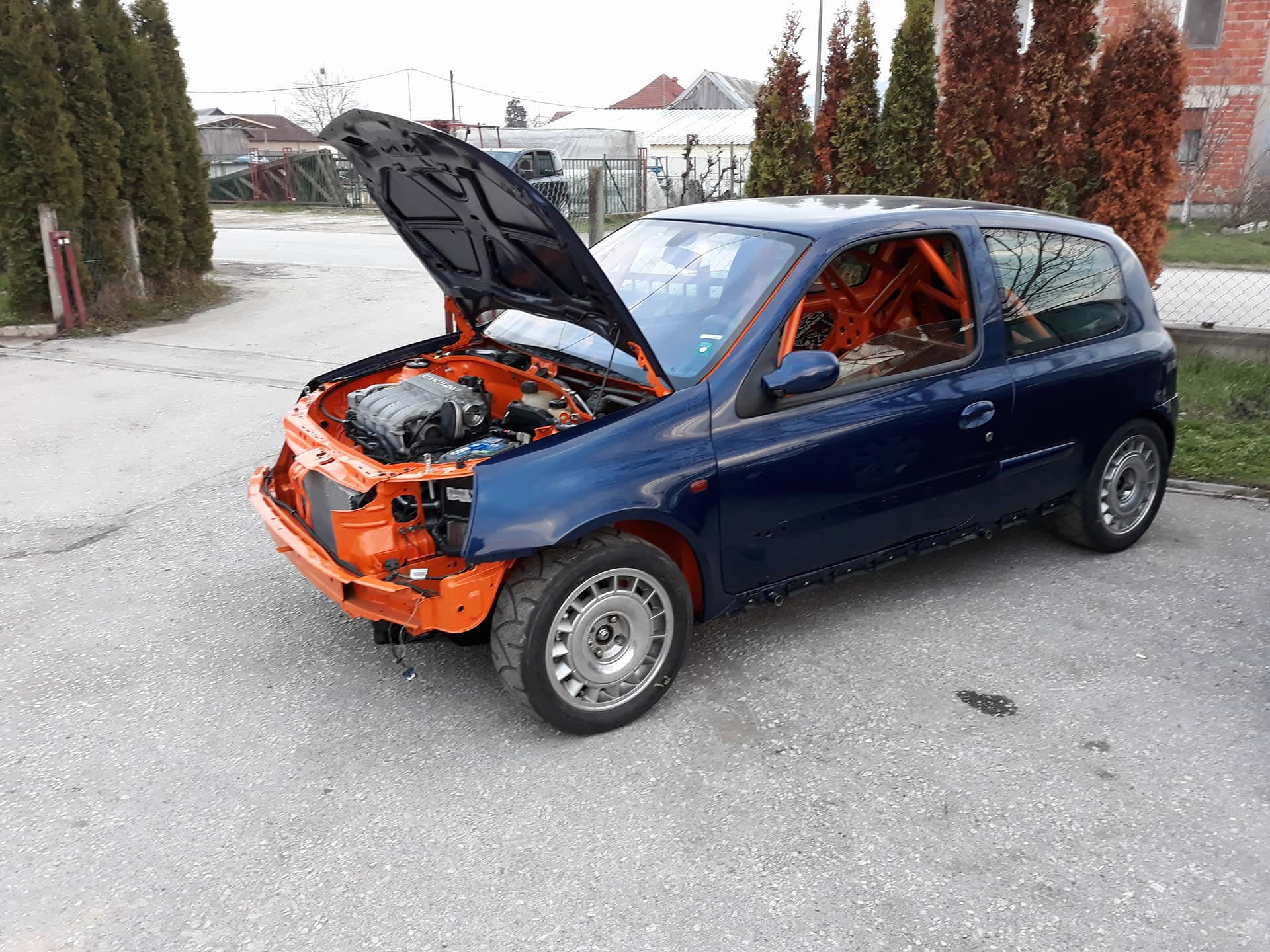

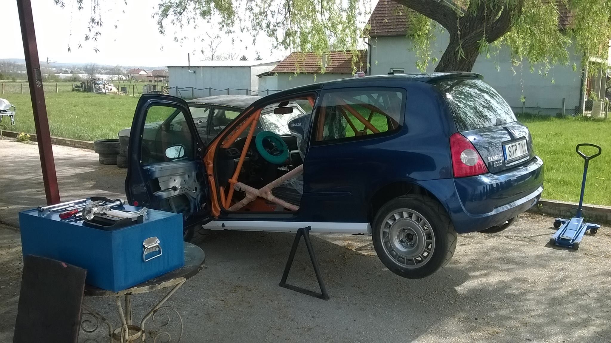

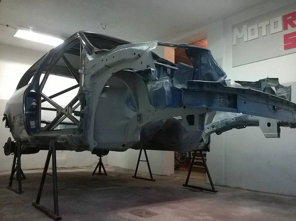

The weight of the car is 1006 kilograms, the engine is a serial renault sport, the car is coupled by fia homologation spec N reli

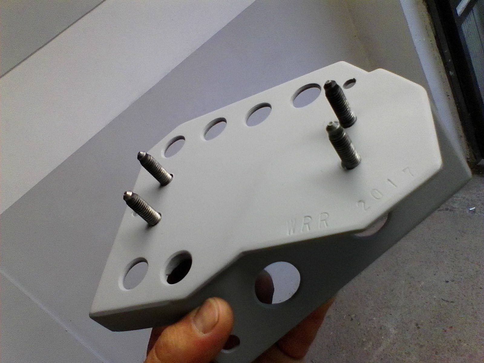

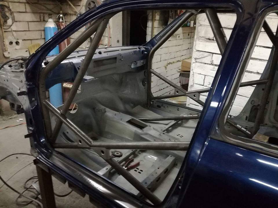

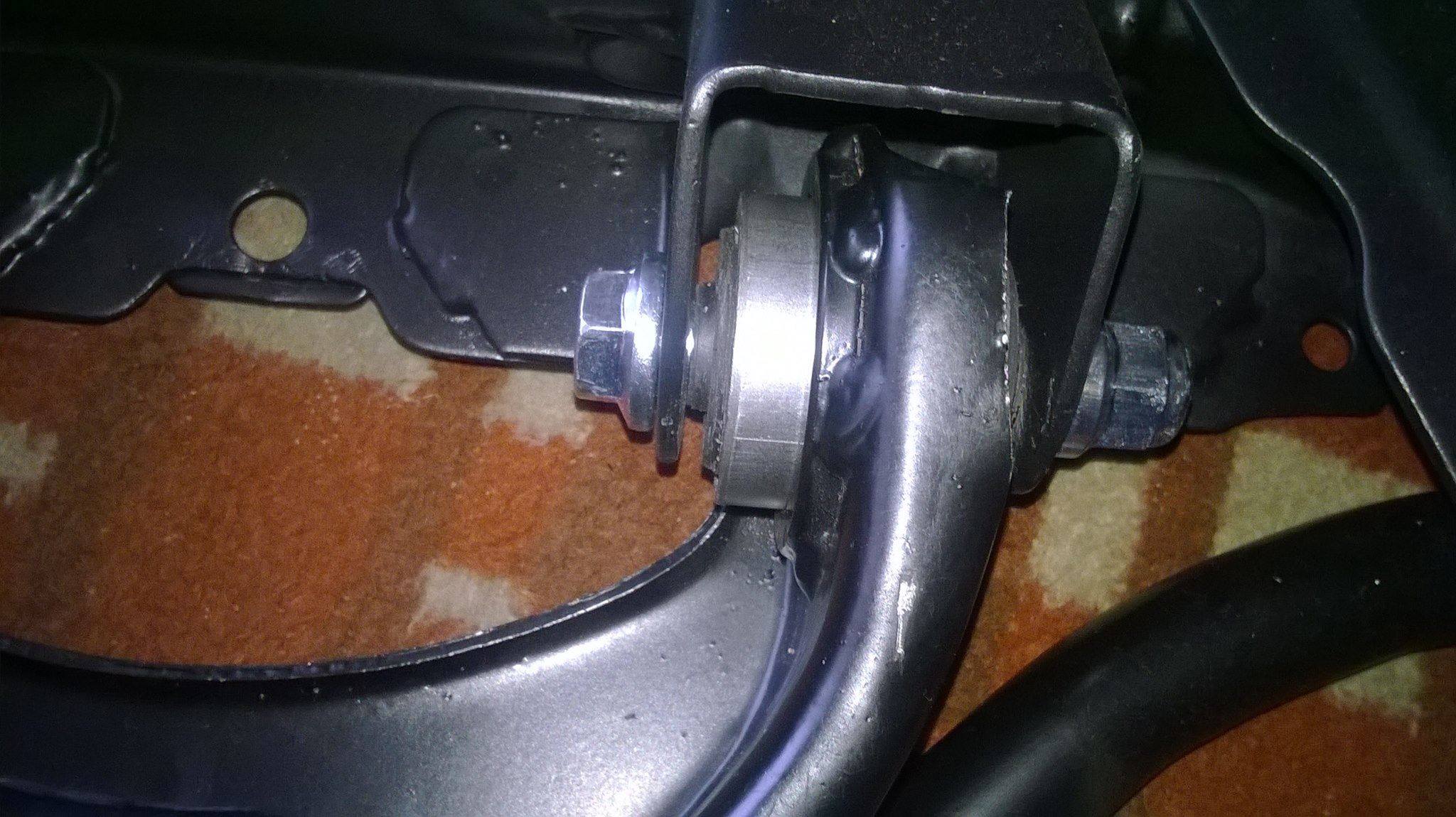

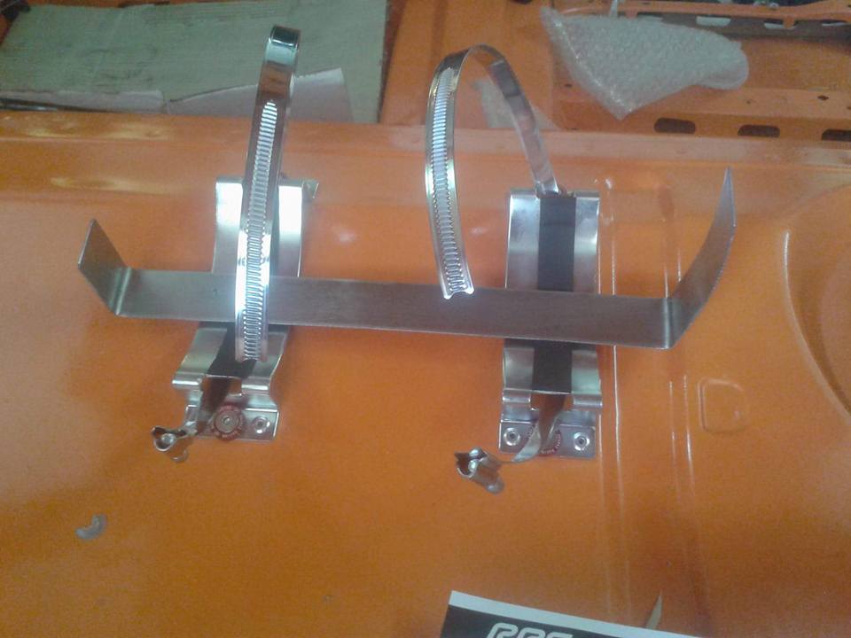

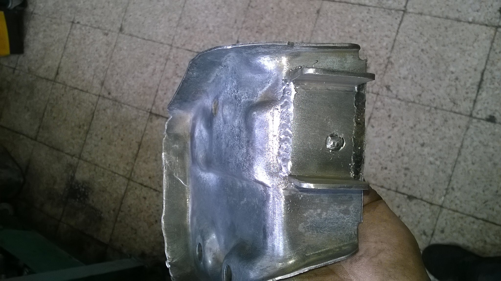

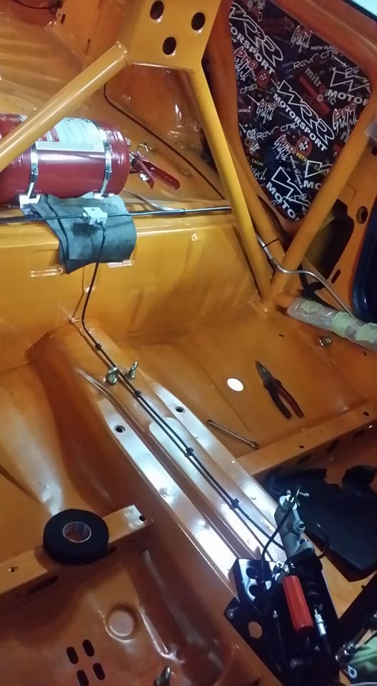

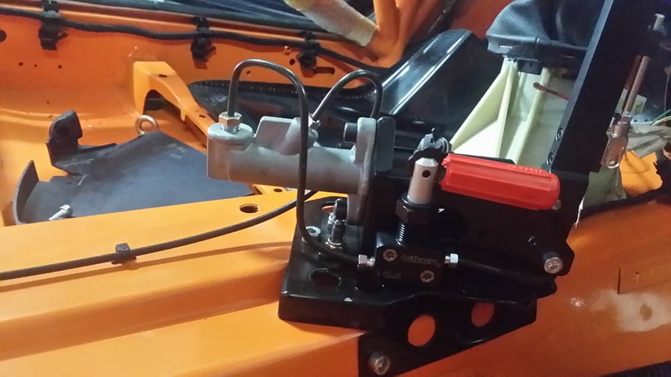

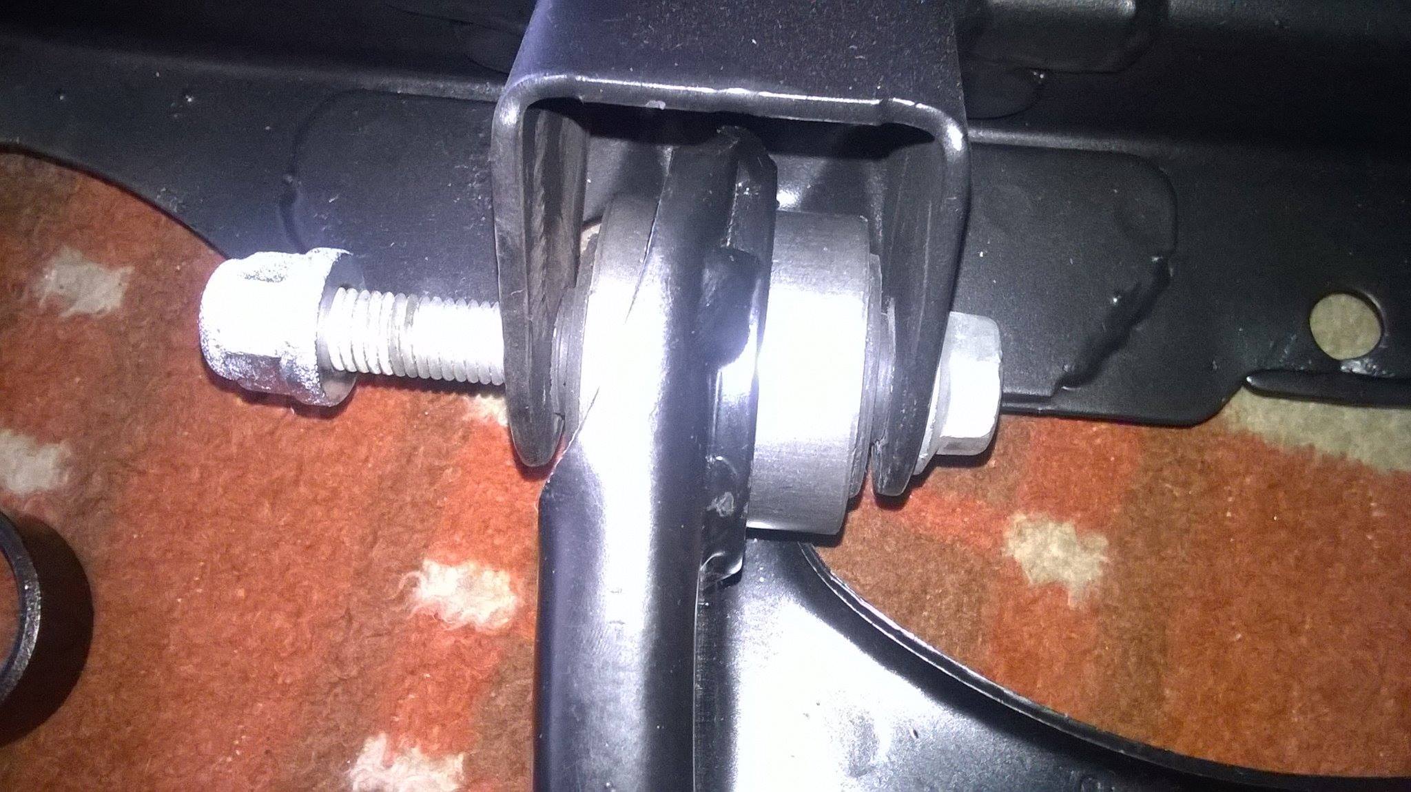

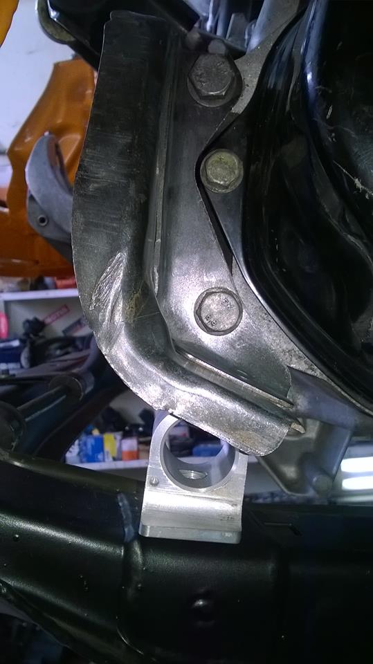

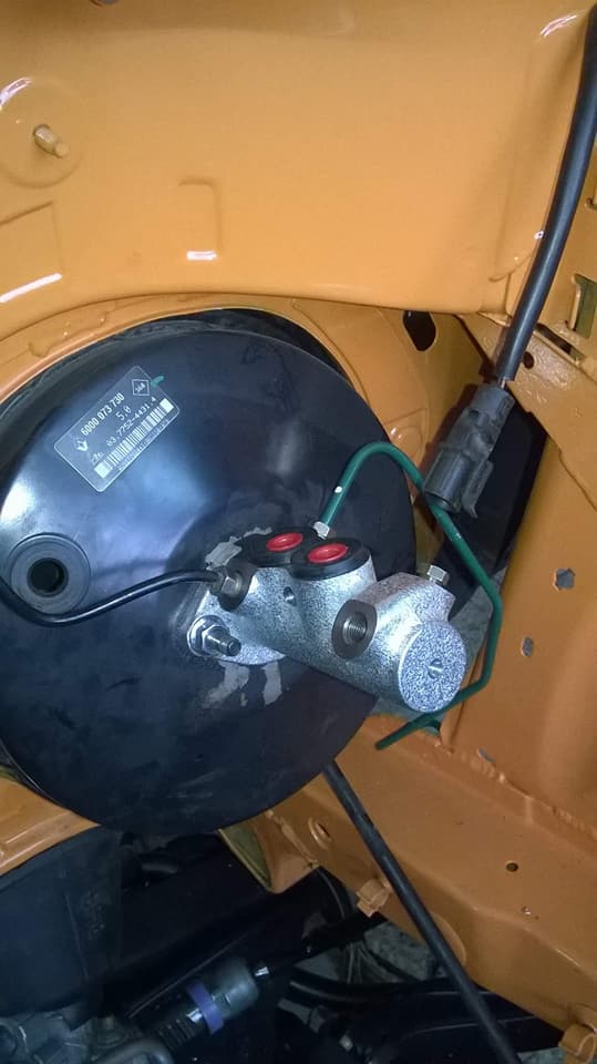

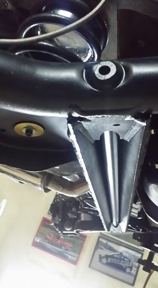

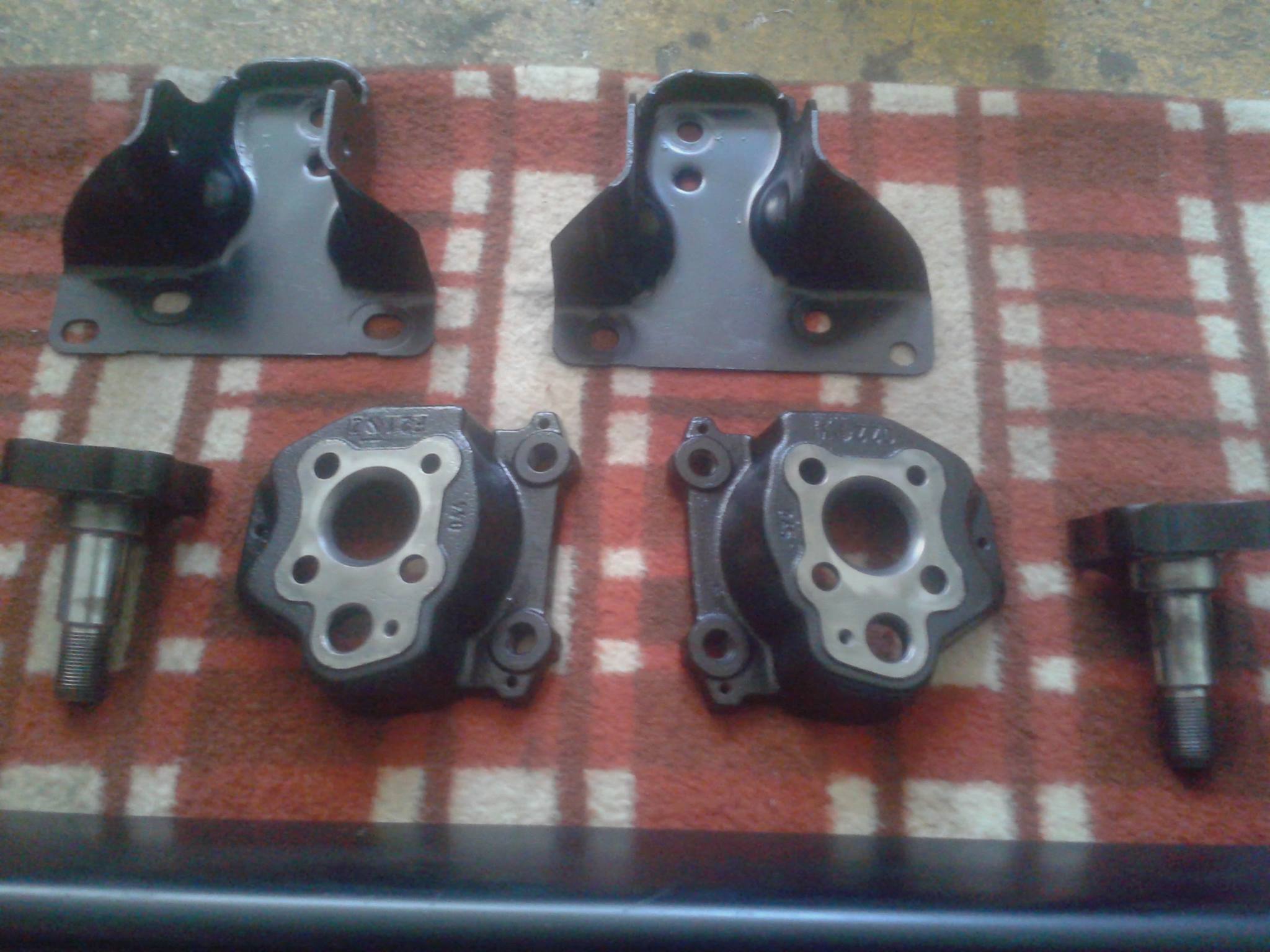

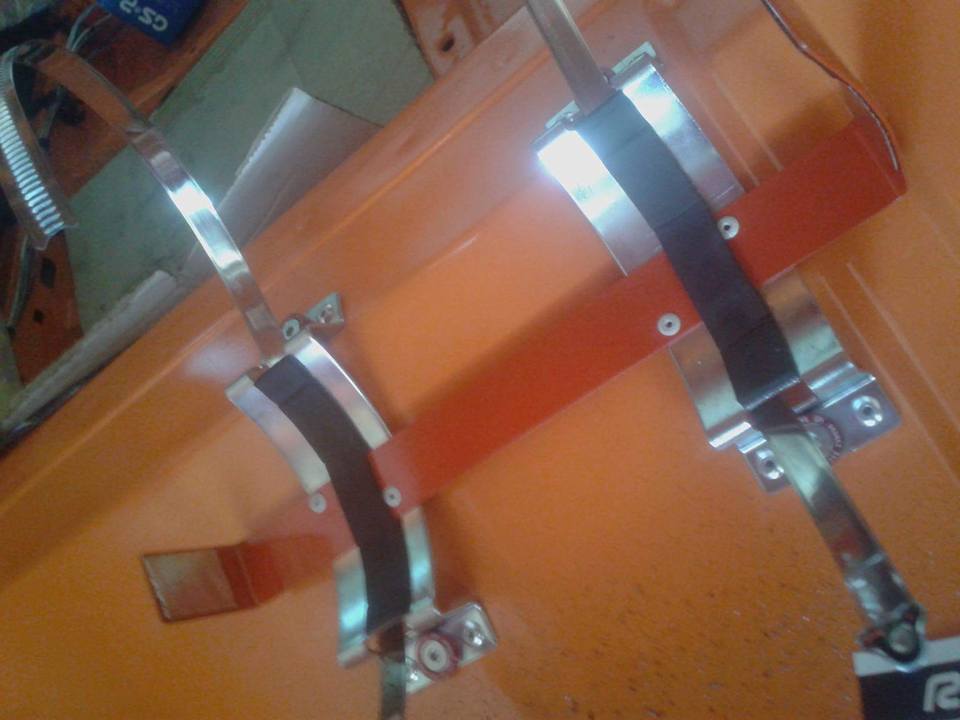

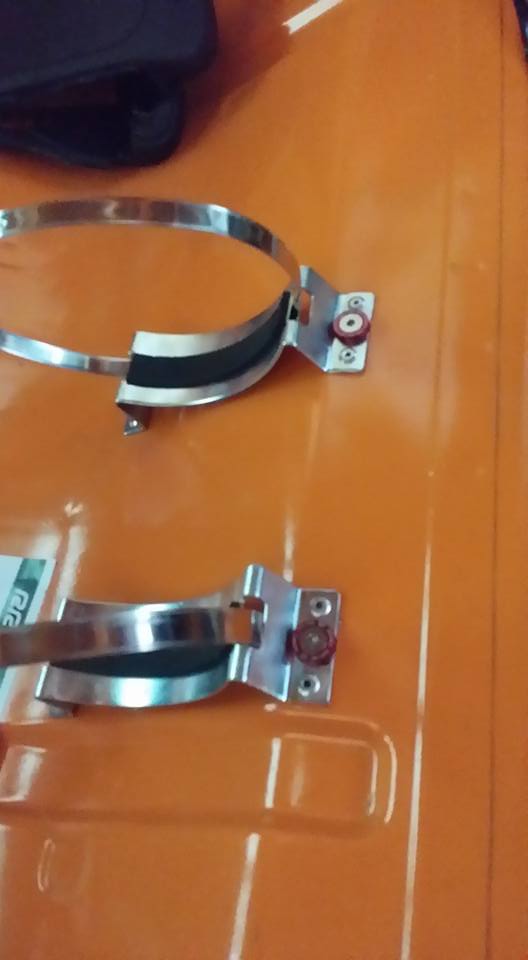

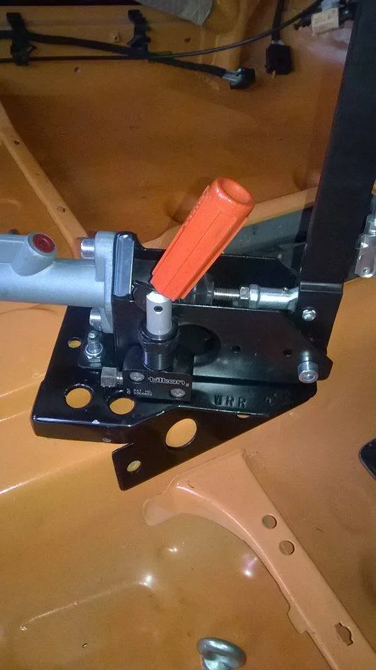

That's a beautiful build! Do you have any more pictures of the handbrake lever? Did you make the bracket that mounts to the tunnel?
  renault clio sport

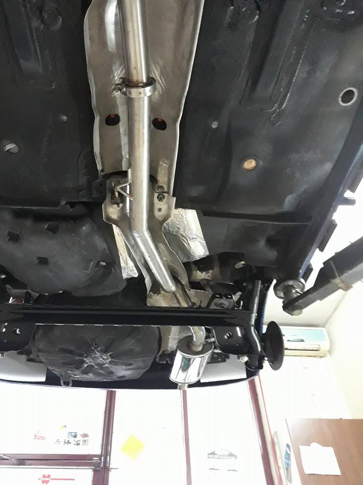

The rack is made so that it does not bother with the gear lever and the passenger seat, safi with 4 safes and one of them passes through the double sheet metal on the tunnel. This should make a 13 mm bimonthly. It would be good to mount the carrier before installing the exhaust system

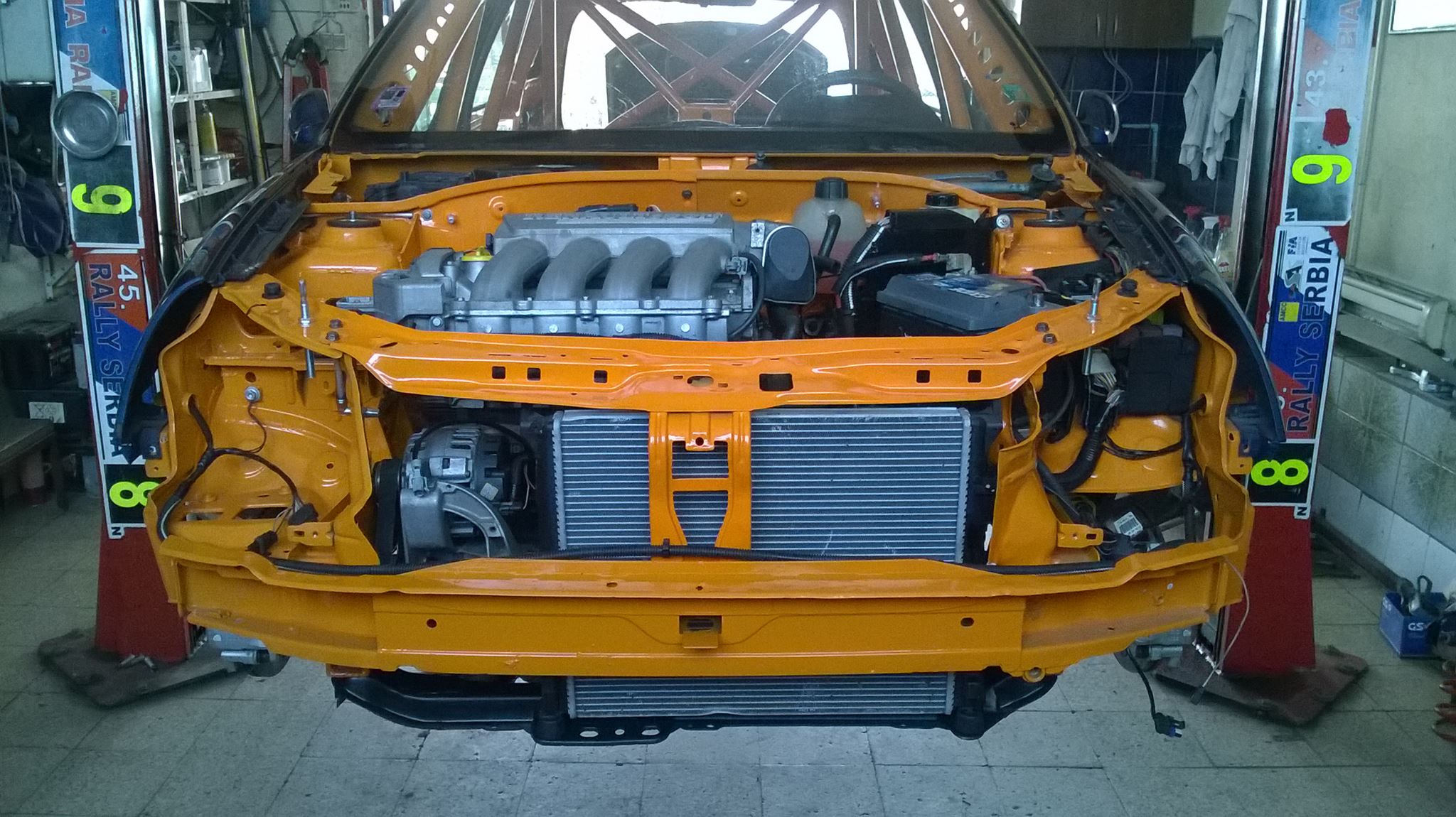

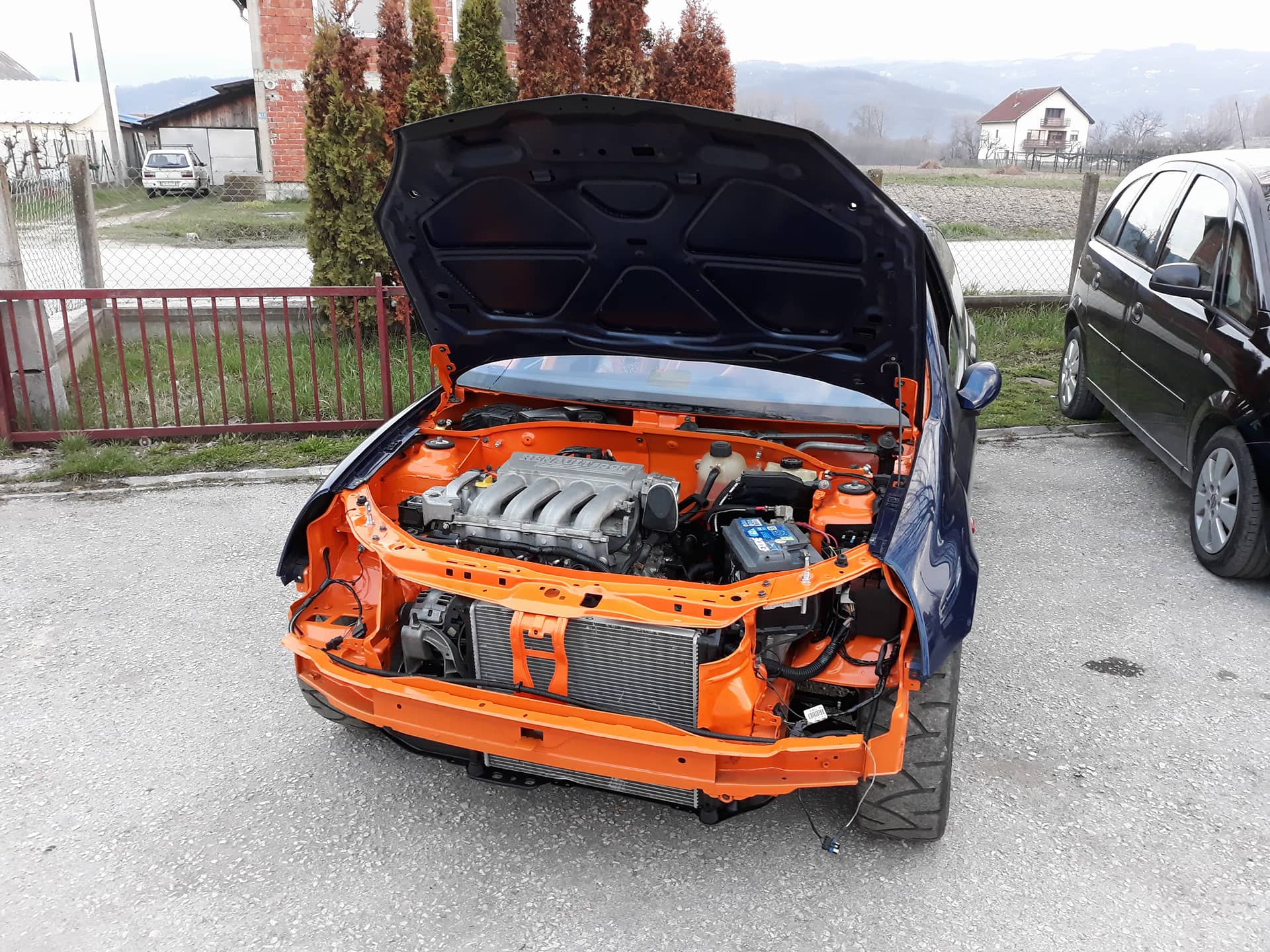

The car is currently branded and the first test is scheduled for 19.5 2018, in the meantime, we are adding another brand new
