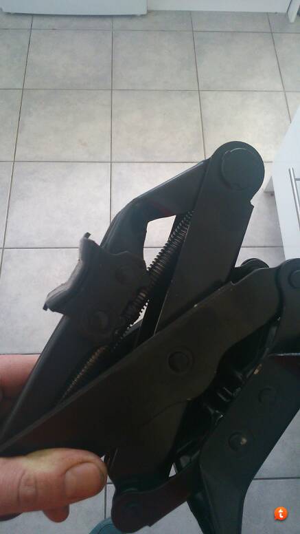

Car is standard. I put the Jack under the rear sill. Turned the handle, once I could feel the pressure and it went slack. Didn't even lift the car off the ground!
  PB172,dci100,dci65
Thats strange, rear is much lighter then front. Than it has ended its life cycle I guess :-/
  172
yep- first time i ever used it- must have been abused in the past- just like my car which I believe has had a rear axle because for it's troubles unfortunately they didn't replace the buckled alloy, just swapped it for the spare :(

My R26 jack has machined notches in the thread to prevent you lifting the car too high.
It only just lifts the wheels off the ground, and won't go high enough to fit axle stands under.
This makes my working on the car more dangerous, the opposite of what Renault intended.
