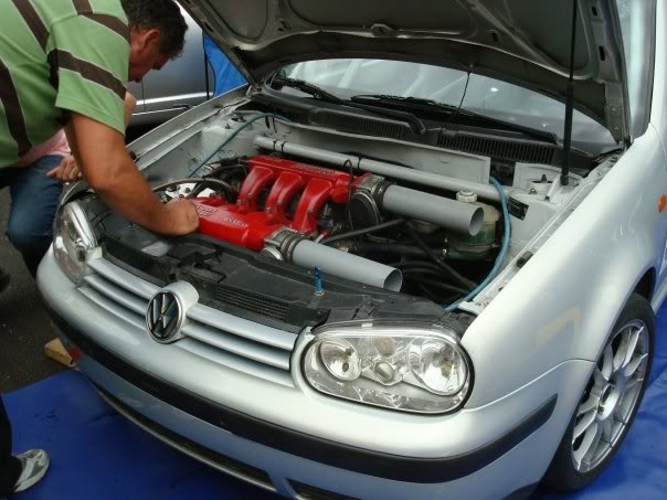

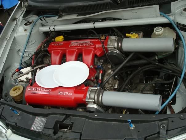

What Ali said, that's not a 'stock' engine out of a Clio V6 - the Clio V6 had a shared inlet plenum for all 6 cylinders IIRC.
Its a clio v6 Trophy engine. The engine is the "old" non vvt block/heads only played with slightly and fitted with a much better inlet plenumn. A fair few people say they are around 300bhp but 280/290 is more realistic. Myself and a friend are currently fitting the set up to our engines which both have vvt so it will be interesting to see what they make.
