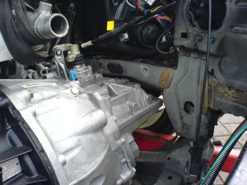

Hi Fred
What exactly is showned on this pic?
Is this a 225 gearbox in a 172 body or?
Did somebody did it so far and any feedbacks?
Cheers
  Lionel Richie
that's a vel satis (same thing) engine and a megane 225 box in a 1.2 shell
its my car, i gave up at the time (about 3 years ago now!) due to lack of funds and lack of machinery to do the work
  172 phII

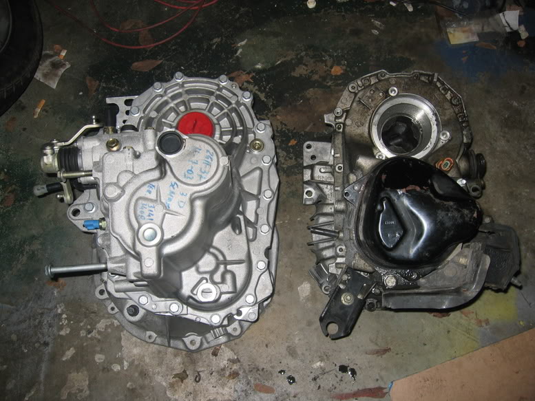

In your opinio what sort of work would include a swap of a 197 gerbox onto a F4R 732 in 172 body?
So far things I can come up with are :
gearbox itself is larger in size
there must be a some sort of a part manufactured to connect the 197 gearbox onto a 172 engine as AFAIK simple bolt on is not possible
gears are changed using cables and not a rod like in 1*2
Did I miss anything?
In your opinion would a 197 gearbox make a diference regarding performance if installed in a 1*2?
Cheers
  Lionel Richie
plus you will need custom engine mountings for the gearbox, plus custom driveshafts
its a LOT of work for an extra gear!
there is a speed conversion available for the JC5
  172 phII
it is not just the extra gear, it is the totally different gear rations that interests me. IMO 1*2 would go much better with 197 gearbox but I would like to calculate how much better so Ive posted this topic http://www.cliosport.net/forum/showthread.php?t=448763
but no reply still.
Could you please give some extra info on this speed conversion for JC5?
As far as fabricating certain parts I am lucky to be surrounded with people that can do those.
Thank you for your time

what about the engine mounts? are they all the same? if it was to be done, would the gearbox thing be the only problem or do you need any custom mounts? what about the wiring? is that all different? iv done a load of rover engine conversions which involved swapping the subframes and everything so im alright with a spanner :D!
  BMW M135i
Engine mounts are completely different within reason, gearbox just doesn't fit and engine management is completely different if keeping stock megane stuff.
