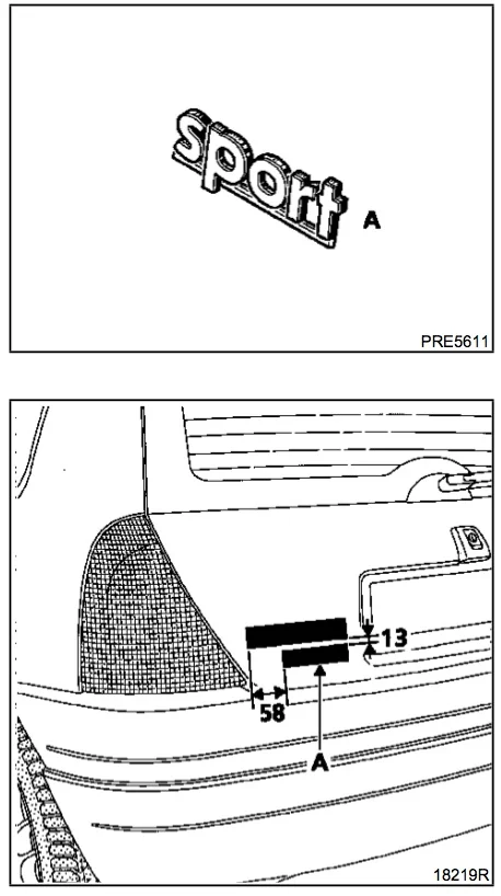

Here's the measurements so you can get it in the correct place hopefully
Cause the NEW style badge is smaller (assuming you're looking for New Style) just make sure you dry run its position on the boot to make sure your happy with it.
When fitted mine, I aligned the RENAULT bit half way up the registration plate so it was in line with CLIO on the other side looks the Mutts Nuts on black.
