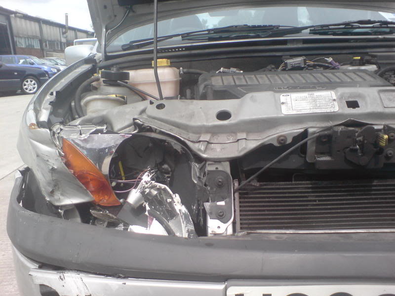

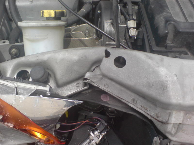

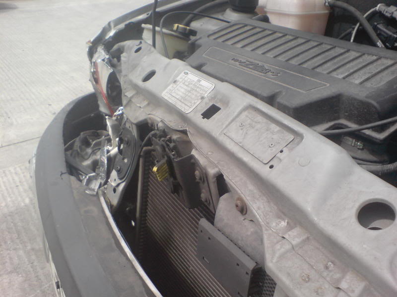

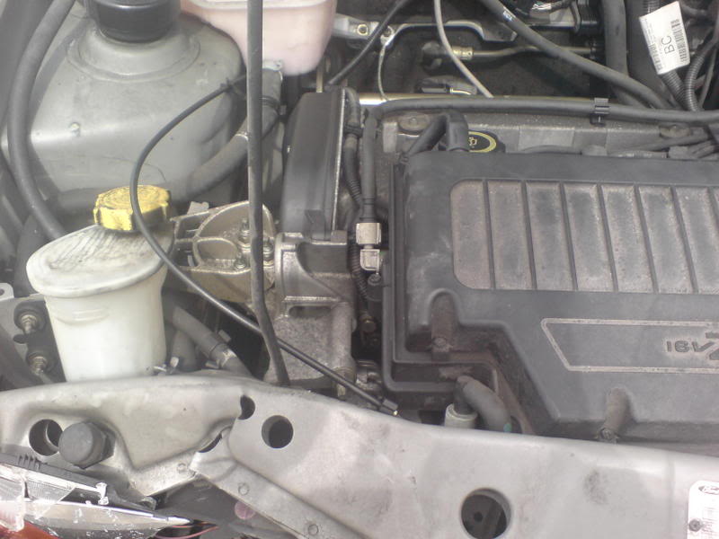

Does anyone know anything about repairing or replacing a bent slam panel. i have a some pictures if someone could help i would appreciate it. can this be repaired or does it need replacing and how much would something like this cost?
ur have to replace that mate along with the wing, and prob have the bumber replaced to and bonnet repaired but cant tell from pics how bad damage is, best bet is to take it to a few bodyshops and get some quotes if its ok to drive.
yeh the bumper bonet wing and hedlight all need replacing. its not my car im looking at buying it and want an idea on price before i decide to buy it or not.
hard to say, really depends on how well it pulls out.
what tools do you have, do you have a dozer or a 1/4 power?
ide repair it myself, but many people would be happy throwing a new one on
how much would a garage charge to replace it. i dont have any tools like that so could not do it myself.
thats what im saying, i got access to a 1/4 power so ide repair it.
it depends how well it pulled out for you whether its a repair/replace.
get a solid chain, wrap it round a tree and pull from it in reverse, keep the pressure on and it should pull out niceley with you persuading it with a hammer too.
as for replace, it aint a huge job, you could do it yourself, but im pretty confident that it will be spot welded and bolted on, so you'll need a welder.
strip down front panel, radiator out, lights out, bumper out
and price, i have no idea how much front panel would cost, but i reckon your looking at maybe £200 from a small garage. easy job for them
