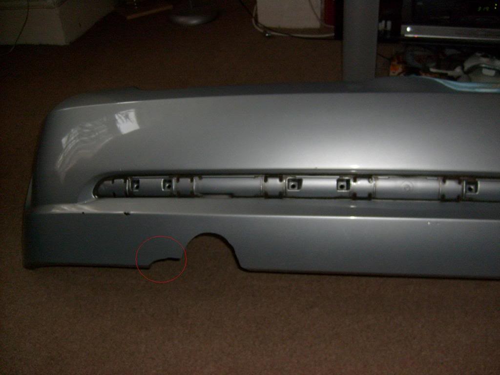

Baught a 172 bumper off someone off here a few months back and it has an exhaust cut out of it (Done with scissors by the look of it). Is there any chance i could smooth the exhaust cut out over? How do i go about doing it? I have a mate that is good at body repair, i'm going to do it with his assistance. Thanks.
  BMW E92/Audi S3
I want the red circled bit gone :) I dont mind the exhaust cut out as a whole its just he's cut an extra bit for some reason? :S

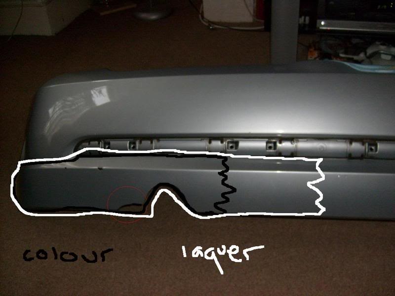

colour (silver) to just past the bumper recess and just fade it out
then laquer to the white line and fade it out, let it dry n give it a polish by hand
  BMW E92/Audi S3
yea, easy job.
You helpful motherfucker :approve: thanks lots mate!

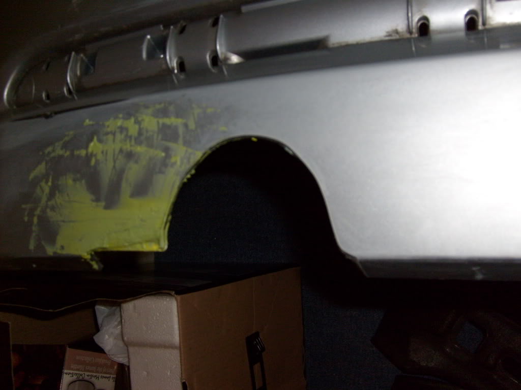

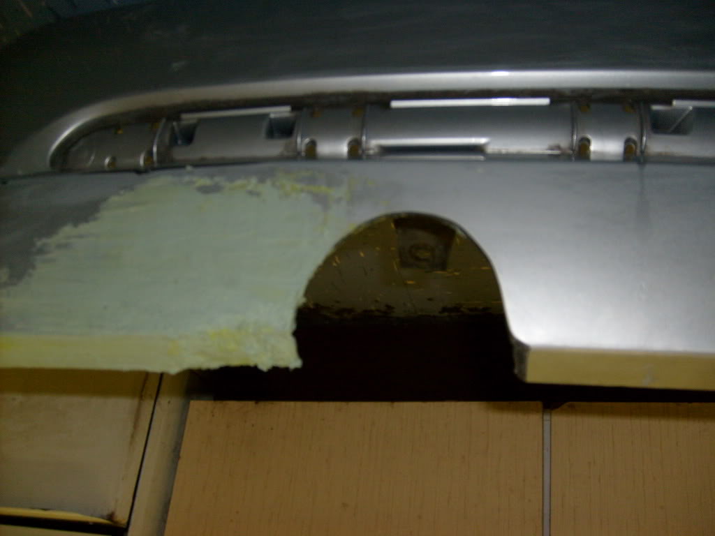

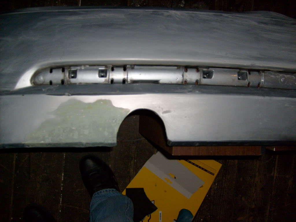

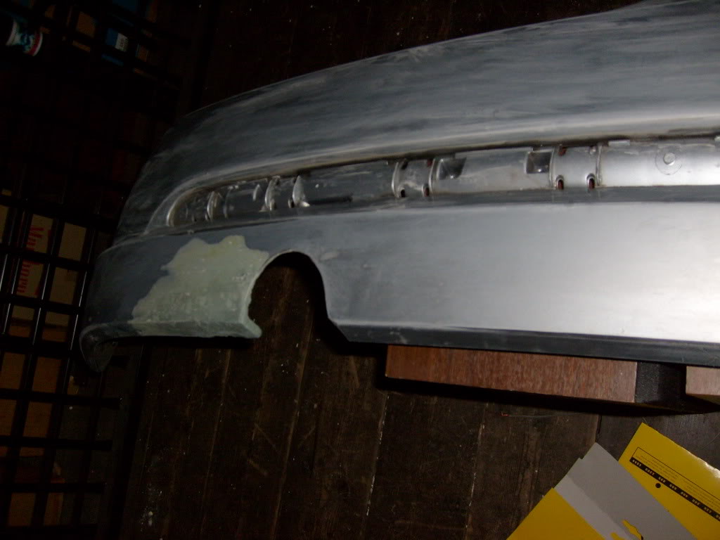

So far ive
-Glued a card to the inside of the bumper to use as support for the filler
-Smoothed the "scissor made" Exhaust cut

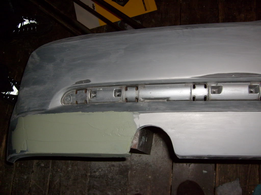

-First layer of filler
I want to put a 182 surround on it :)
  BMW E92/Audi S3
have you scuffed the credit card youve used before fillering?
yeah.. to f**k lol
Just the first layer. Obviously i have to do underneath aswel.
Obviously im going to wait for it to dry and then more layers and smoothage will take place :)

FM - sorry to go a bit off topic but that method you have given for repairs on the silver bumper would that be the same as doing a repair on solid white ?
and also, repairs like that i take it everywhere up to where you have faded the laquer in to would need to be scuffed up with a scotch pad or something - i take it if you scuff to much up you just polish it?
  Punto/Clio GTT
yea, scuff further than you need to with a grey scotchbrite or wetflat with something like P1500/P2000 then polish it back to your laquer and itll blend in nicely
yea, same method for all colours

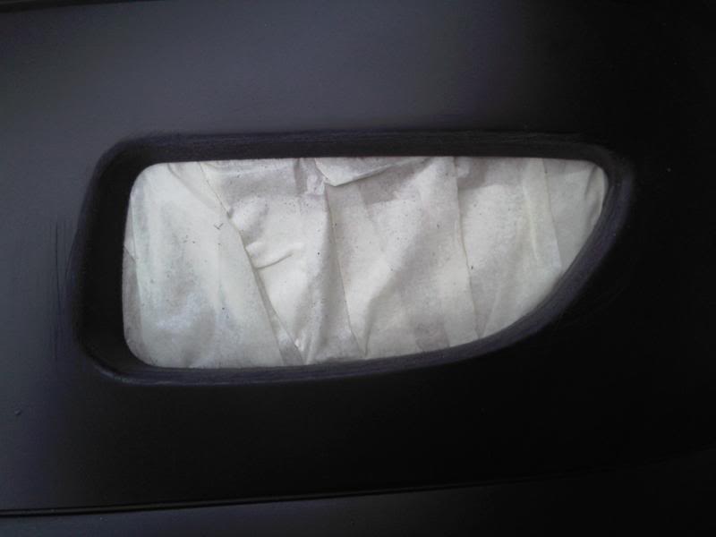

Very helpful bud :) im going to smooth one of my fogs off when i get my sport front bumper. Only smoothing the one because the other is going to be used for the cold air feed.

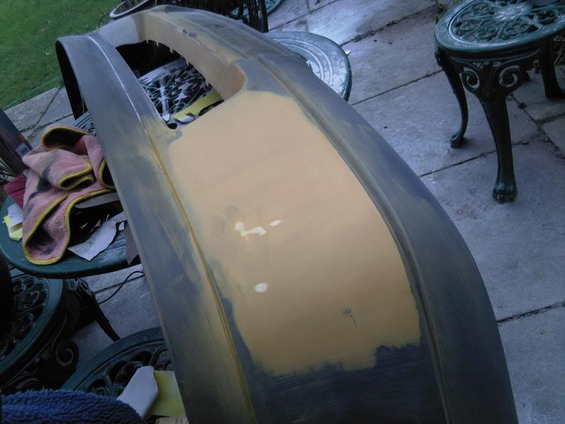

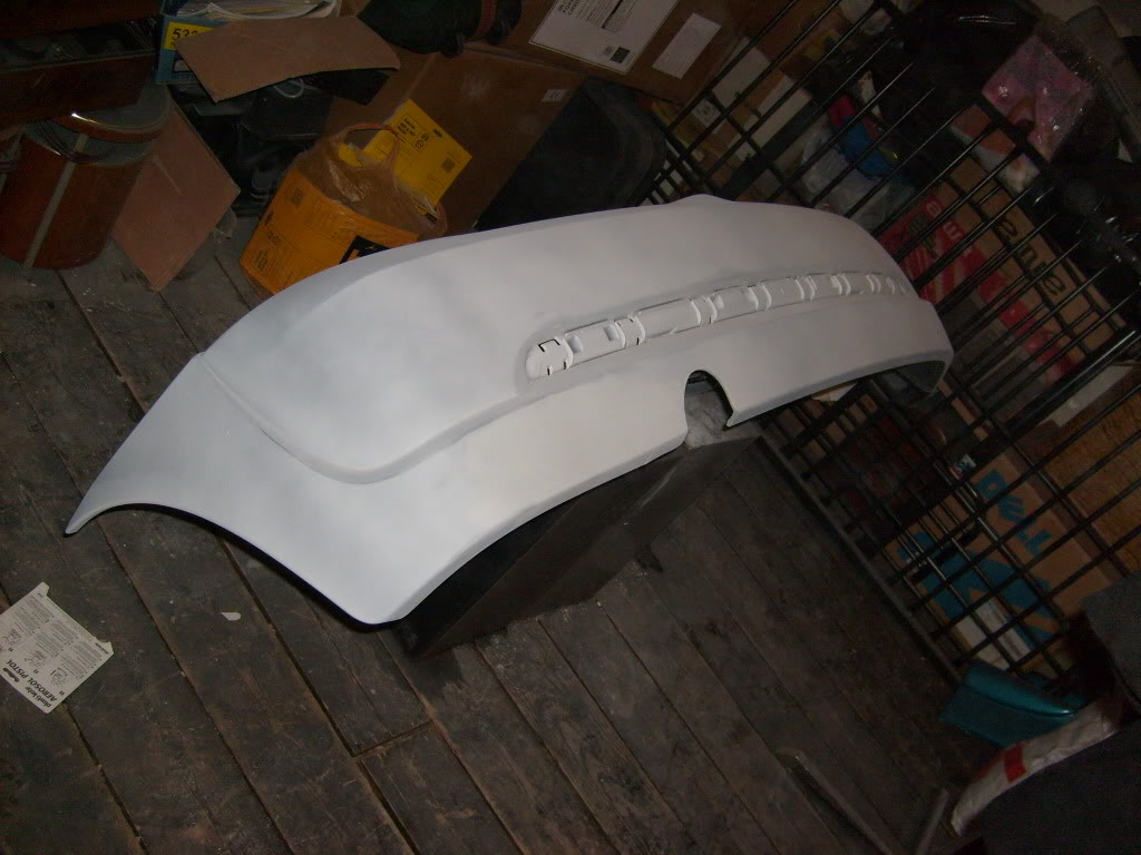

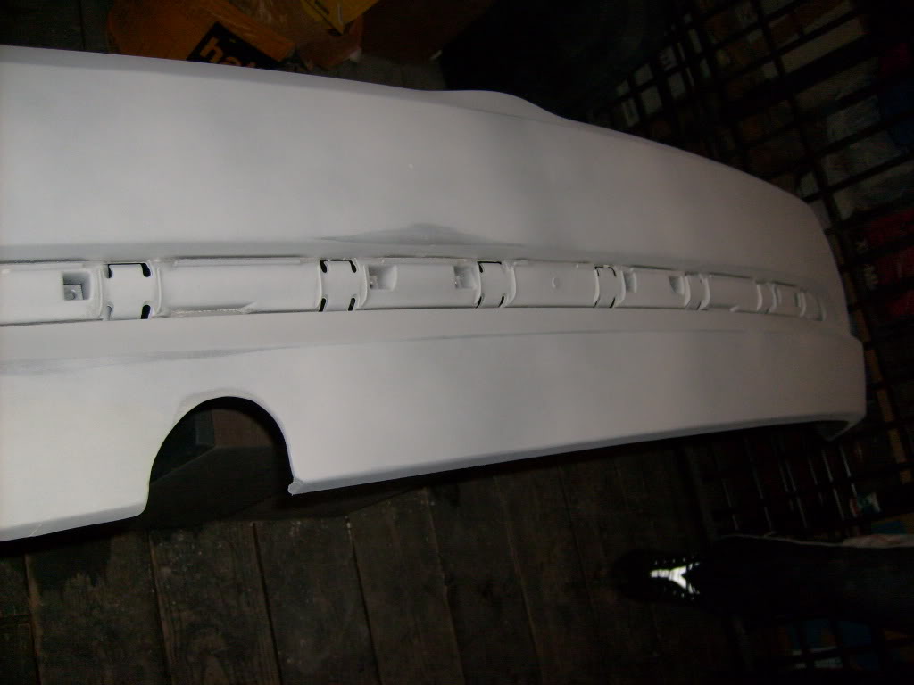

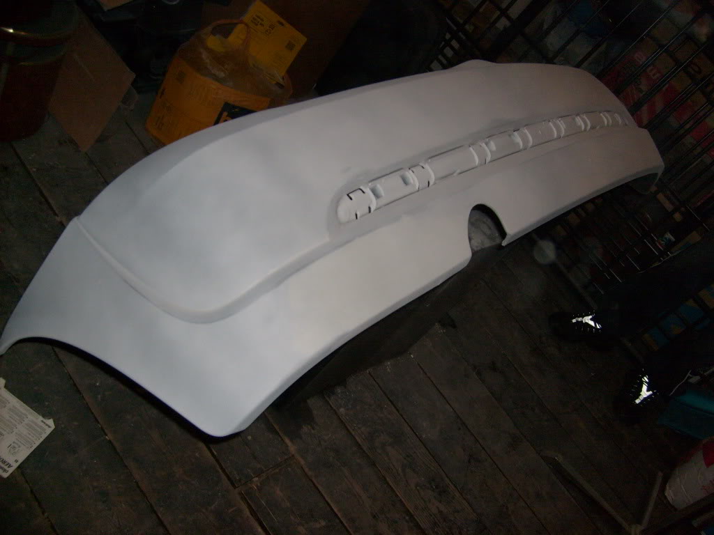

**Updated**
Final Layer of filler put on today, some smoothing done and bumper scuffed to bits, then first layer of primer was put on and then prep'd again..
Another coat of primer will go on tomorrow, then more prepping and then paint is going underway next week :)
