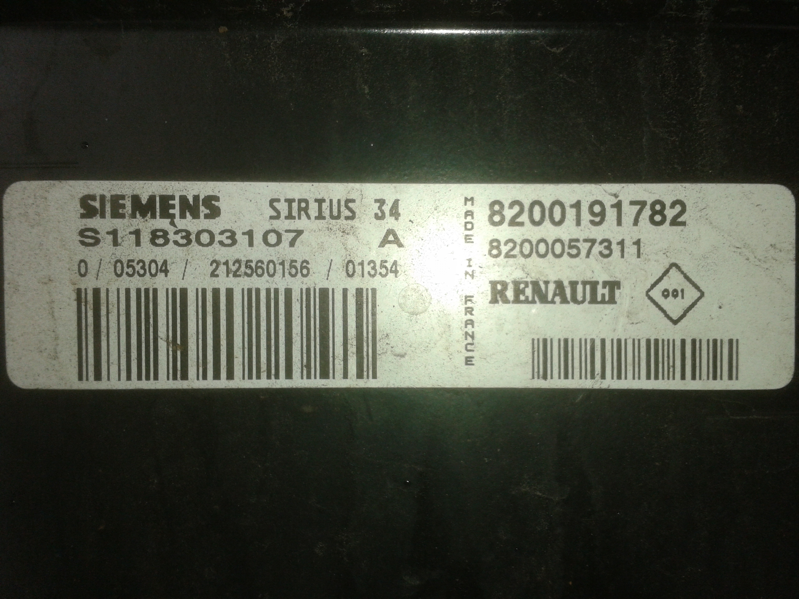

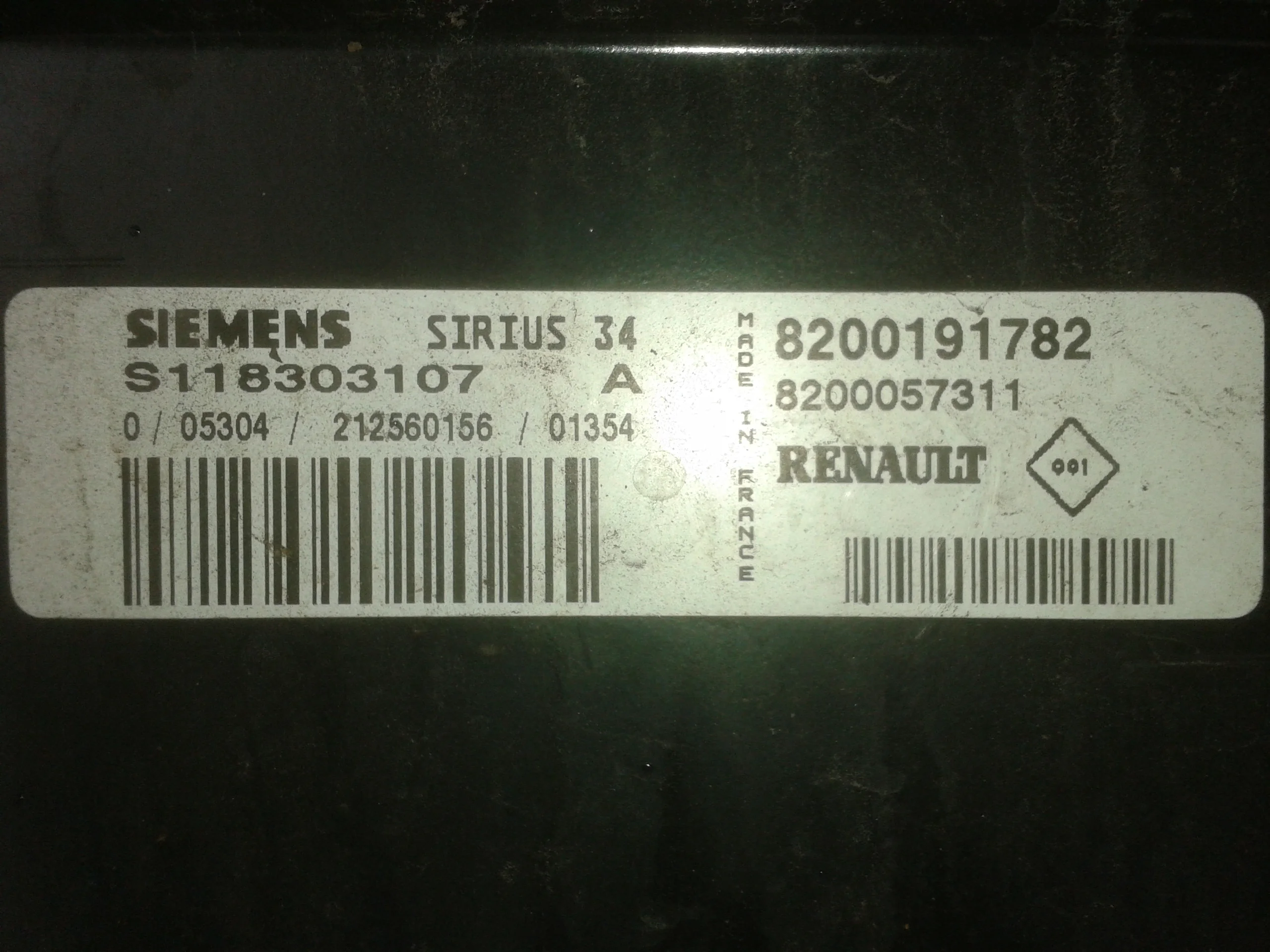

All PH2 172 & 182`s have the Sirius 34 ECU.
The fact the car runs means that the UCH & ECU are communicating.
Later UCH can be reprogrammed with CLIP to cover functions of the earlier type.
Your throttle body circuit problemwill be poor connection/loom corrosion, take it to Rentech in Portsmouth to get it sorted.

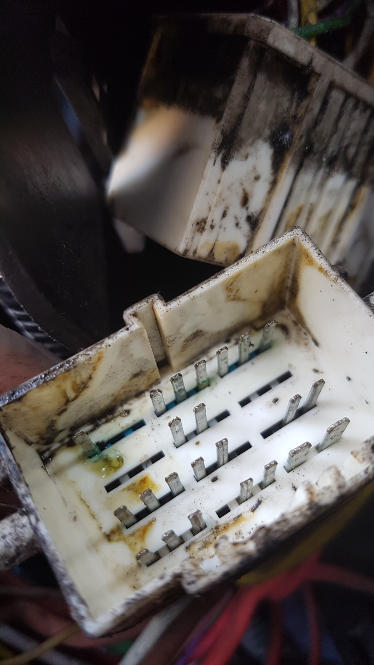

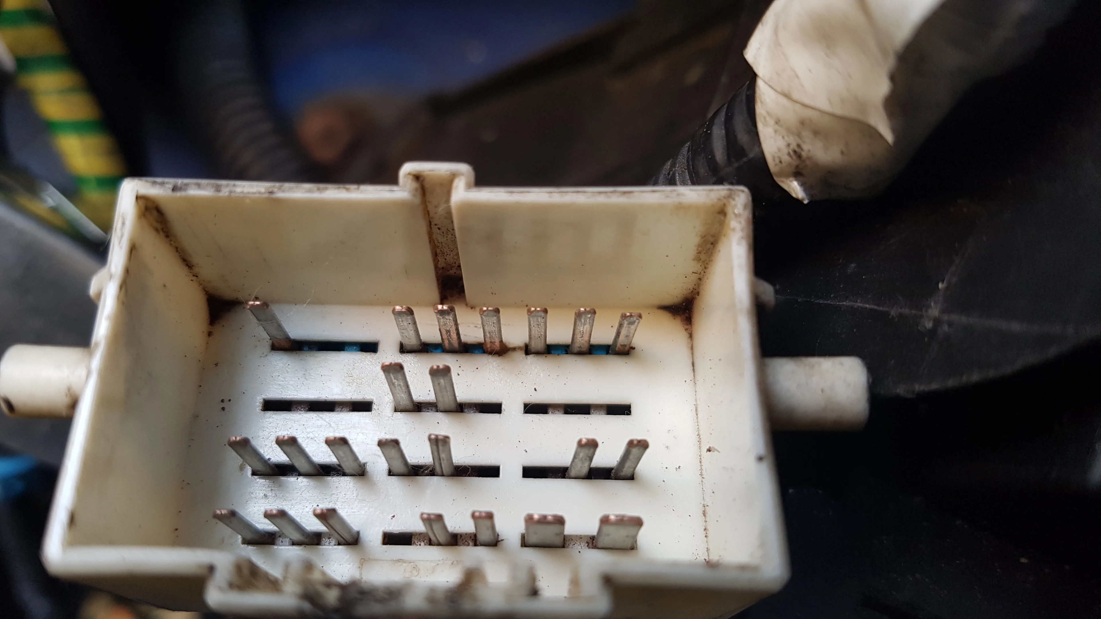

so managed to spend some time on the clio tonight
I had a look at the UCH and couldn't see any obvious issues, no water ingress, burns etc - of course you cant always see issues with this sort of thing
checked the contacts on the Tb itself and they were very very clean, still shiny and like new
then moved onto the white loom plug - pics attached
yes it was dirty before hand but only 2 of the pins actually had visual rust/oxidization, the pins looked generally quite clean
i gave it all a clean and chucked it back together with a tiny bit of Vaseline on the pins
chucked it all back together and its still dropping into limp mode

  Renault clio

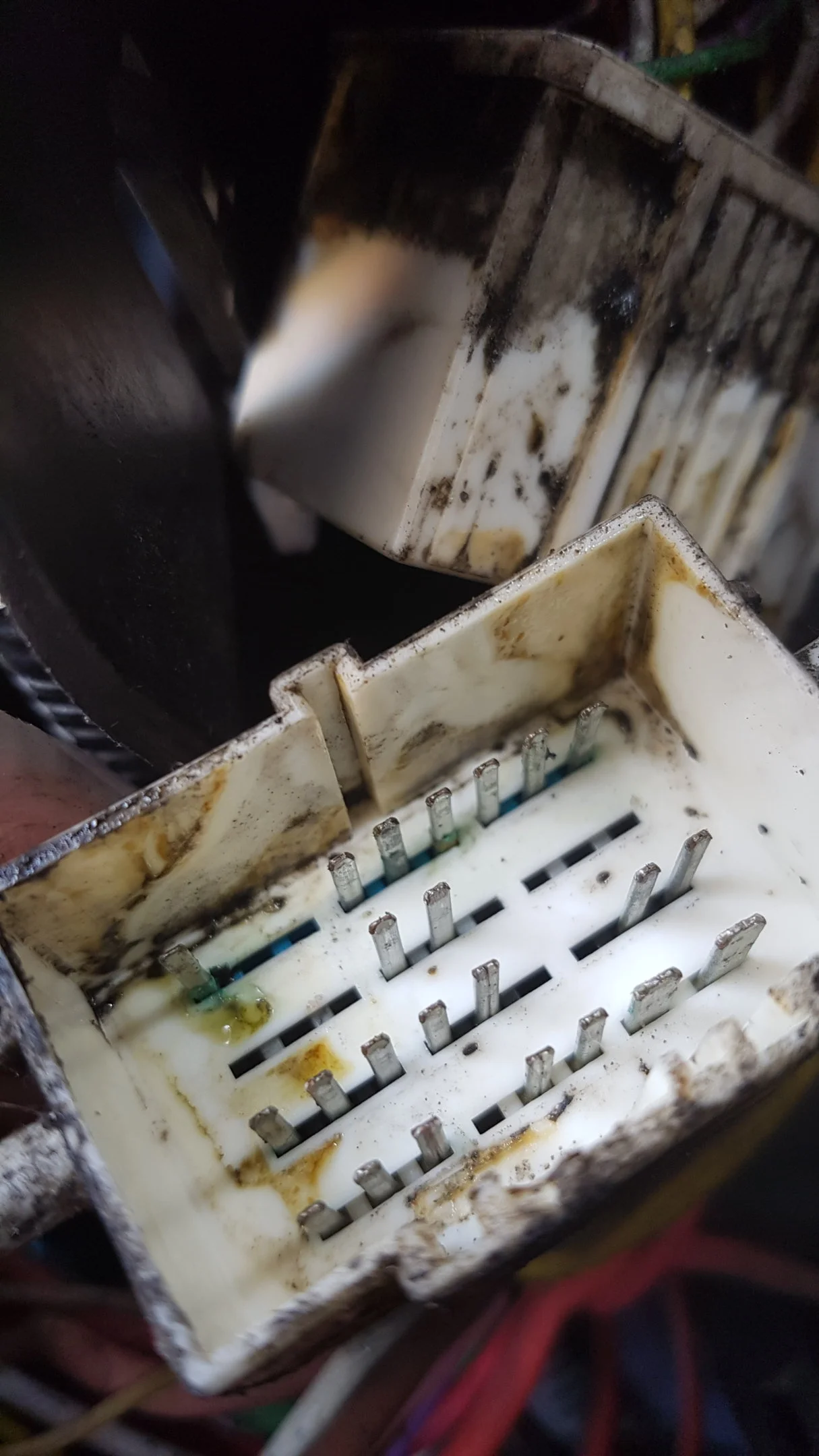

something i have noticed is that it drops into limp mode at 3k and once the car is warm, oil temps at 85+ degrees

Any ideas on my next step steve? Searching threads like nobodys business here and struggling to find ideas. Atm im thinking of hooking the pedal off and seeing if theres anything suspicious there - i know i wont find anything though!...
  PH2 172
One day!
I`m not sure, other than to say go back and look again.

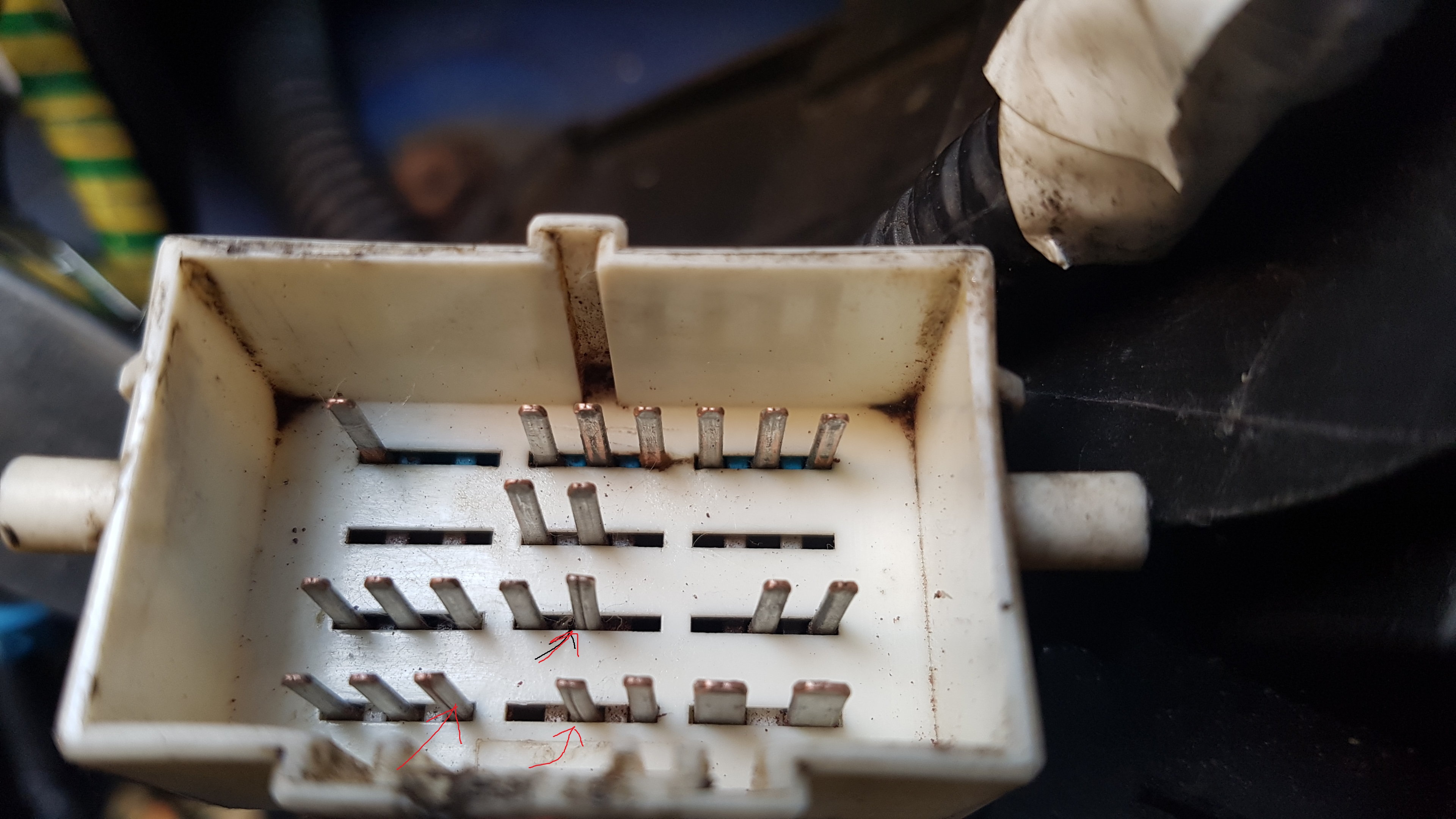

It will not be the pins where you split the plug, but where the pins are soldered to the loom.
I have arrowed 3 pins that look bent and have possibly been pulled from the plug and replaced at 180 degrees to the rest.
Closer inspection required? And their matching females.
