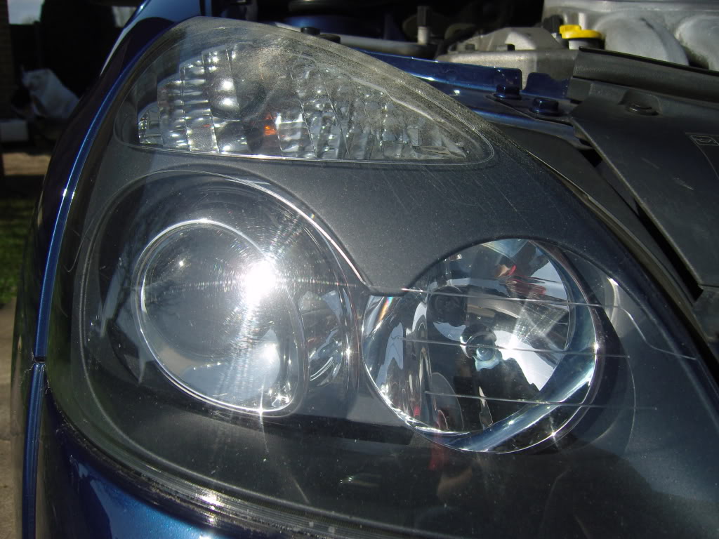

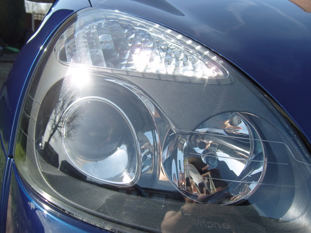

As in scratched / Cloudy? If so dont buy a new lamp (Expensive!) Just wet and dry sand the light and then give it a good polish!
From -
To This -
(Pics taken from m4rkie23 thread here - http://www.cliosport.net/forum/showthread.php?496334-Headlight-correction&highlight=headlight)
