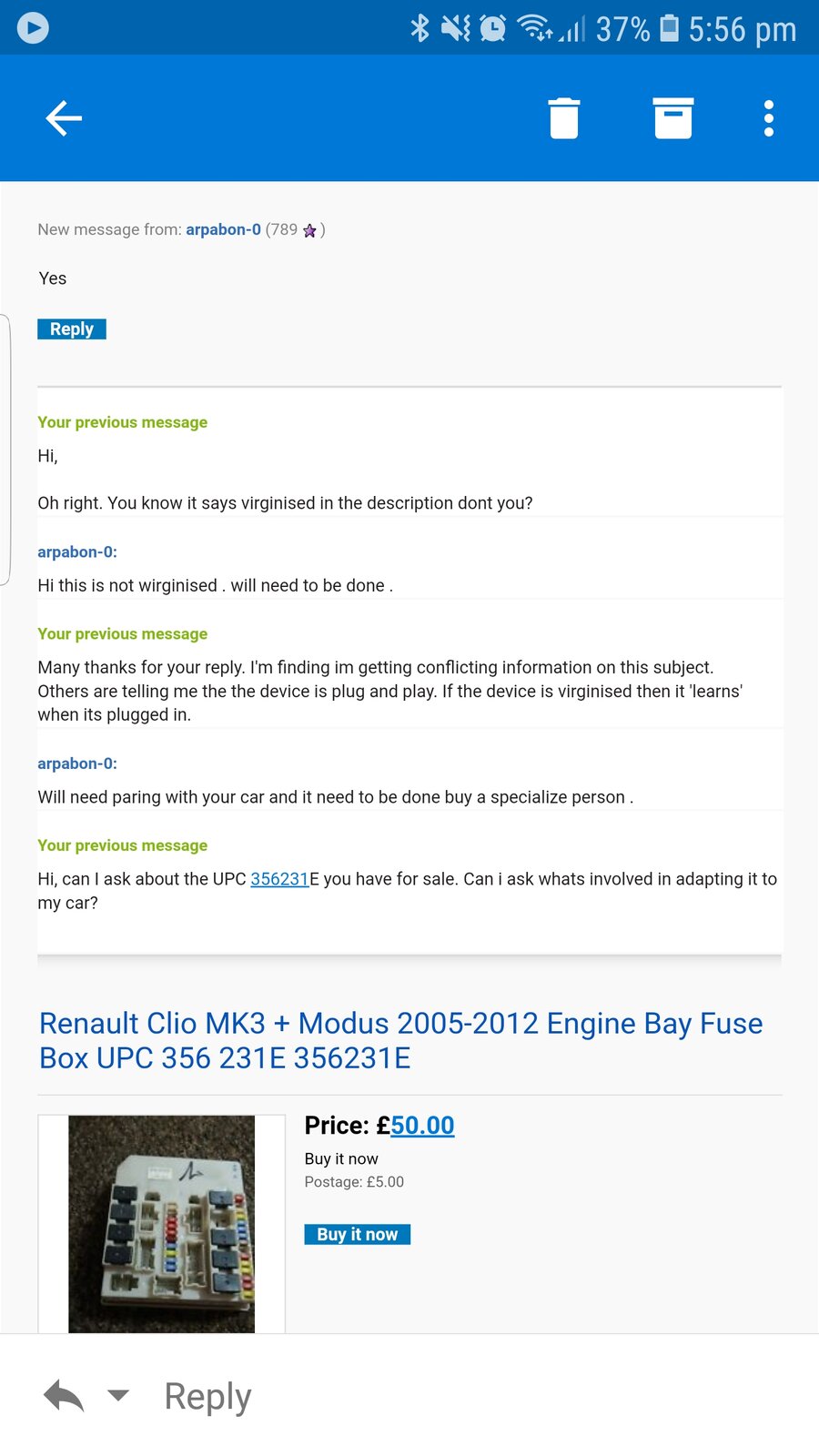

I'm really hoping for a definitive answer for if it is possible to simply swap out the engine bay fuse/relay/UPC on a Clio 3 without having to get it reprogrammed.
I see lots of them for sale on eBay, some specify that they are 'virginised' others mention that the type of ignition system matters (card vs key etc).
Mines a manual 1.5DCI with a key (Not card). 356231E

No programming needed. Changed mine last year. Its a straight swap just make sure it is the correct one. The one from renault parts direct fitted my 1.5 dci 2006 if that helps

Chatting rubbish mate. It's literally just a box of fuses and relays. I've had one apart before and theres nothing in there to program to your car. Just ebay clio engine fuse box. Forget the UPC thing. Theres one from a proper breakers yard on there I would go for. Just double check the picture matches your old one.

jist wanted to update this thread for others looking to find out the answer and to say thanks for the advice from rbeazer and Brigsy.
This absolutely is plug and play. I matched the code in my original thread with a second hand one purchased for £50 from a breakers.
To fit its just a case of removing the battery, battery housing (unclip the battery fuse unit from the housing first); Then its two size 10 nuts and the units out.
All working as expected with zero issues. I now have 12V going to each headlamp and can hear my relays clicking on the fogs and the dipped beam.
