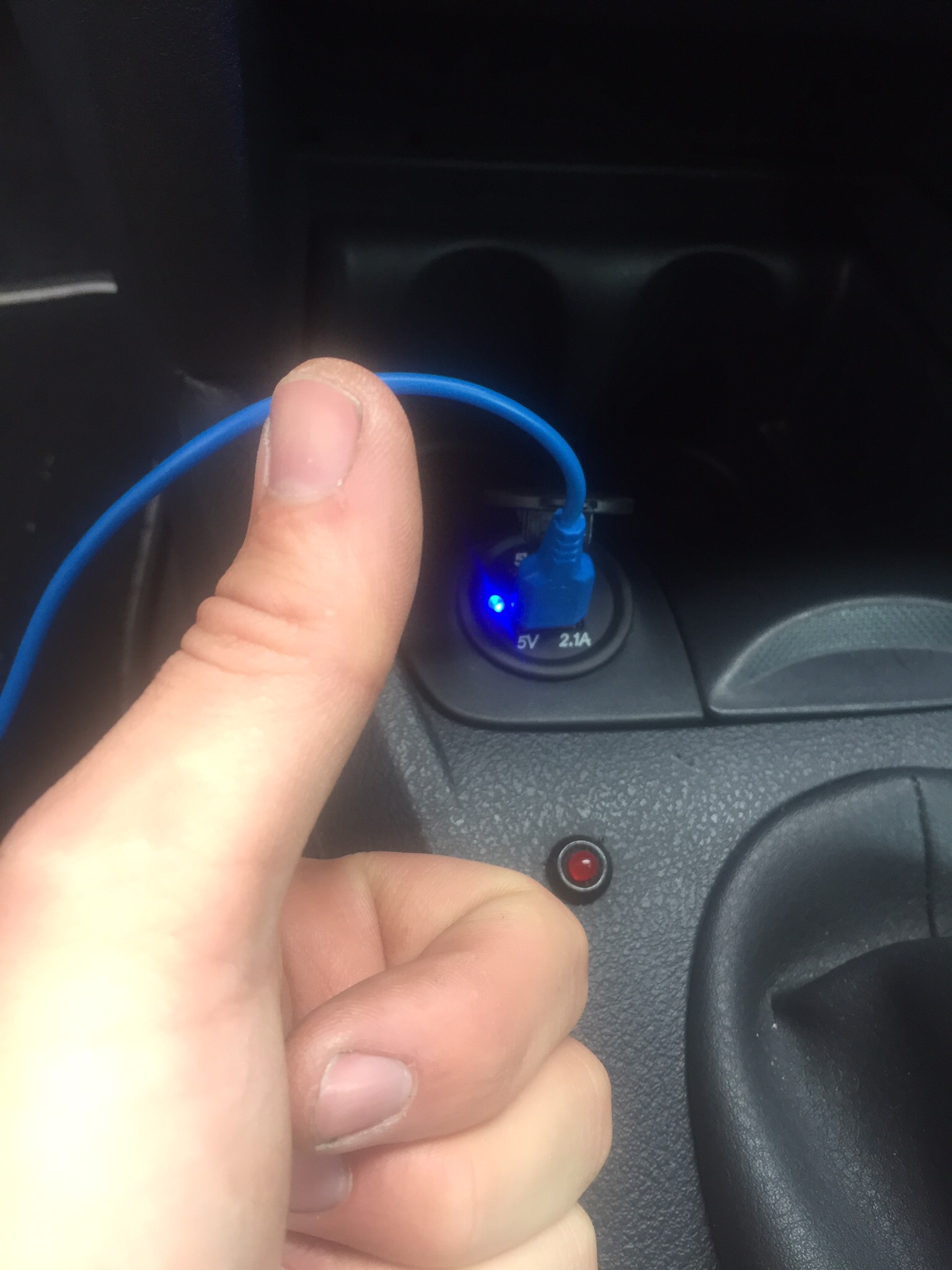

you can pull the whole section out with the cup holders etc, pull the ashtray out first then use that hole to grip and pull the rest out (it's just clipped in, no adhesive or screws). I took mine out, disconnected the cigarette lighter wiring then removed the actual cigarette lighter from its housing. I then fitted USB ports and wired them up to the original cigarette lighter wiring. I don't have a guide or anything but theres a picture of it finished and a link to the usb ports here http://www.cliosport.net/threads/replacing-cigarette-lighter-with-usb.809992/
I can possibly write it in more detail if required but I found it quite easy and I have no mechanical or electrical background, just some basic knowledge.
