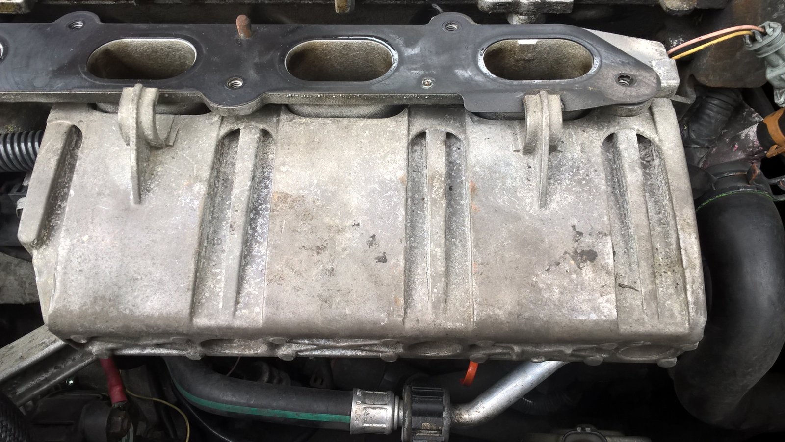

The problem is I cant get the injector cover off because one of the bolt heads has rounded! Anyone got a suggestion?

Have you got 10mm or 13mm bolts on your fuel rail guard? I very much doubt you would those removal sets to fit, although they are brilliant!
You need to try hammering on a socket that's a size down / slightly smaller imperial size.
  330i. E30 Touring.
Well placed grinder blade through the fuel rail guard.
Just be careful of the rail, for obvious reasons.
  Clio 182 cup
I will have a go at the smaller socket. Don't want to risk one of my nice ones though. Maybe I could get an imperial size that's slightly smaller.
I did think about just cutting it. It's only the right hand one that's stuck. Trouble is since I haven't take it off I don't know where the fuel rail is to be careful of it, if you know what I mean.
I'd be more inclined to cut it a little then use a massive hammer to split it.
It's only alloy, so better to split it rather than cut it to bits and end up chopping into the fuel rail potentially ending in fire

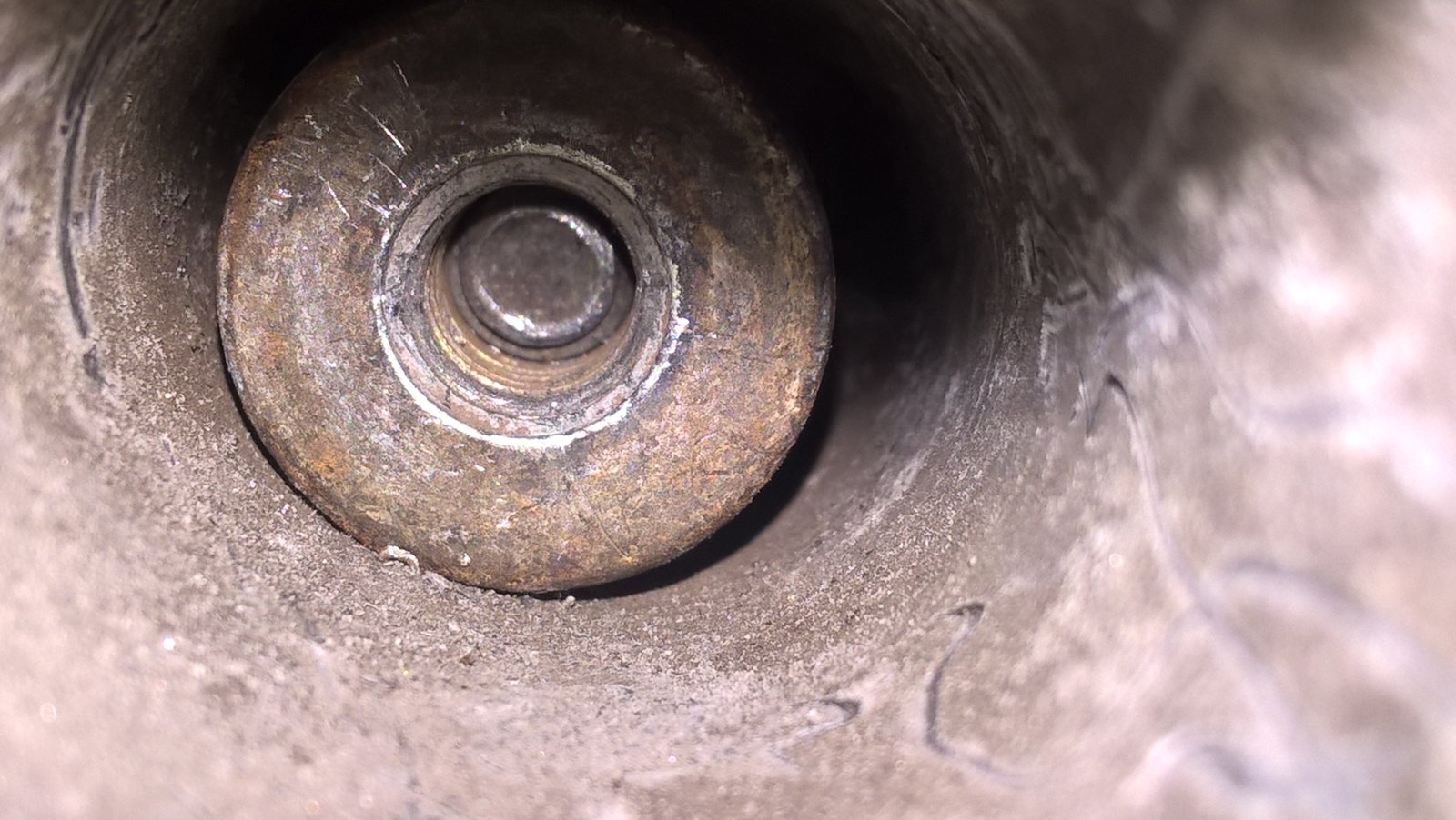

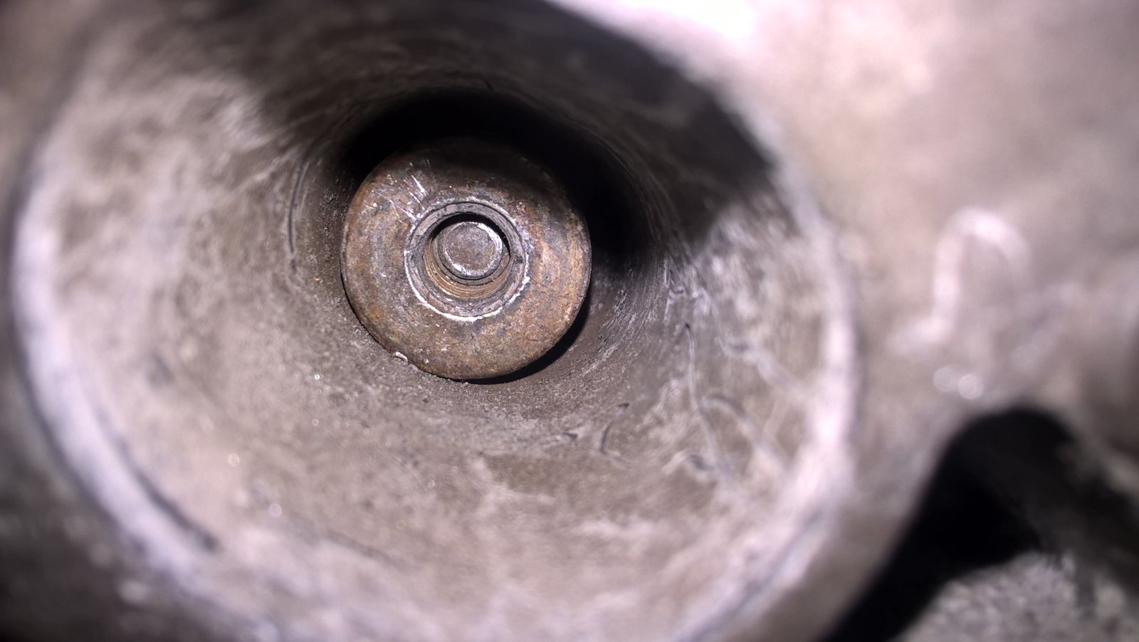

Yesterday I undid the left hand bolt and tried again to untighten the right hand bolt. It is indeed 10mm; I can feel it catch and then slip. I had no luck getting a smaller socket on either.
I tried smacking the guard with a hammer and surprisingly got no where apart from causing a crack in the casing. I stopped when I got a whiff of petrol that worried me.

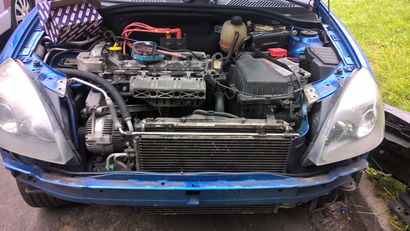

I decided I probably needed better access which requires taking the bumper off. Remembering what a PITA that can be, and being reasonably hungover I gave up for the day!

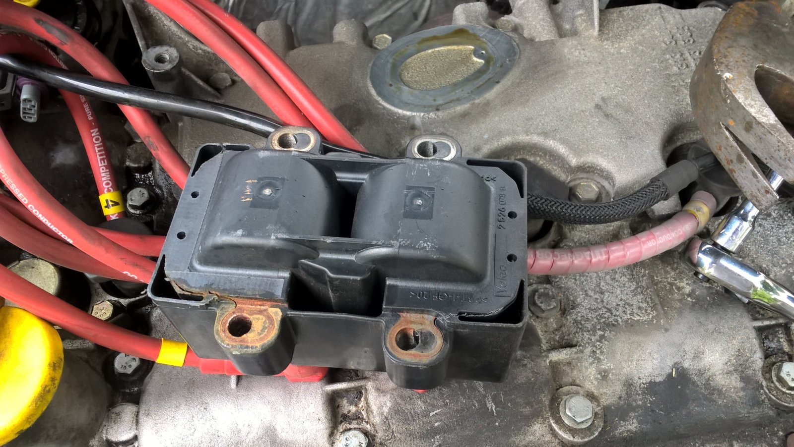

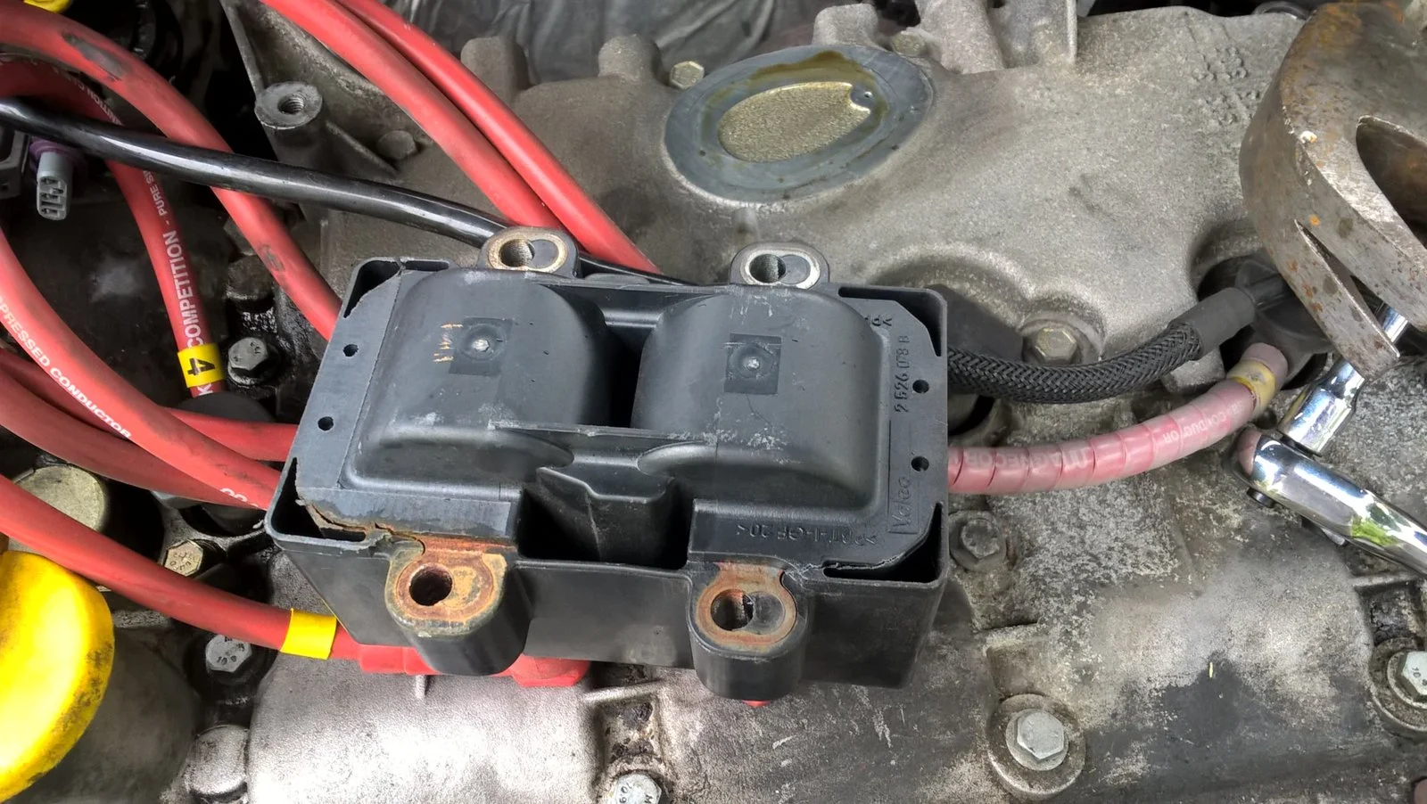

Having taken the coilpack off the upper intake plenum I spotted a crack in it and some corrosion, so will also try replacing this too.
So today I've got the bumber and crossmember off, then jumped on my bicycle and when to the local motor factors who luckily had the correct coil pack - discounted too because one the the bolt holes has cracked. I also went to Screwfix and got a bolt extractor set, as JB21 suggested.

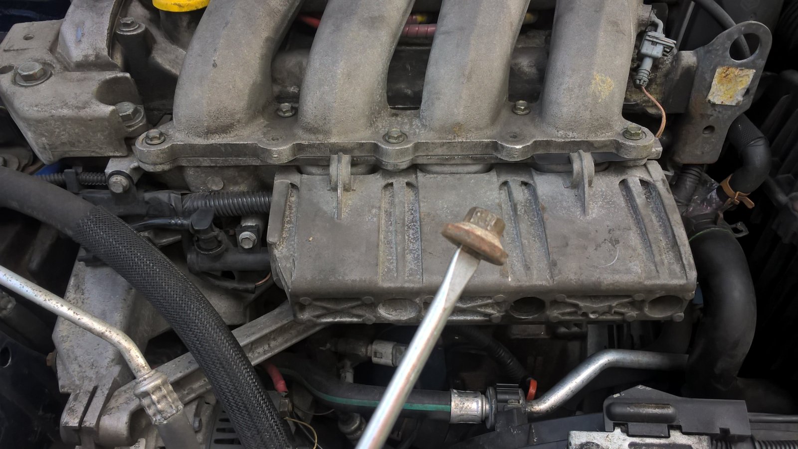

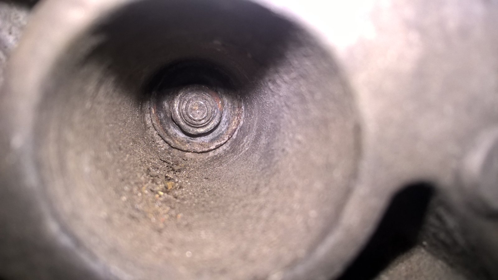

Not going well. The bolt removing isn't biting, pretty sure I need an impact driver for it. Yes I've tried a 6 sided socket.

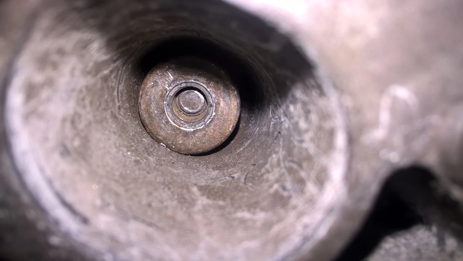

Worse though is the left bolt. Where I thought I had removed the bolt and dropped it, I can now see that there's a socket stuck on it! As it's not mine it must have been from a previous attempt.

  Clio 182 cup
Damn. I did wonder.
I'm going to try changing the coilpack for now and reassembling the air intake. With any luck that'll fix the misfire and I won't have to do the injector.

Just tap a larger size socket on it and it'll come off no problem, its only on by a thread, 2 minute job lol
Poopensharten
  Golf R

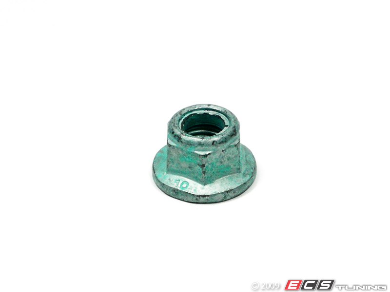

How will that work? From what i'm reading its on the wrong way and its a shouldered nut thats on it?

Coil pack hasn't fixed it so I've got to get at that injector.

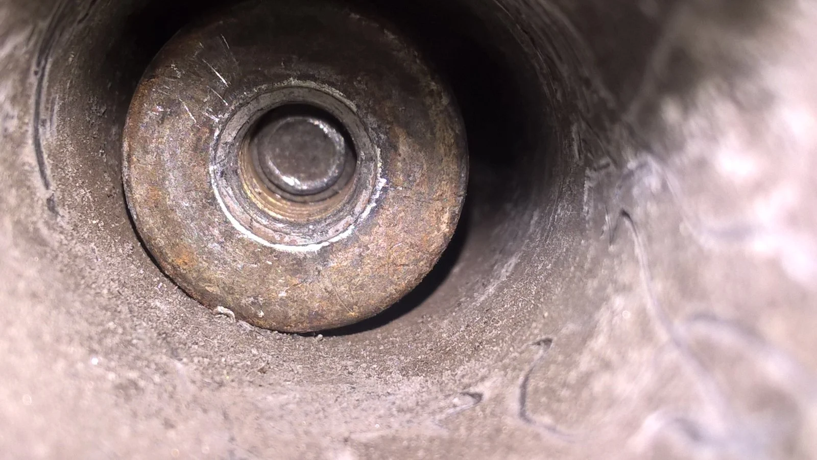

This is the culprit. Good guess on the shouldered nut. In fact it's an integrated washer, no idea how they got it on!
Well if you can direct me where is safe to cut that would be useful. Its my last resort now.

When I had mine, some bright spark managed to put that shouldered nut on back to front, fortunately it wasn't on tight so I used blue tac on the end of a socket to get it off.

The black tube looking thing to the left of the rail guard is your fuel rail, so just try to stay away from that. Cut half way into the fuel rail guard, then hammer it and surely it should just snap?
