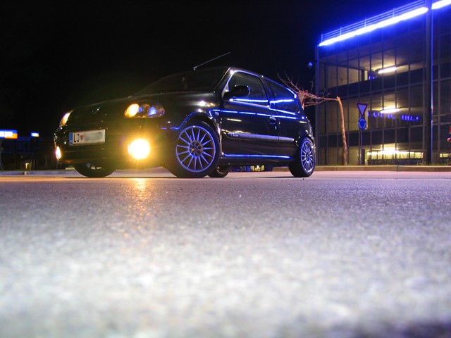

this is one members clio. duno if this helps :)
euro isnt supposed to fit under the arches. The wheels are supposed to stand out past the body of the car, with a possible lip of the arch

those wheels are modern lines by schmit 8x15 by the look of it!!!
taylor you will not need to roll the arces just cut the lip off the back ones and you will be fine with -60 springs , you may want to uprate the rear shocks so its a little stiffer so the tyres dont catch over bumps on the motorway...........thats all i did anyway ;-)
