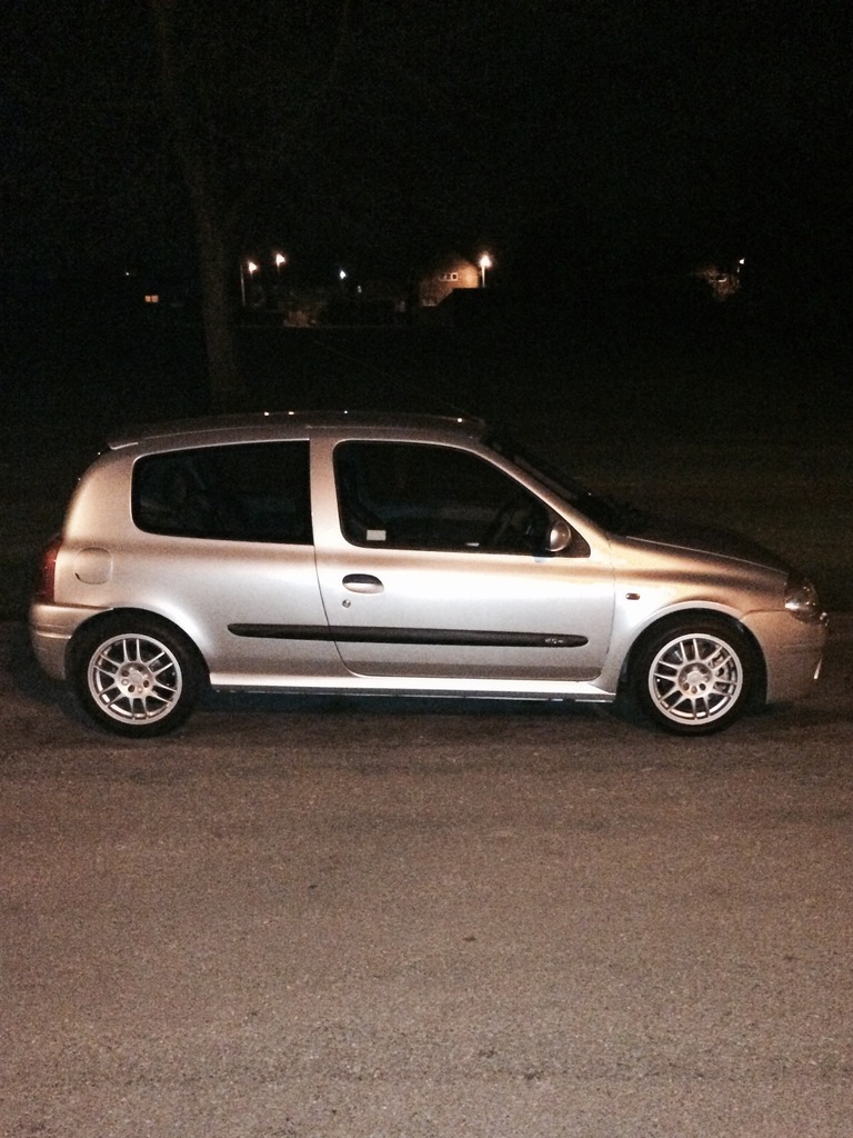

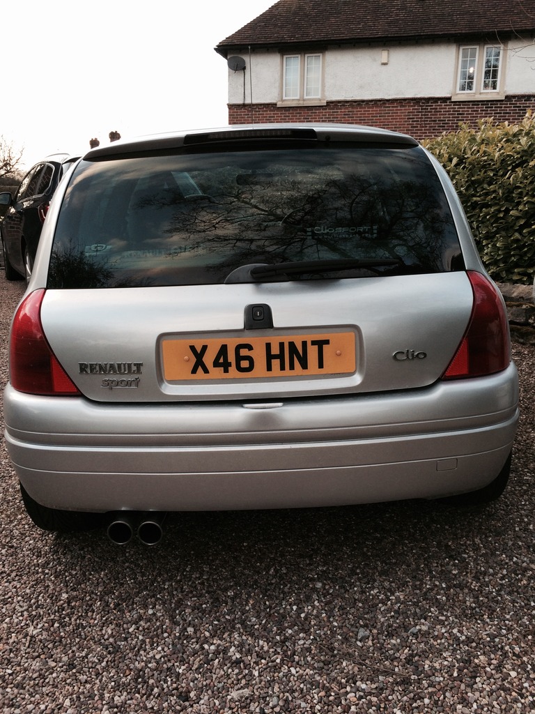

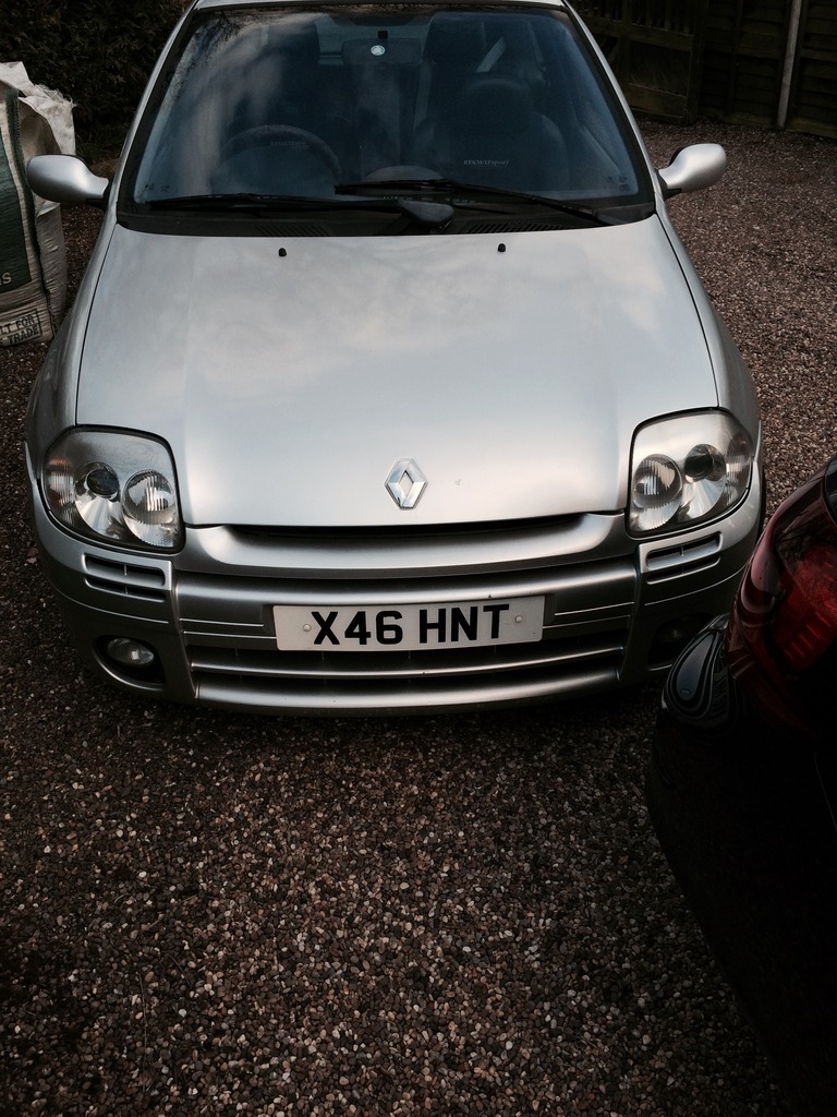

After 2 years of looking at my phase 1 sitting on the drive I thought it was about time to get it sorted and back on the road.
I've owned it for 4 years and it was my daily drive until I got a company car. I couldn't face the thought of selling it so it sort of got left on the drive and wasn't touched, always with intention that one day it'll be back. Well that was this January. I handed it to my cousin to sort thinking it just needs a service, cambelt and MOT and I'd be back having some weekend fun in no time. How wrong was I. I got a phone call from my cousin who basically said time hasn't been kind to it, sell it cheap as a fixer upper or fix it and keep it, well I went for the second option.

I think that's it, the car was already on a set of sportlines as was the exhaust and decat. She flew through the mot last week and is now stronger than ever. All I need to do now is refurb the wheels and sort a bit of paint out on the front bumper and the steering wheel needs a retrim.
I now drive it at least twice a week, leaving a car standing really is no good for it at all. I'm so glad I didn't sell it.
