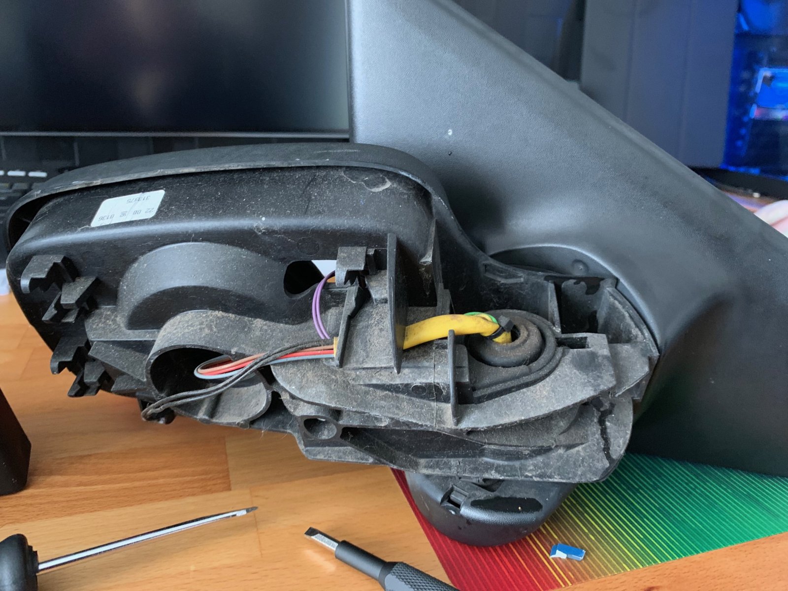

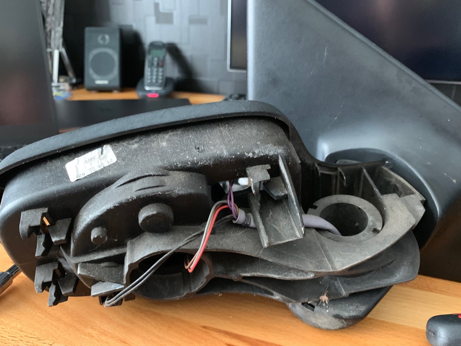

There is no way to do it as far as i can see, the folding is built into the hinge which is moulded to the mirror housing.
Folding
None folding
