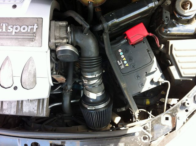

Just a quick one, my 182 came with a K&N induction filter when I bought it. I'm wanting to return it to standard, but the car didnt come with the original airbox.
The question is, what am I missing (apart from the obvious original airbox)
This is what it currently looks like:

Difficult to see from that pic. You need the airbox, including bolts & bushes/washers & the cold air feed. Your car might also be missing the acoustic valve. In which case you want that too including the fixing bolt (I personally wouldn't bother with the acoustic valve as IMO it made no noticeable difference).
