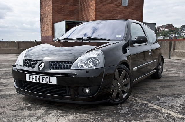

I always believed I had one of the best setups on my Clio and I will continue to run this or tell people too.
Was on FK Konigsports with 25mm spacers on the front and 5mm on the rear. I ran -1.5 degrees on the front and the rears stayed standard camber, next car I will run -1 more on the rear.
I had both wheels the same from the arch, if you fold your fingers over and out them on the tyre your knuckles should touch the inside of the arch. Being the same from the arch it gave a little bit of nose down.

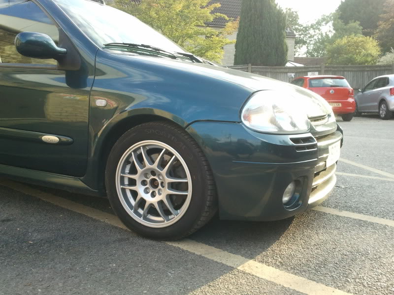

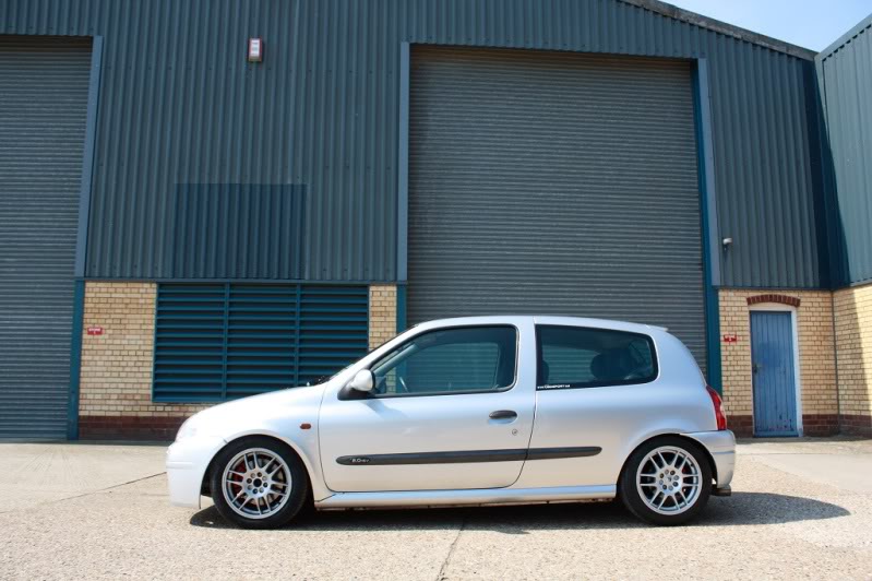

Here is mine atm, running same as you Danny at rear, -1 neg camber and 5mm spacers, front are on 20mm a side.

that has about 30 to 40mm front rake. spacers wont help the handling in any way and if anything the weight of the spacers will be increasing rotating mass. equal arch gaps are a common misconception of "rake" unfortunately thats not how it works.
car looks nice though, im assuming you are going for looks rather than handling with this set up?

Tool low on the rear. 30-50mm F/R drop, you need some rake mate.
Wrong, as that car stands there the car has 15mm front rake. (the car does not sit like this any more)
you are making the common mistake of measuring rake from arch gap.
Actually (theoretically at least) the spacers on the wheels should help overall grip levels especially large ones on the front. Widening the track reduces the weight transfer in a corner, of which a FWD hatchback has in abundance. Anything you can do to reduce this weight transfer on the front should improve overall grip levels and make the car more balanced front to rear. Obvioulsy downsides to spacers are large scrub radius on the front tyres and wheel bearing replacements!
