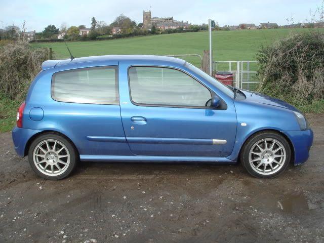

So the cup looks rather high at the moment, few people have commented on how high it is.
So......Im not sure whether to lower, fit coilovers or springs.
Any advise would be grately apprechiated at the moment.

If anyone has pics of Cups with either on could you post?

Sportlines will make it sit like this (as they should imo)
