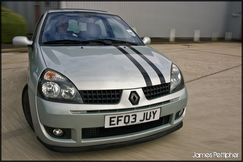

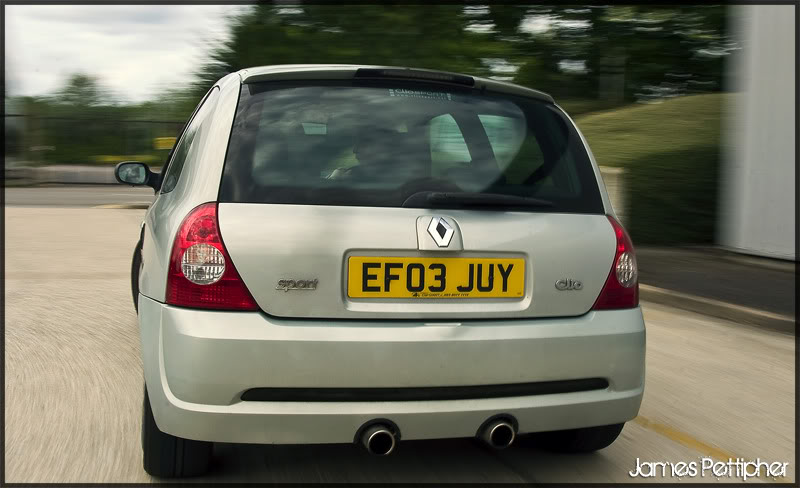

Decided to have another play with the rig this weekend, i need to get some ND filters though so i can cut the light down a bit for longer exposures, anyways reasonably happy with these. both images are the original capture with the rig cloned out rather than a static shot added over the moving image.

As mentioned, not the worst. If possible, get out an push for these. Should make them a bit more sharper (though the sharpness here is good already).
Cannot check EXIF on these shots, what aperture/ISO were you using?
  Oil Burner
f19 iso100 1/10
If you could get the fstop lower you would get more of an oof background and probably wouldnt need a much lower shutter speed.
im pretty sure you could drop down to 1/5 or lower and recover the shots. Or use RAW.
Ive done 1/5 shots with motorsports, i underexpose them untill they meter correctly.
Or a filter would be a better solution.... or wait untill its not so sunny

I would say it needs to drop even lower. I would aim for a SS of about 1/2 sec but in these conditions, not a bad attempt.
Once my new rig arrives, ill order up a ND8 filter. *drools*. Ill feedback how that gets on.
  1.2 Dynamique billabong
yeah i tried to stop it downs as much as possible, but it was just too sunny, like i said i think some ND filters are needed.

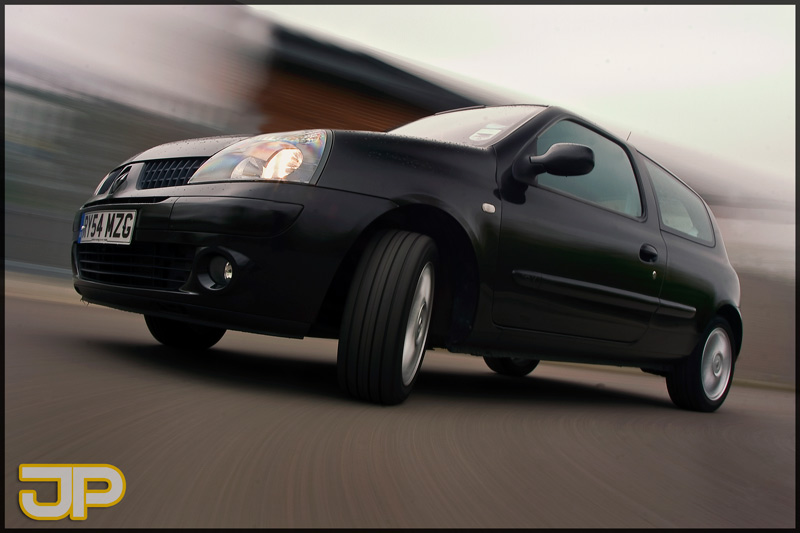

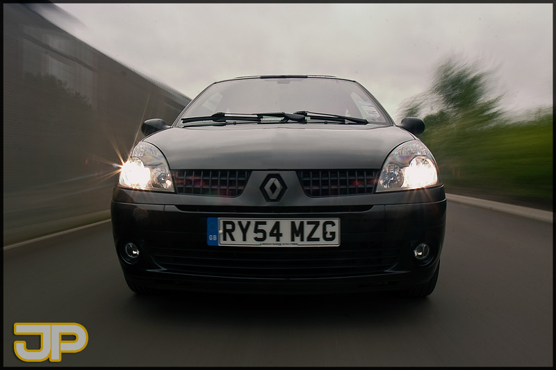

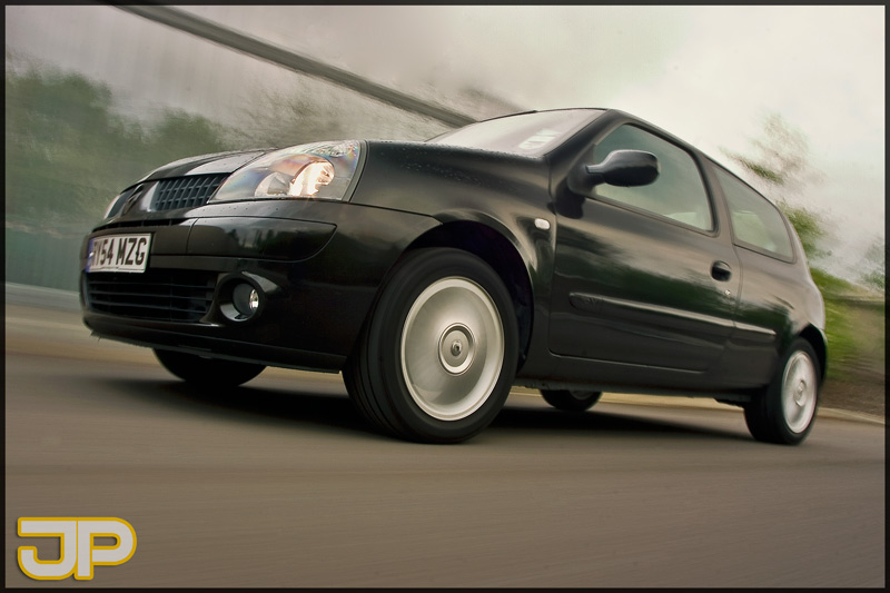

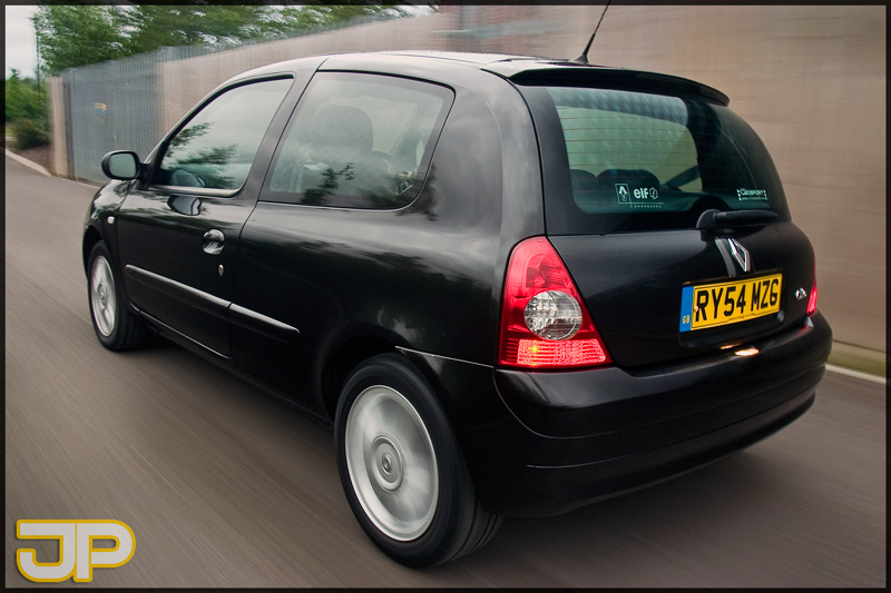

right i had a bit of time this evening so dispite the crap weather, decided to have another play with the rig as the low light ment i could try longer exposures. What do you guys think ?

Great stuff!
You're quite welcome to try it out on my car anytime you want mate ;)
use an ND filter to reduce the shutter speed then you'll not have to use such small apertures which will make the image quite soft
