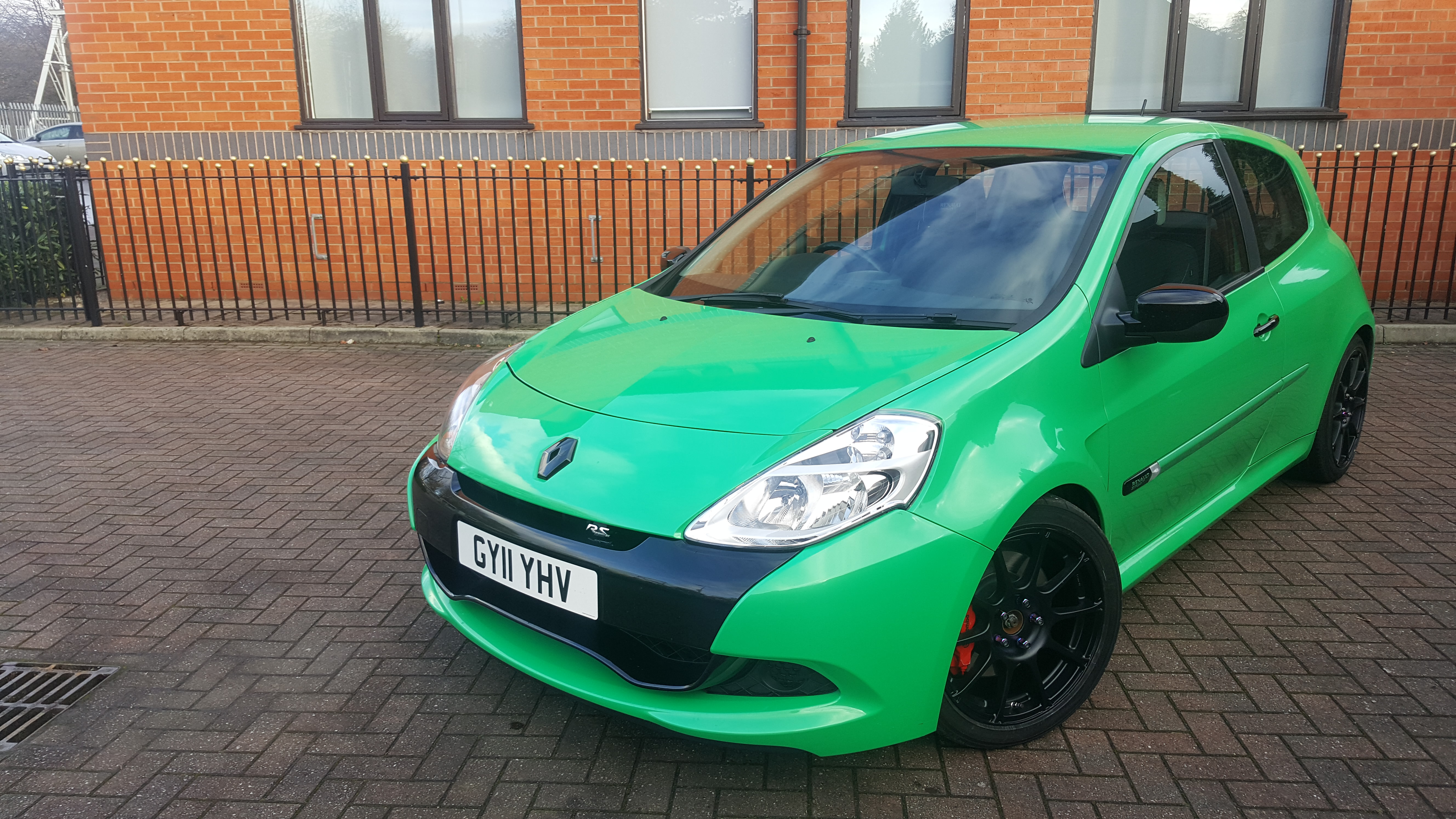

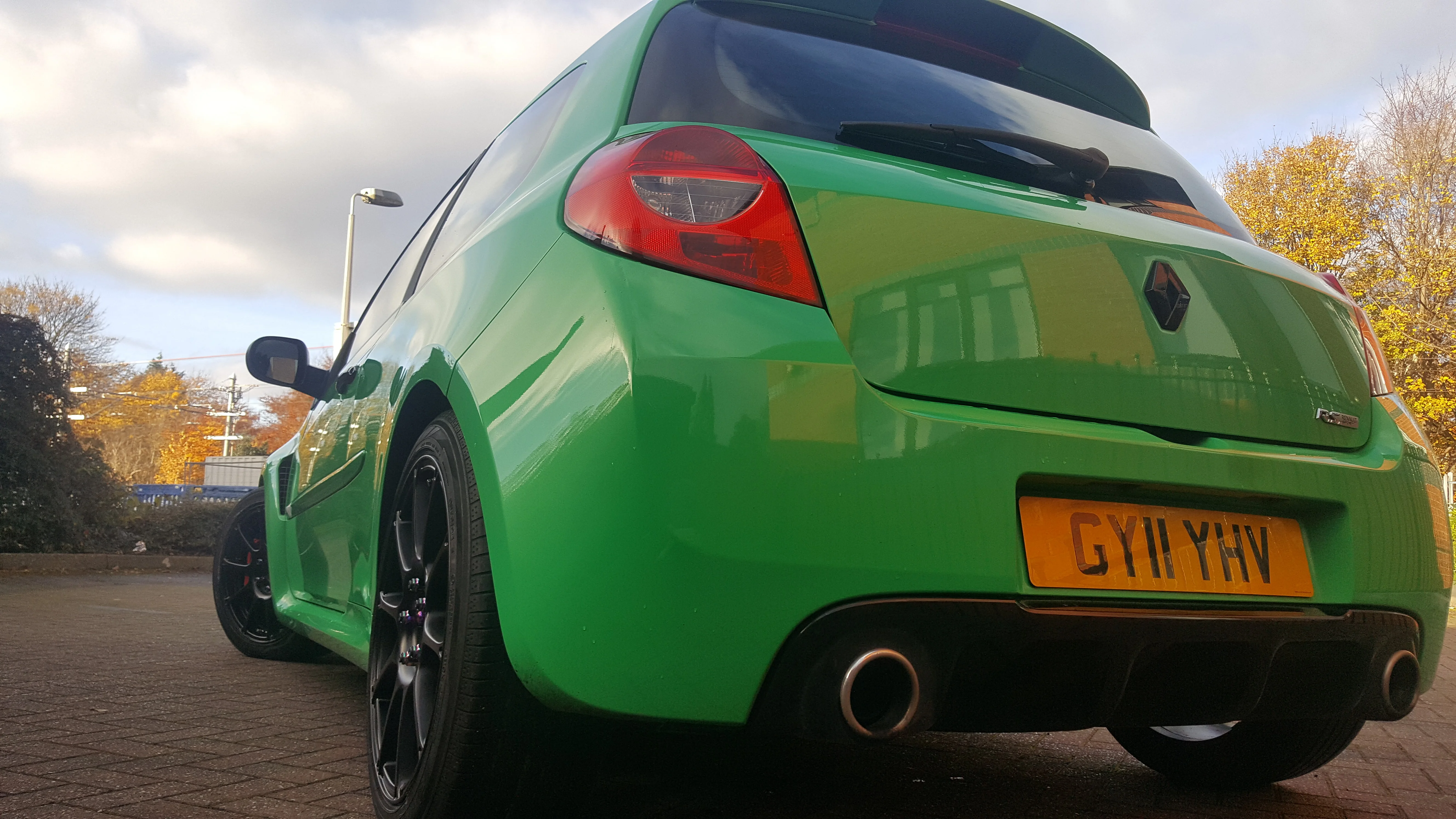

Forgive the quality of this image, but it's the only one I have just after buying it and then making the drive home:

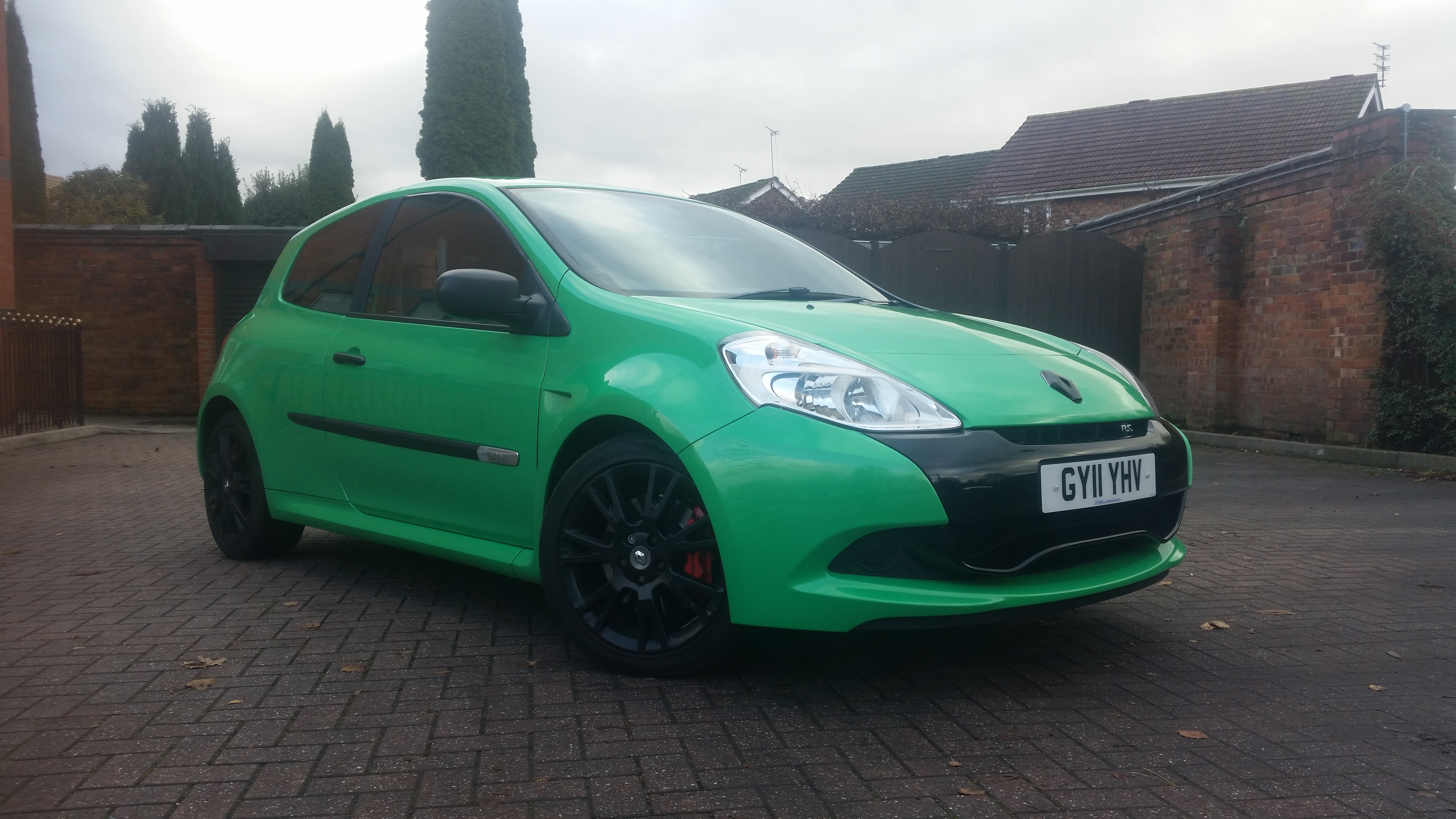

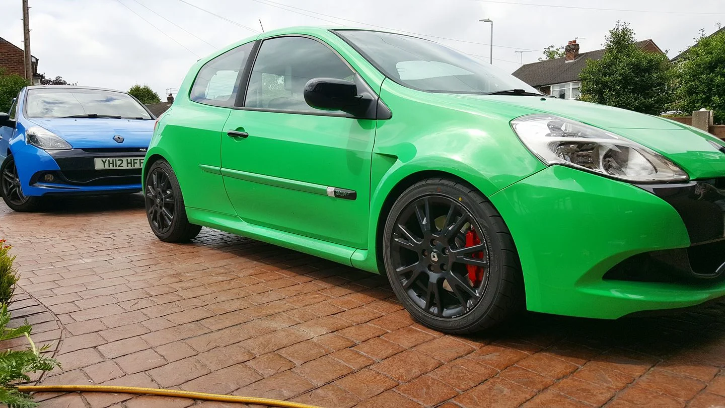

So after getting home, black diamonds on! (black diamond crew represent)

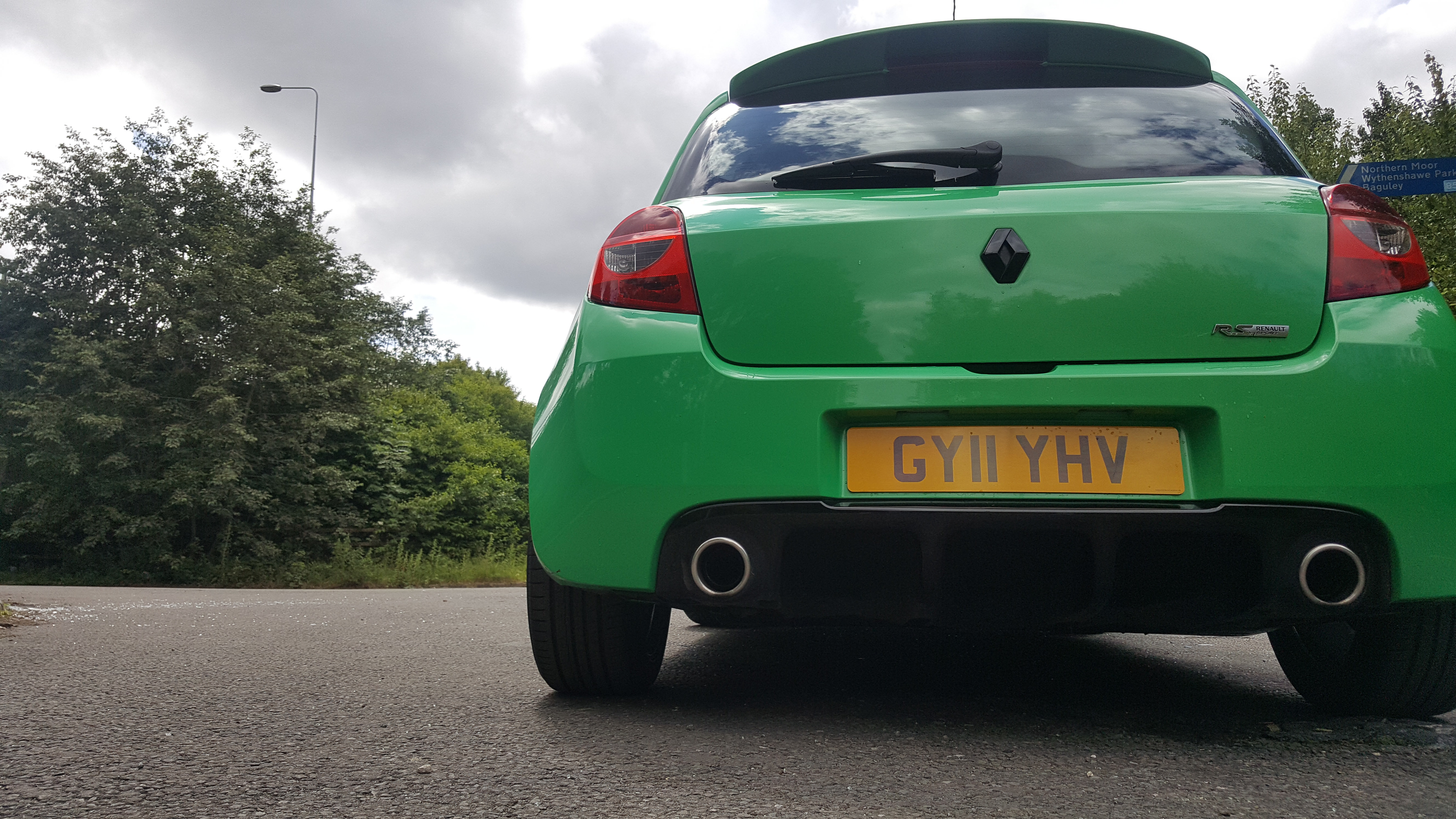

I then very quickly sought to get a new exhaust and opted for the Scoprion non-res as that's what I had on my Meg. I forgot how much louder it would be on a NA car, but I love it! 😂
Also fitted some silver visions and an ITG panel filter. (I'm all about the little touches as you'll see).

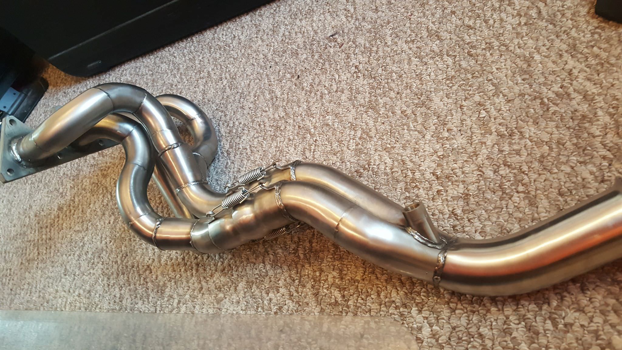

The dreaded flexis went not long after, and I bought a second hand manifold and had that welded up and fitted..

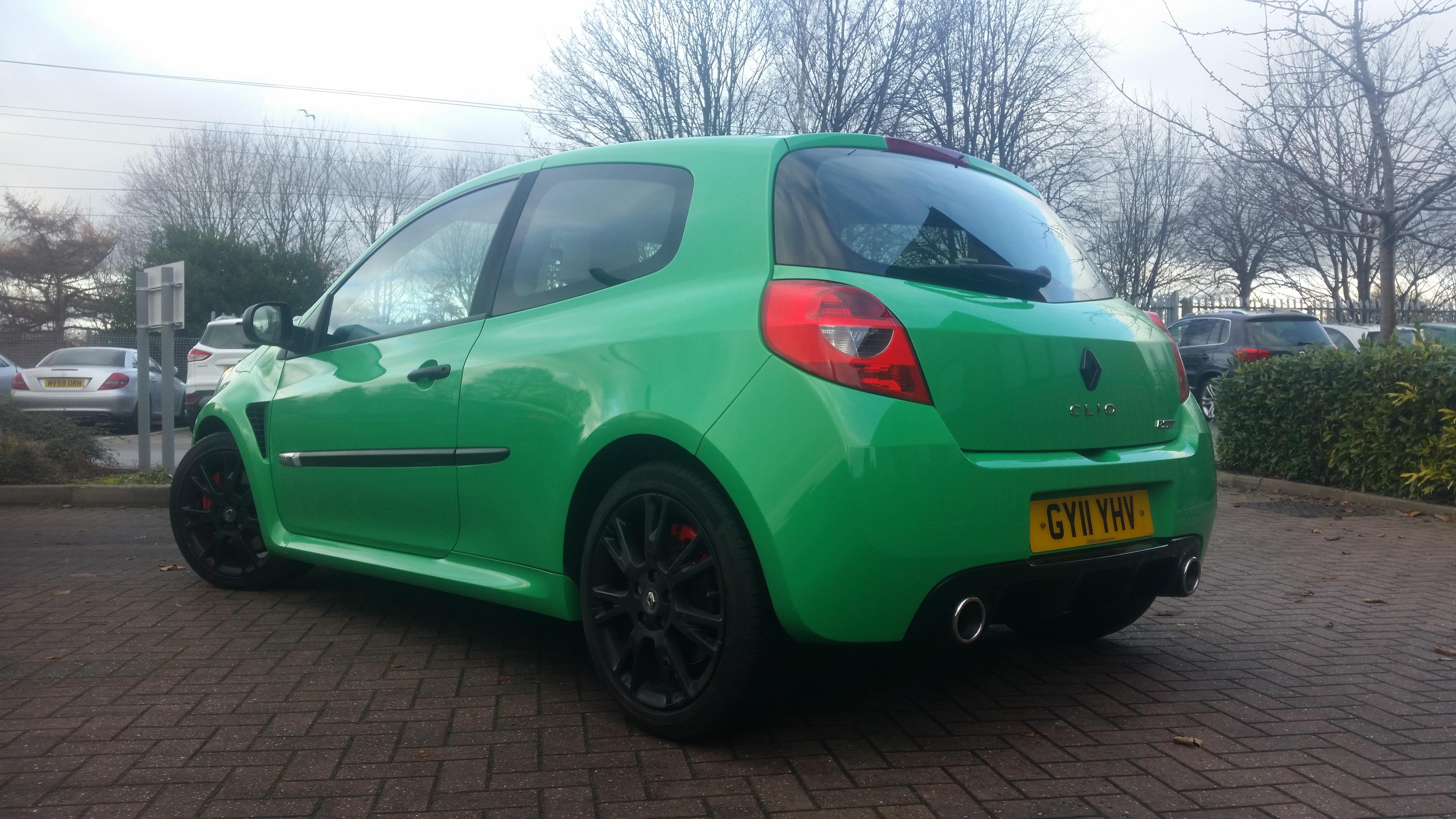

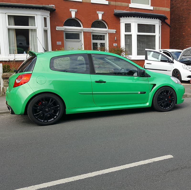

Was like this for a few months, then decided to get myself a sprint spoiler, was never really into the trolley look of the cup spoiler.. ?
Whilst getting that painted up, got the the door strips painted to match, and the handles and wing mirrors done in black, and bought some black center caps to top it off.
Also painted the bullets with the AG writing myself.

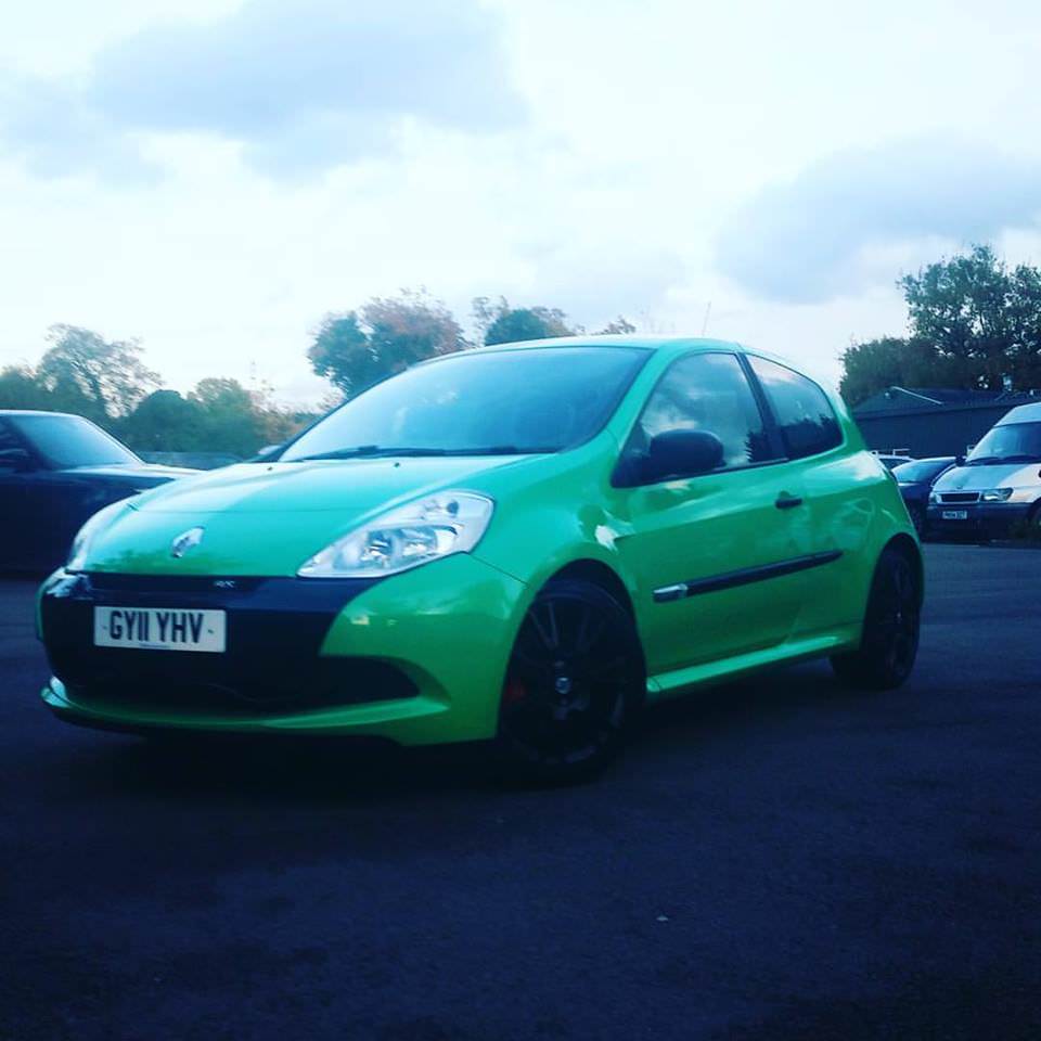

So to say the least when I got the car back it felt transformed, the combo of the AD08R and the H&R made my commute drive amazing, I drive 4-5 miles in town then 4-5 miles of windy B road at 5:30am, bliss!

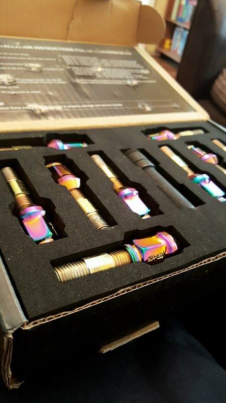

I actually had a set of TPI studs to go on too, but they don't fit the holes on the Renault wheels where the unthreaded part is. ?

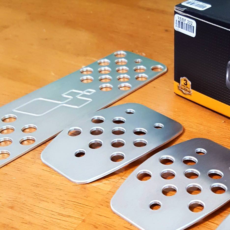

New pedals

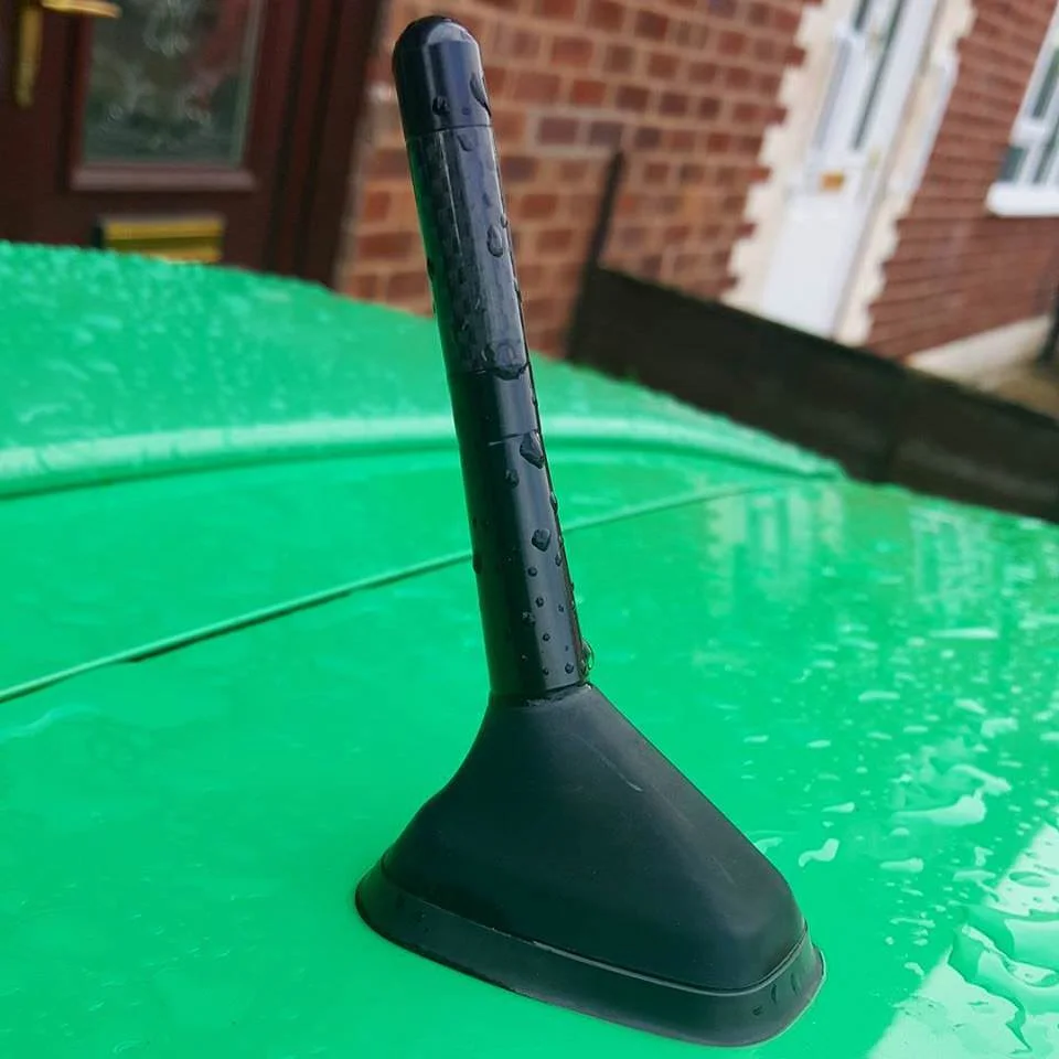

Smaller aerial

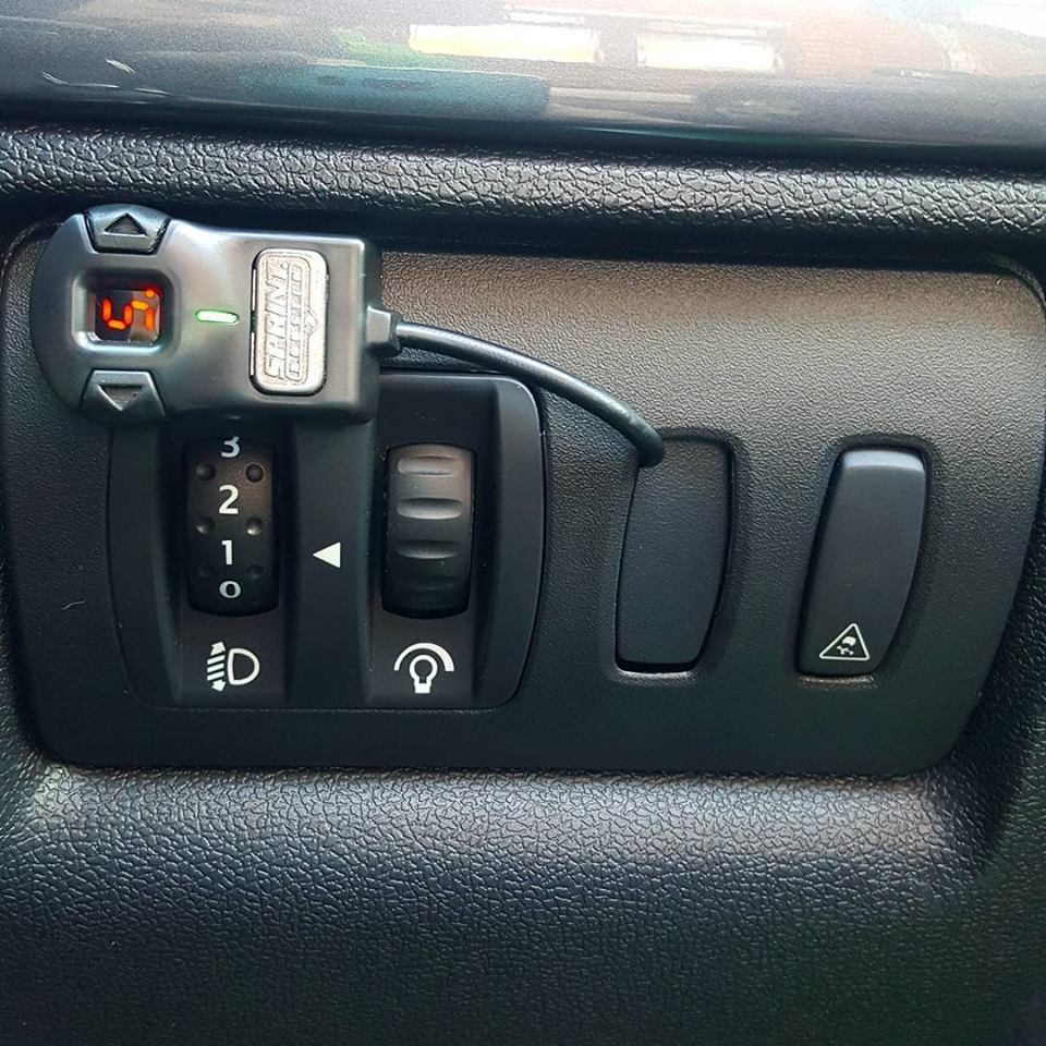

and a Sprint Booster, which I get asked about all the time, to the point I have a 3 paragraph copy and paste reply saved, basically I found the car hard/laggy to rev match and heel/toe compared to the Meg 250, and it felt unresponsive, this fixed all my issues.

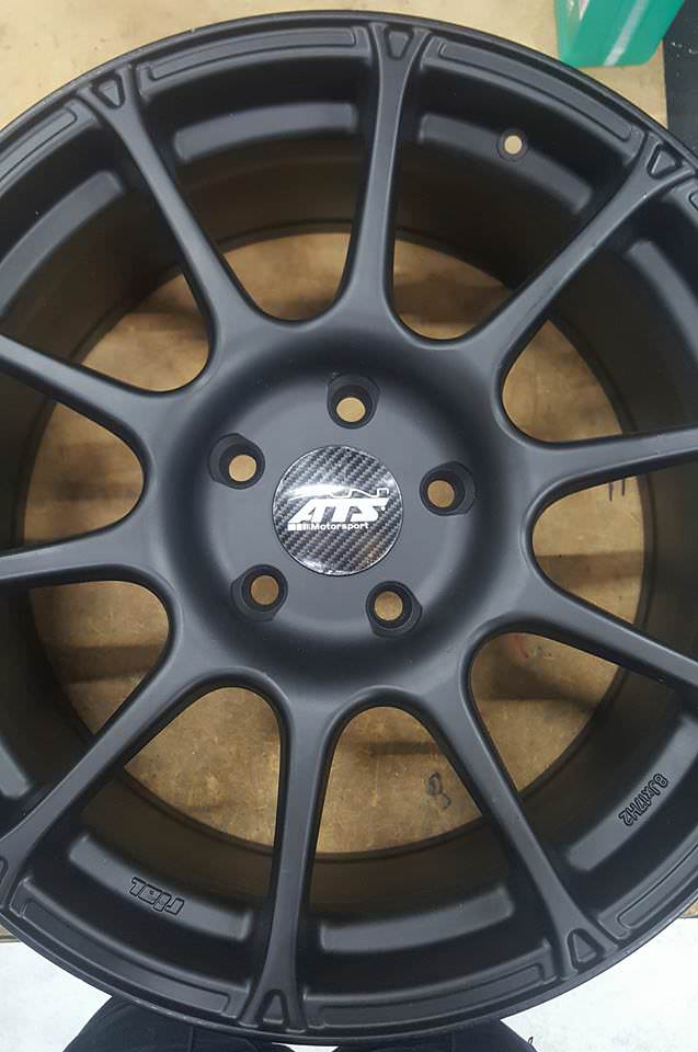

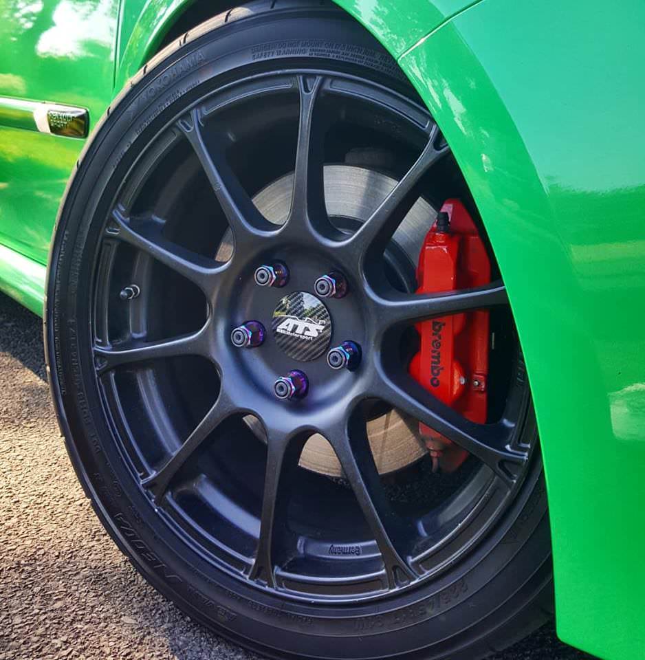

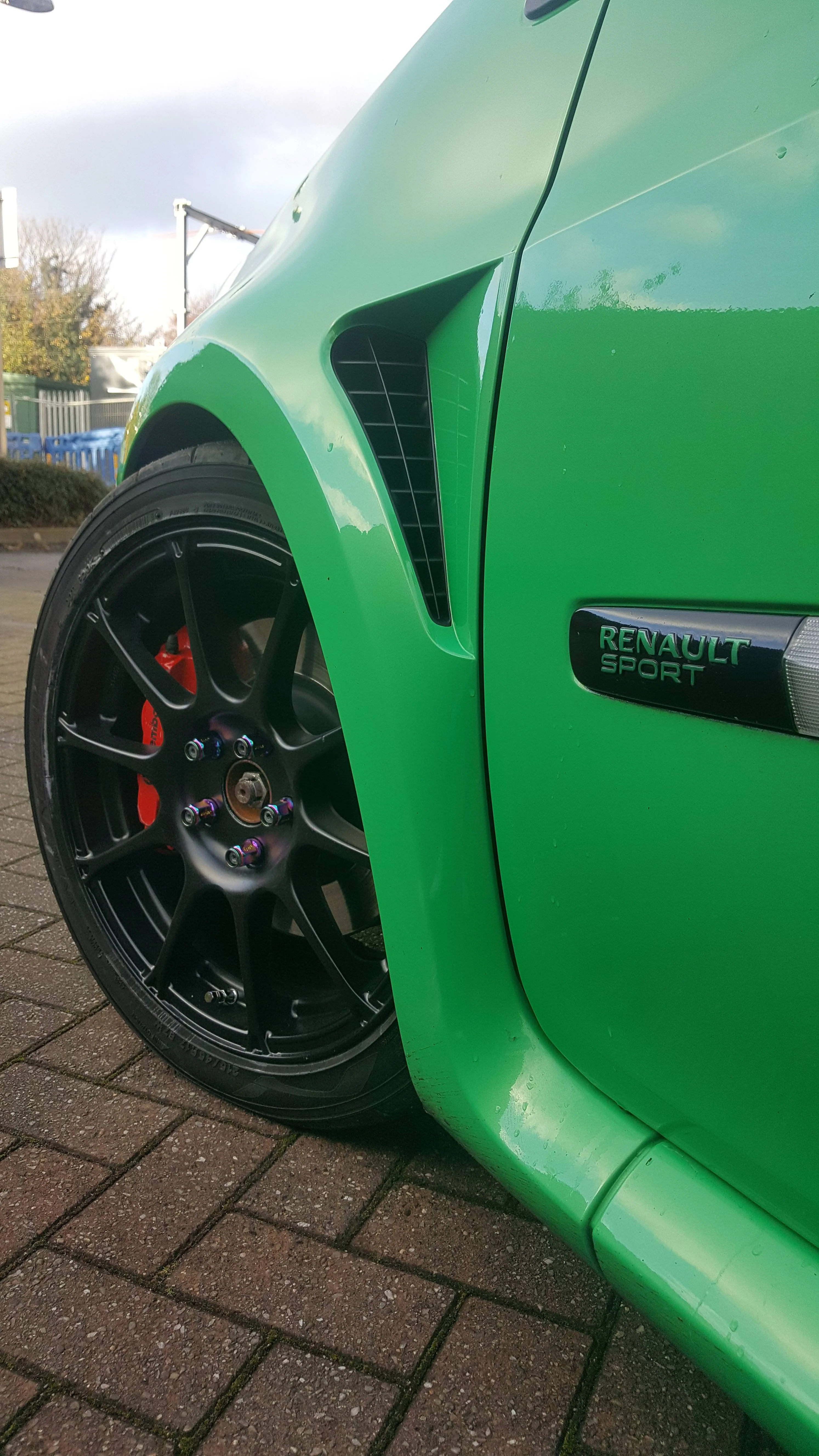

I had started toying with new wheels, was looking at O.Z. Alleggerita's but had been given a 3 month lead time for them from O.Z, and I'm impatient..

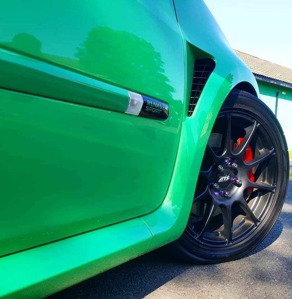

Some legend called @Christopher suggested ATS GTR's and pointed me towards APmotorsport, who just happened to have a second hand set!
R17, ET57, 8J
Bought, and then machined down some black bolts to get my TPI studs fitted with them.
I couldn't get the center caps on at this point as the bore fitted so snug to the face there wasn't room for the clips to locate:
Got myself some 5mm spacers on so I could get the caps on!

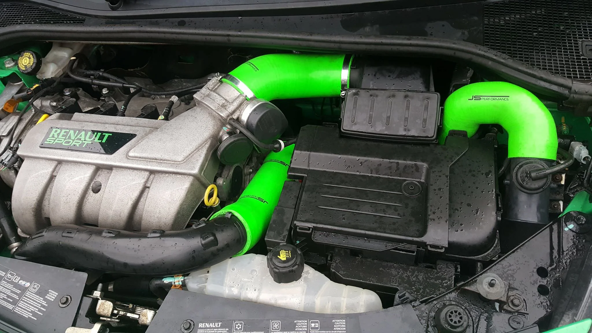

Also spruced up the engine bay a bit with an impulse buy on some second hand pipes:

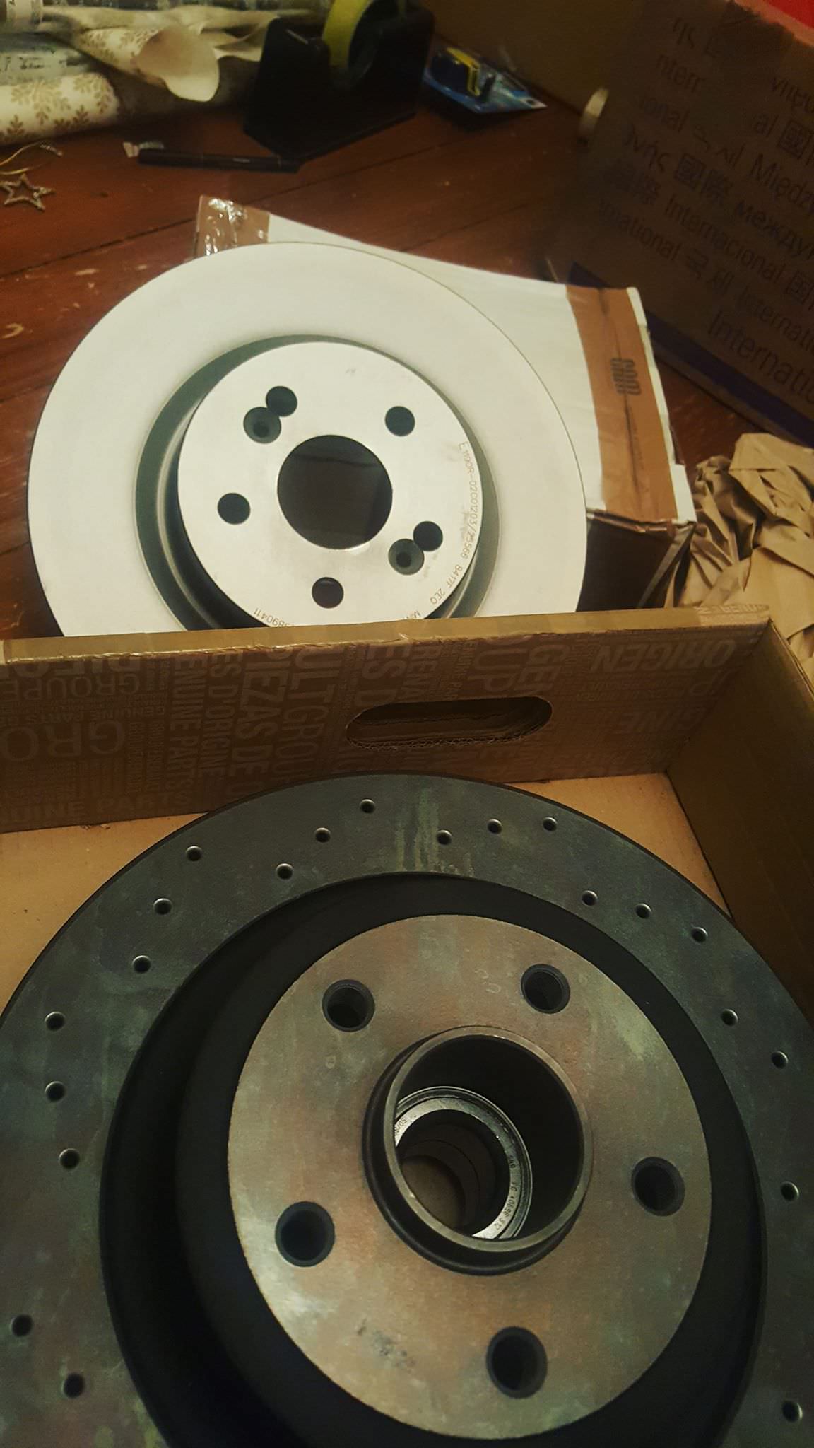

Some time after, I started feeling like I had to press my brakes quite a bit to get them to bite, and I came to the assumption the discs had never been changed in all it's life due to the lip on them.
So HC Brembo fronts, and some drilled standards for the rear (mainly to save a few quid).
Car has been like this pretty much since, although my manifold got wrecked by a speed bump pothole combo, so I uprated this time, bought the Predator system from Kamracing.
No videos as of yet, doesn't change the noise a whole lot, but goddamn it pops, crackles and burbles A LOT now.

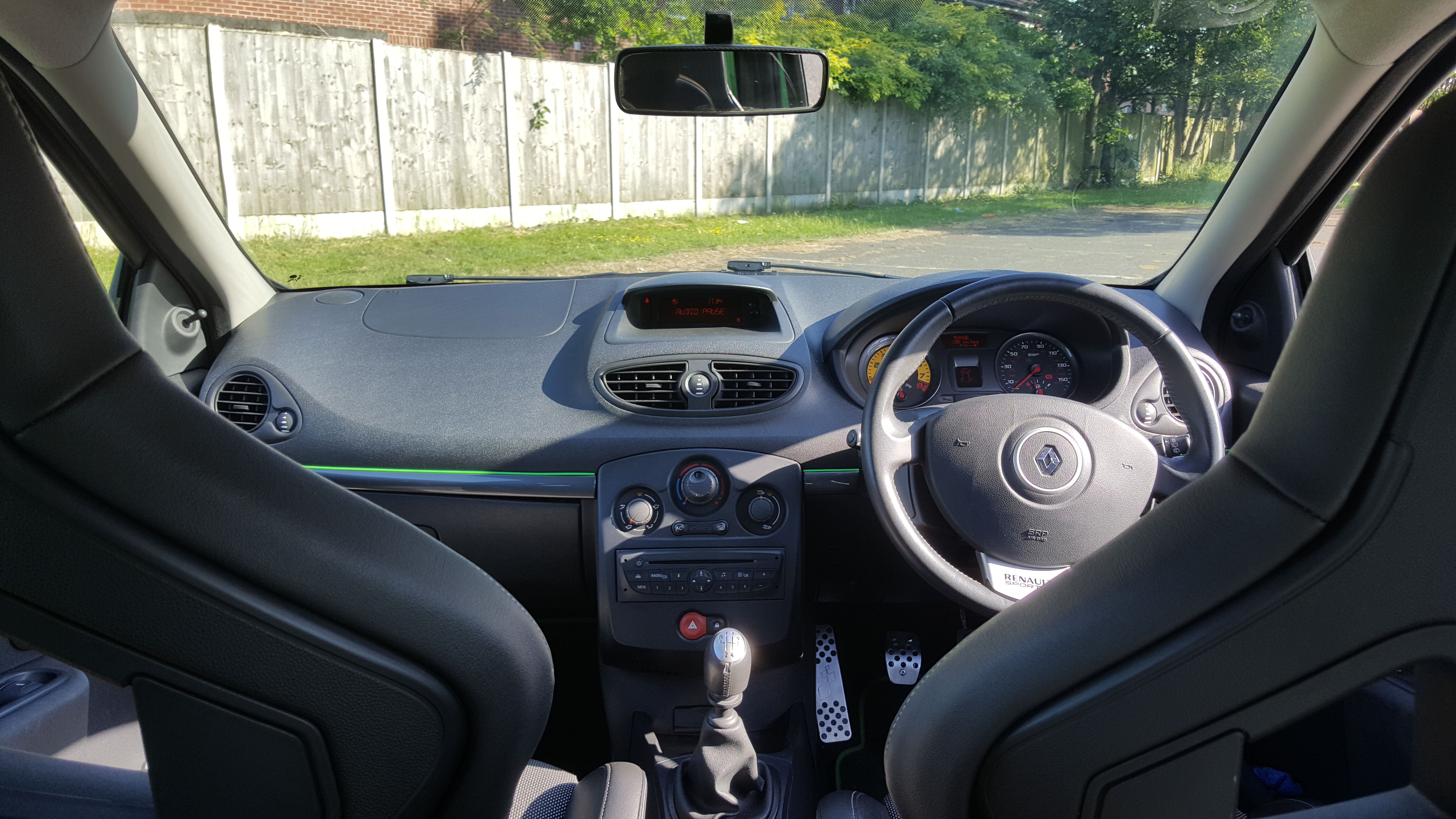

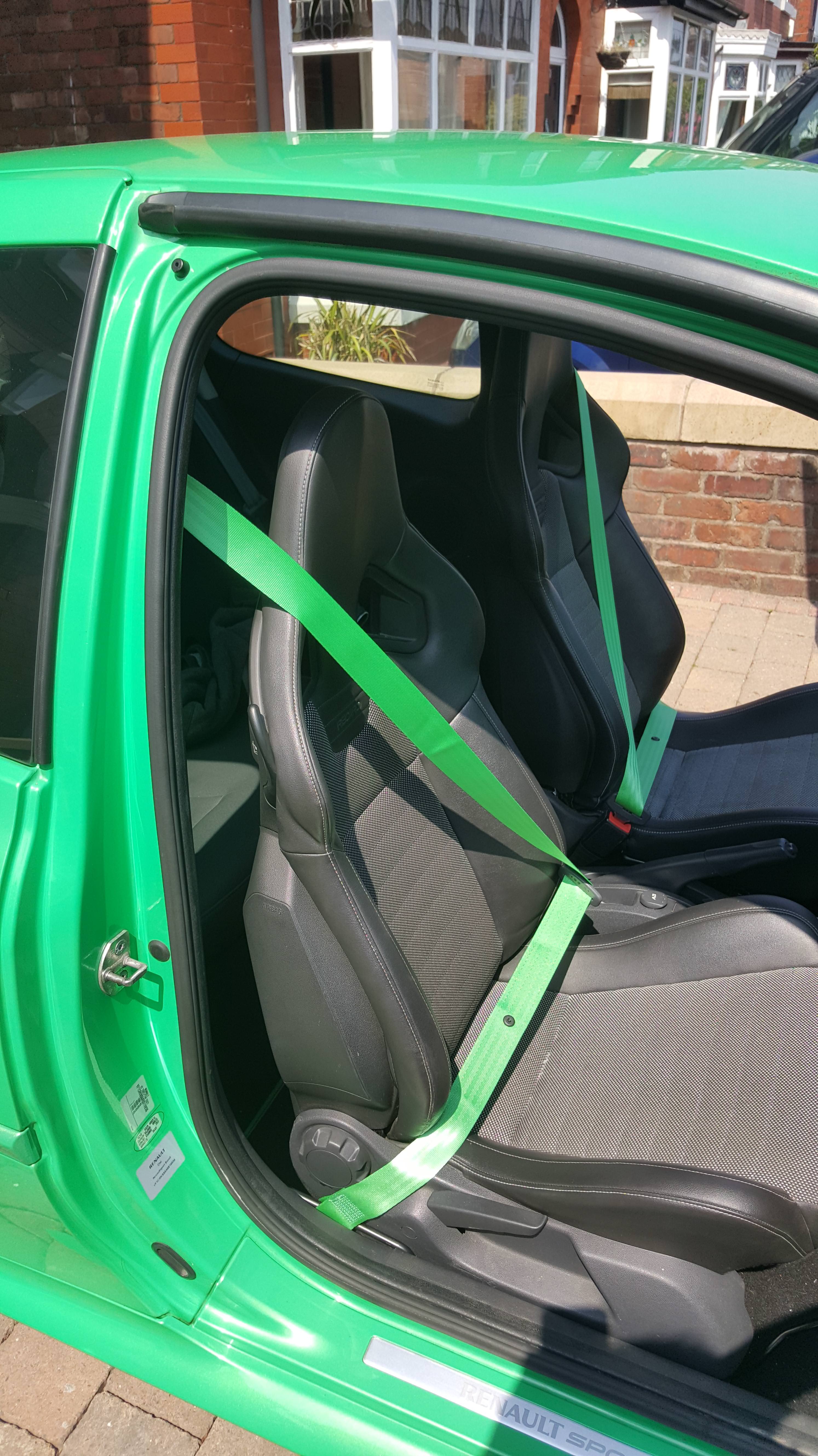

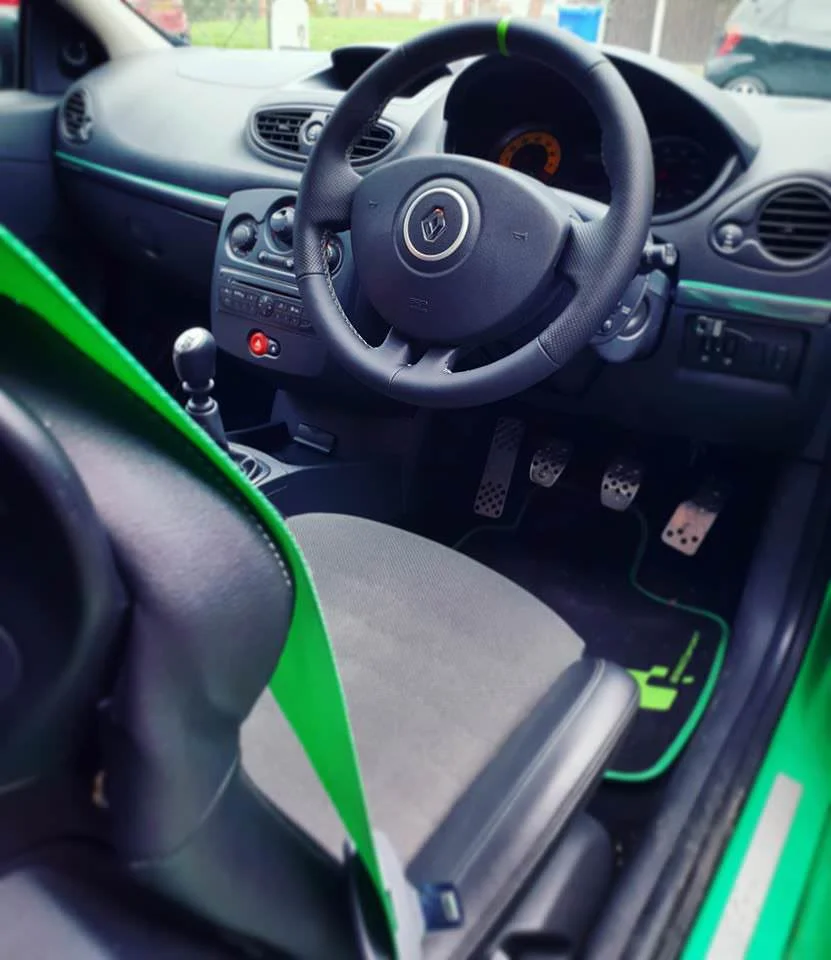

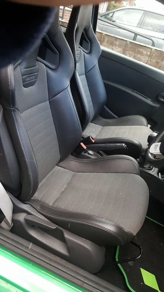

Also seen a set of VXR seats with custom rails at a bargain price, so another impulse buy it was!
These completely change the seating position, they sit a good 2-3 of inches lower than the standard seats, you feel very 'in' the car.
Also comfier than the recaros that were in my Megane, slightly more splayed edges, and a thicker base, which makes longer drives much more bearable.
I then got my green belts fitted which I had lying around for year, sorry @Stevef175 😅

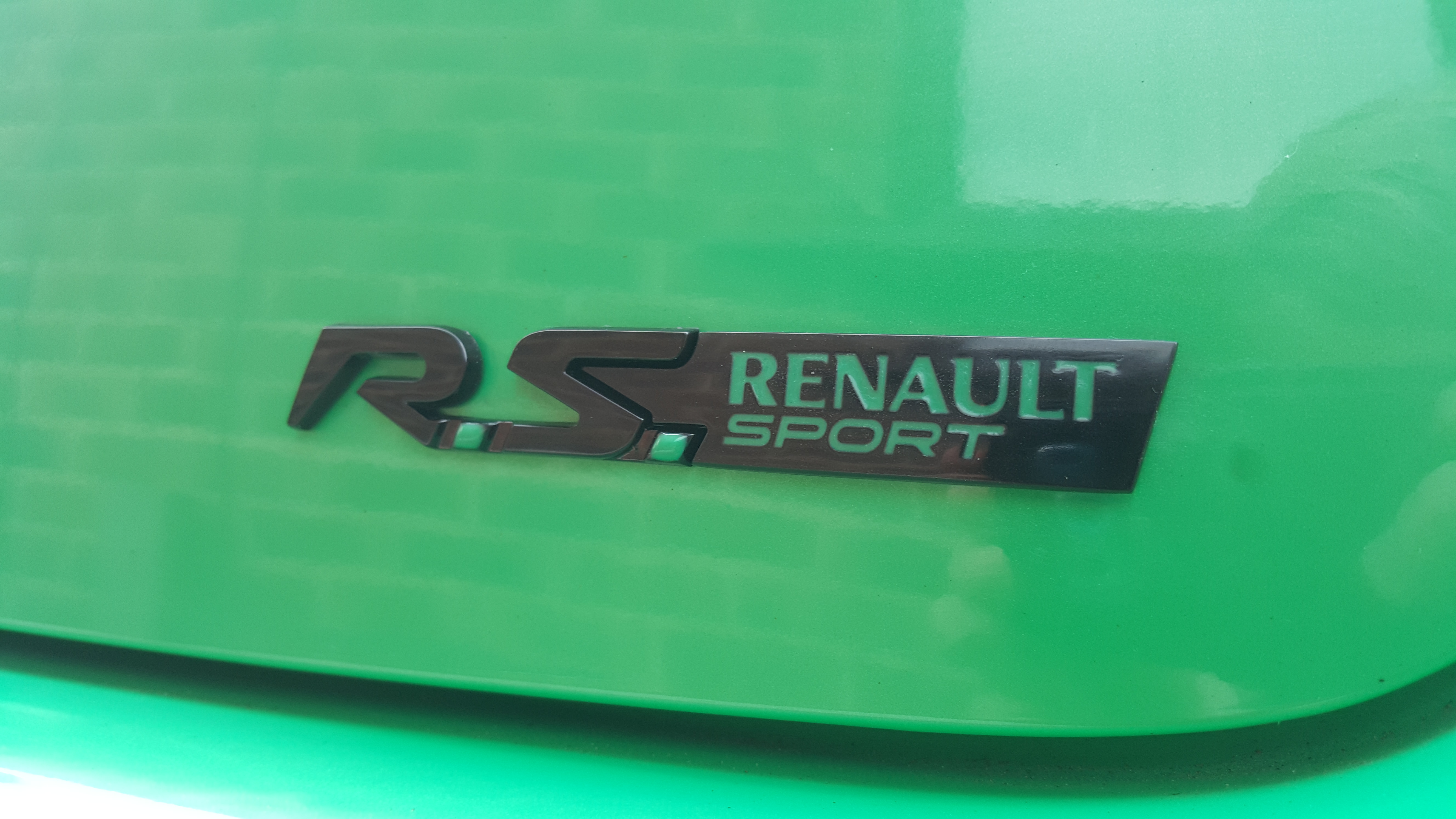

And the more recent bits I've got done, some colour coded RS badges for the front grill and boot lid, and also added a bit of green trim to the dash strips.

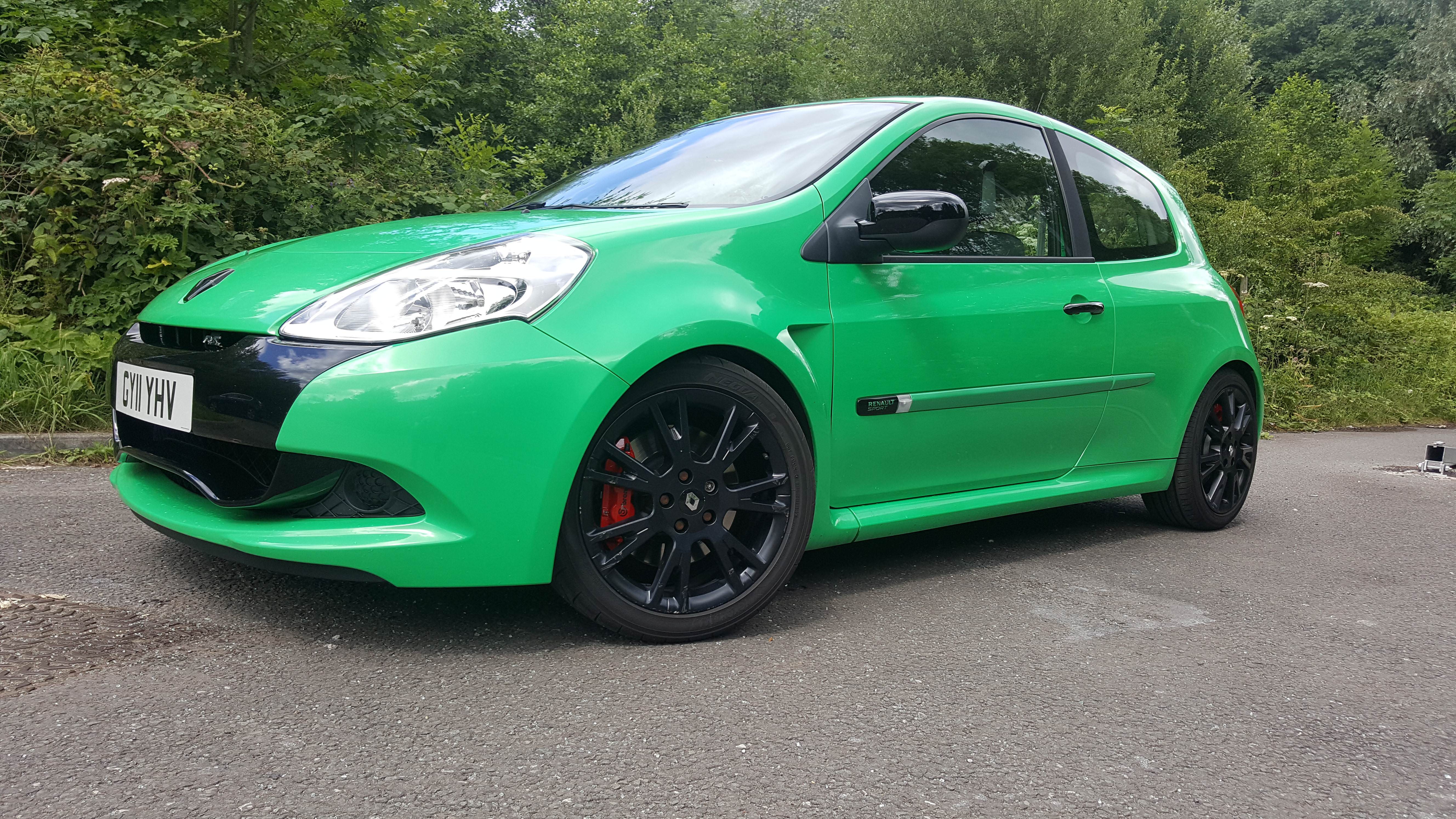

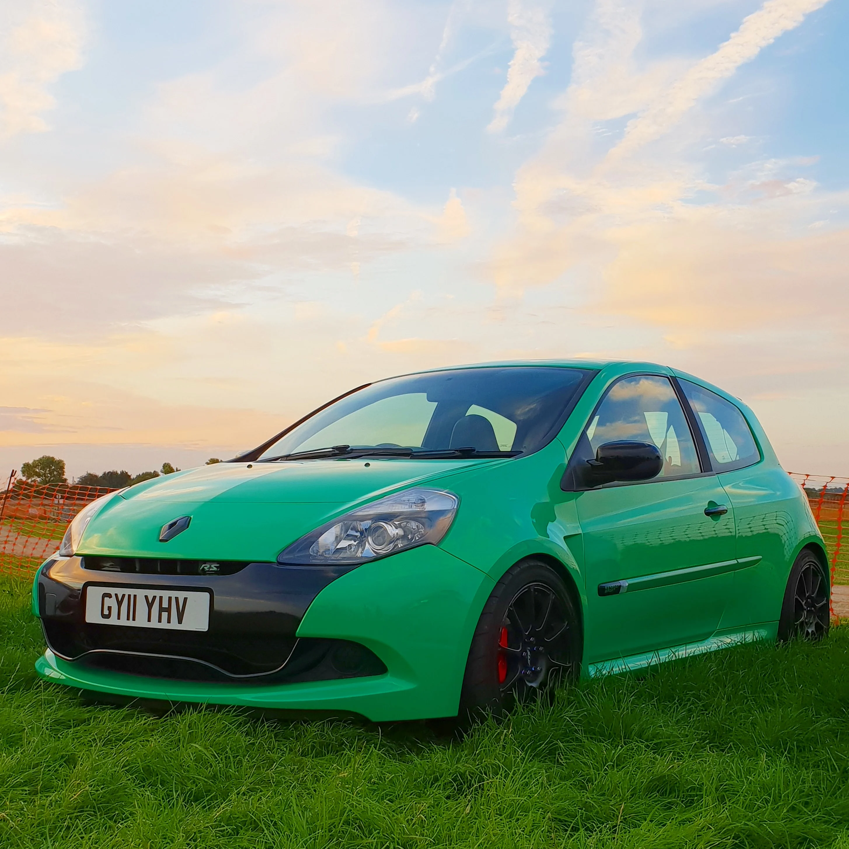

I'll leave you now with a couple of shots with the car now sitting on 104k miles!

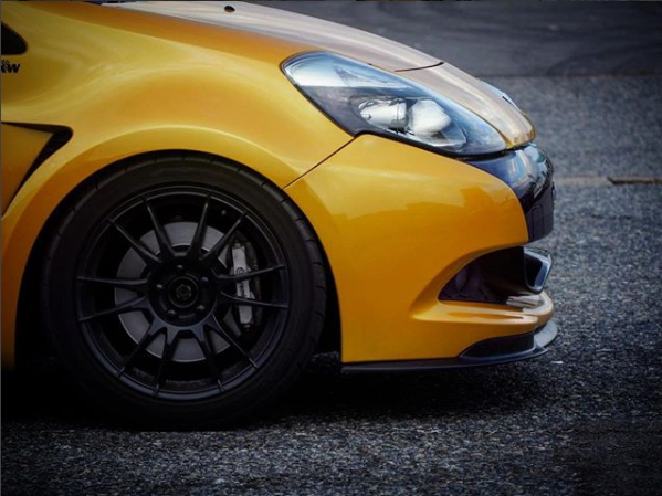

Was looking into the SiFo splitter, and had been in touch with the only guy I know has one, and unfortunately bad news.
The SiFo factory closed down and there was no announcement from them (makes sense why they never replied to my emails).
Sucks pretty bad as it's the only one I like for the 200, not sure if I could get someone to replicate it?

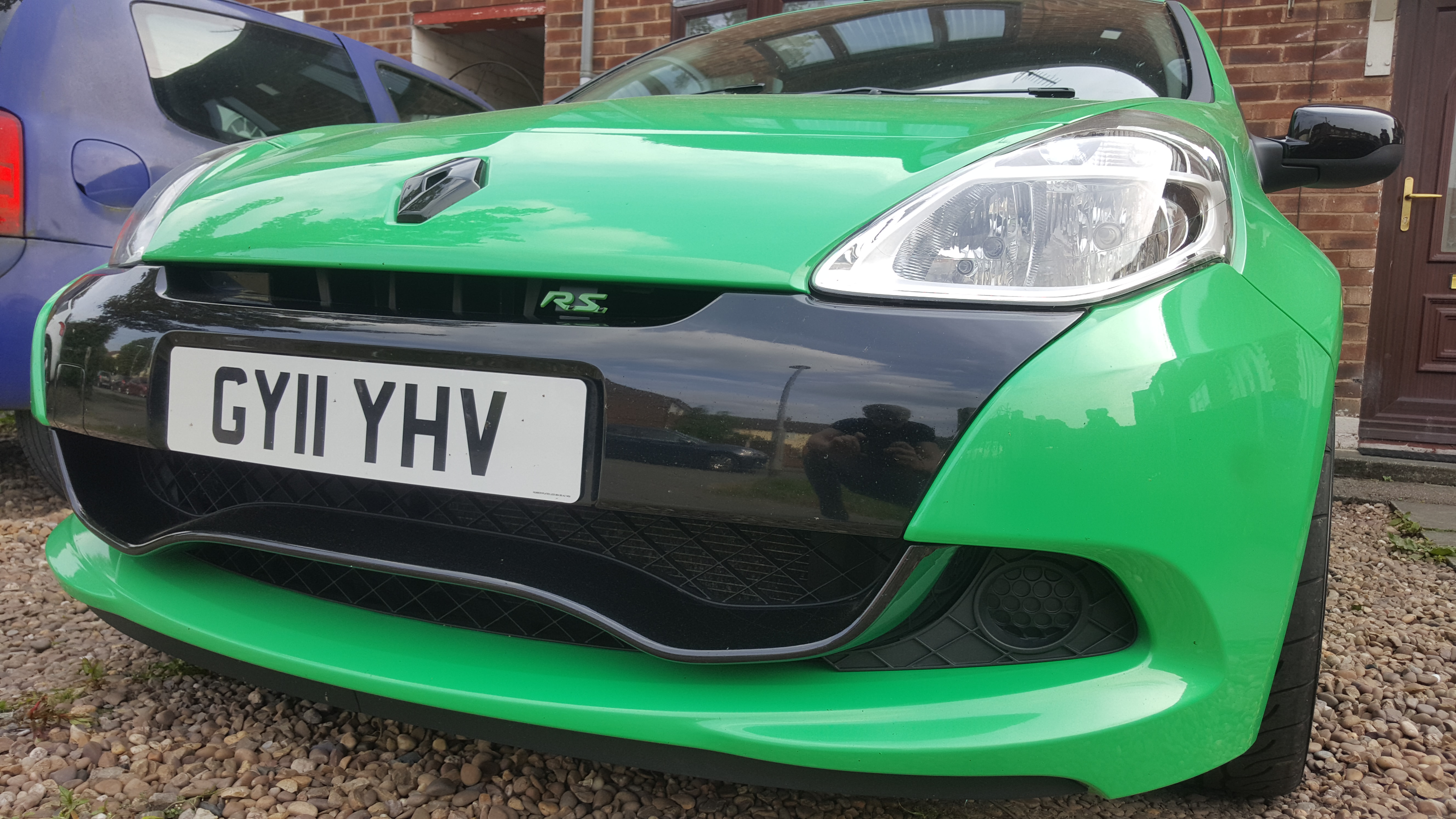

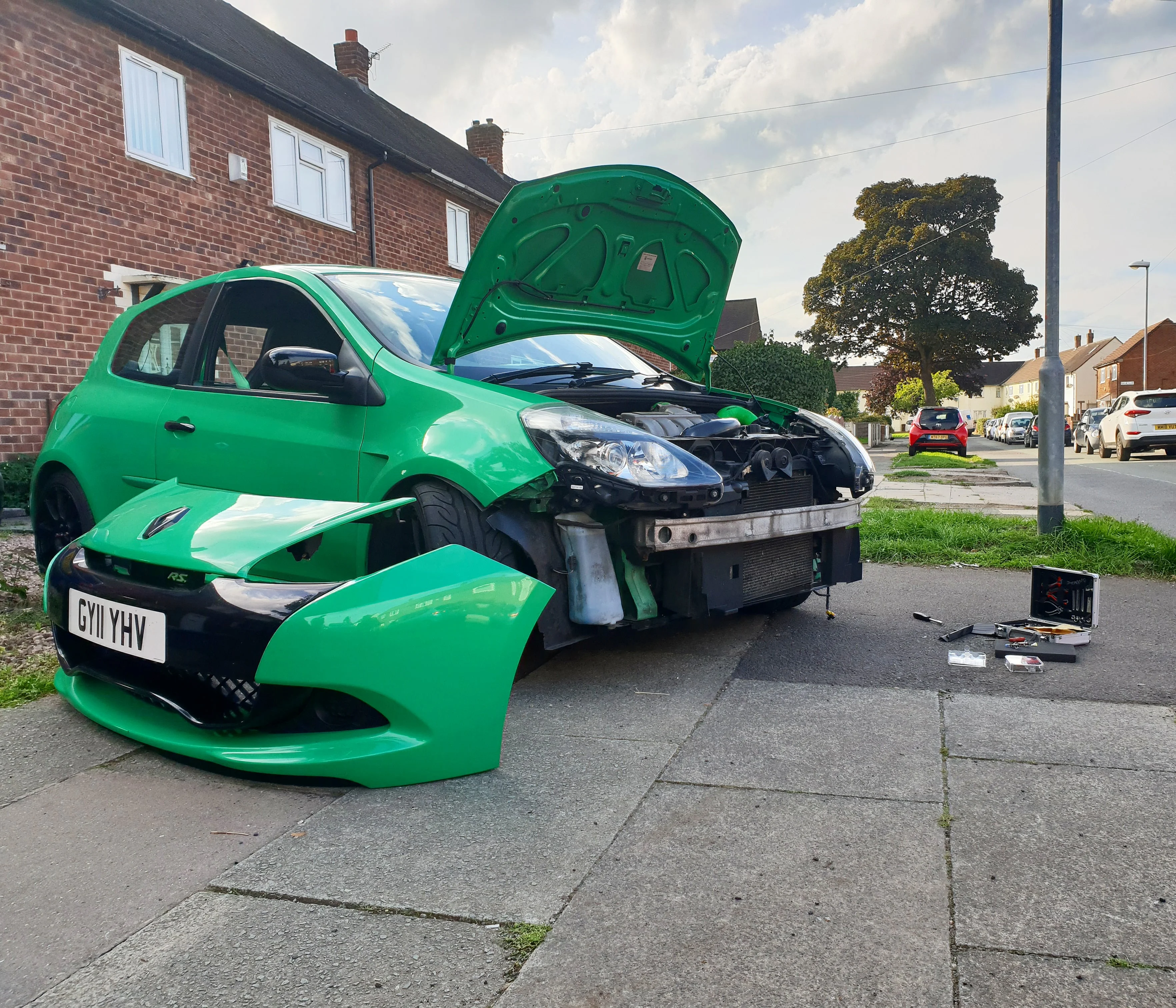

Got a hold of some projector headlights from a friends GT as he was about to sell it.
For the record, the brackets are different, and I did not realise this.. 😅
The RS brackets as it turns out have a cut out in them which some parts of the bumper slot into.
I tried to originally ham fist it on, which it just wouldn't locate on both sides, I then snipped away some parts inside of the bumper, which let it clip all in, but did not fit flush at the corner of the lights on both sides.
After a bit of research, I realised I hadn't swap the brackets over.
I have now bought the RS brackets, and it fits as it should.

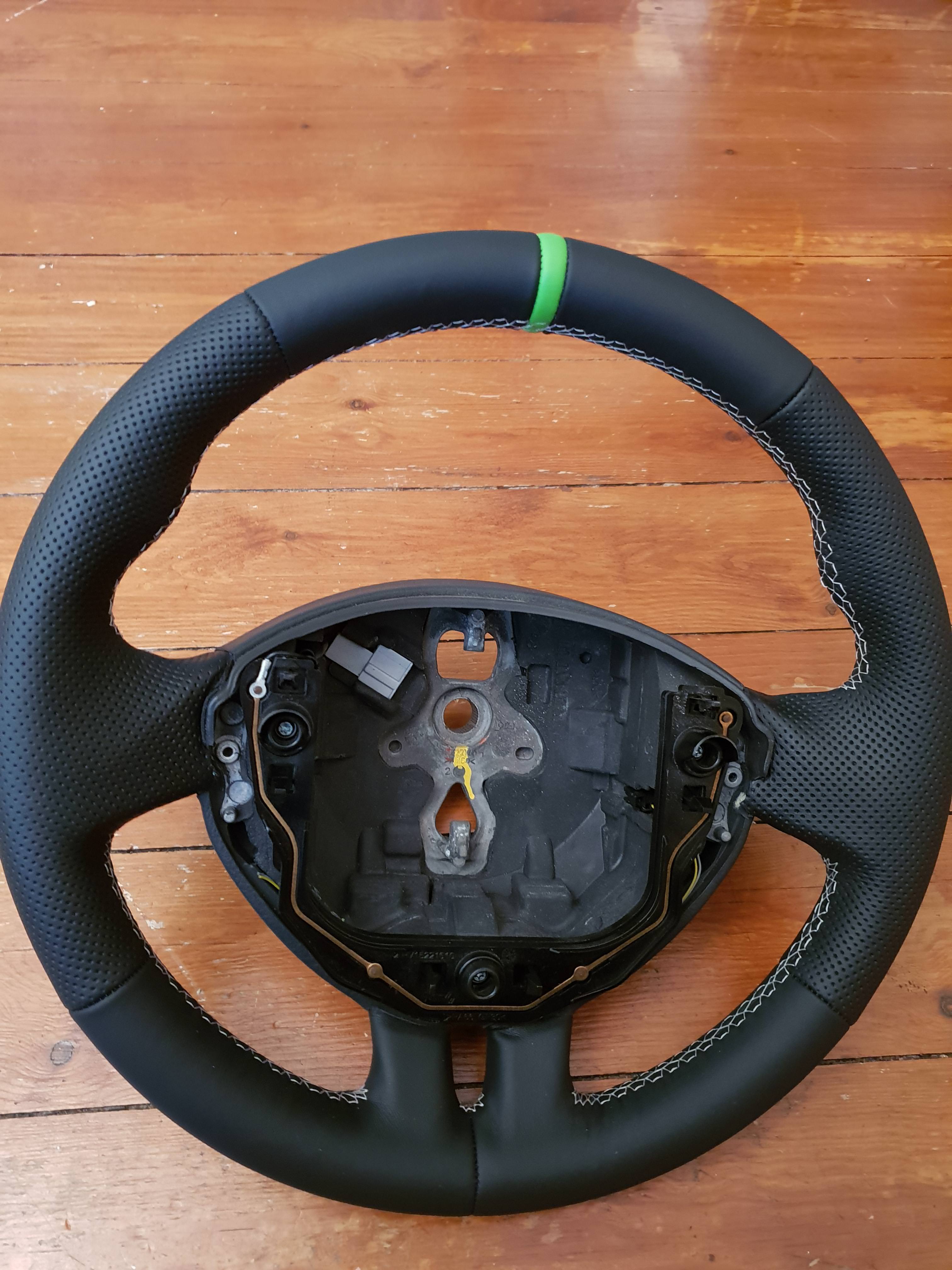

I've also acquired a steering wheel from the non cup model, as cups have the crap dynamique wheel.
It's due to be sent off for a re-trim to Royal Steering Wheels this week.

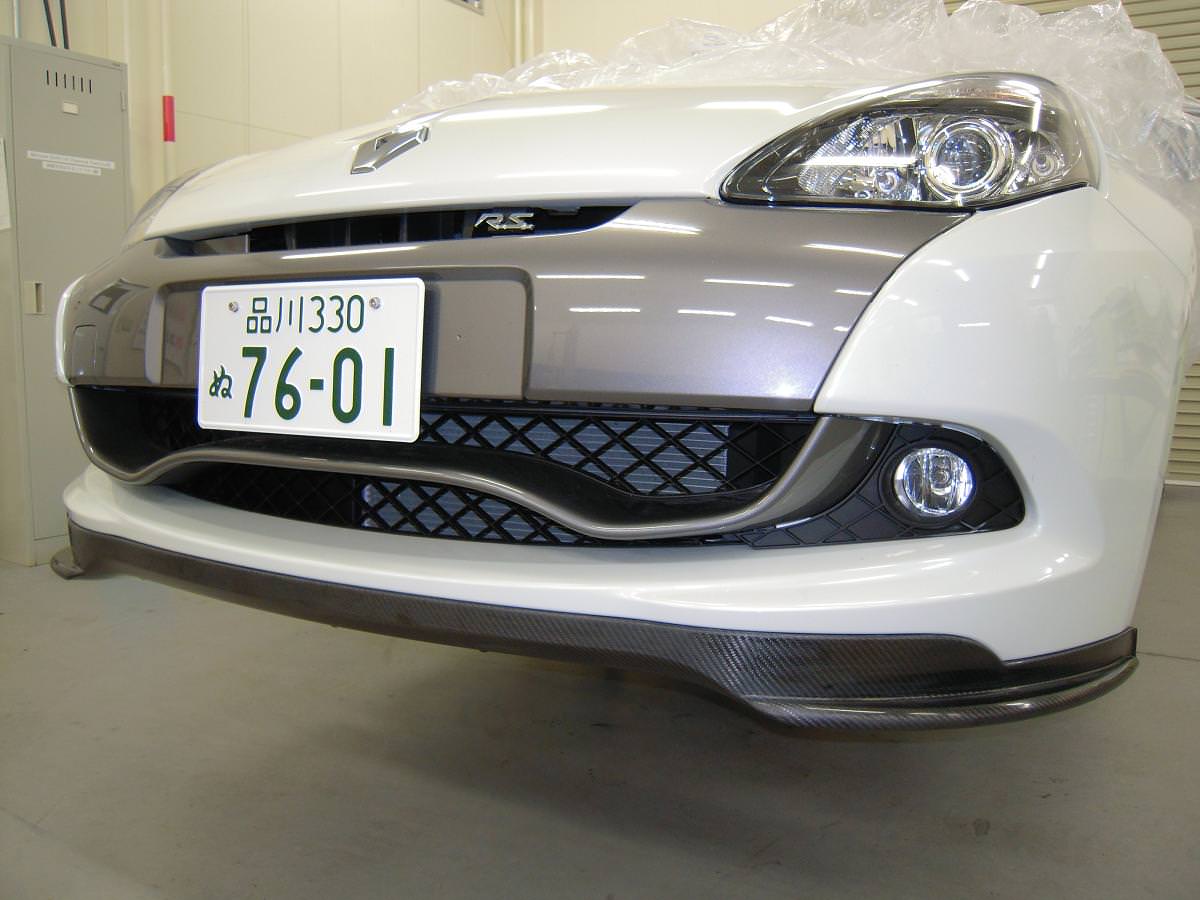

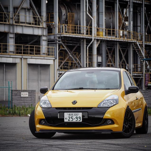

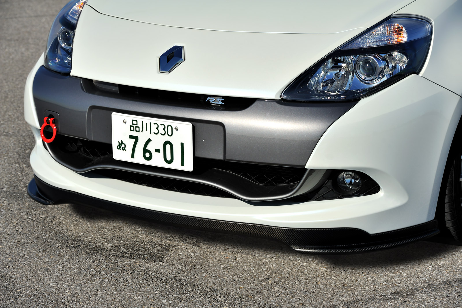

Final thing, I came across another splitter I'm interested in, again from Japan though (fml), trying to get in touch with them, but I think language is the barrier, I do have friends and contacts in Japan though, so I'm going to get them to give them a ring.
Here's some pics, on someone else's car (obviously).

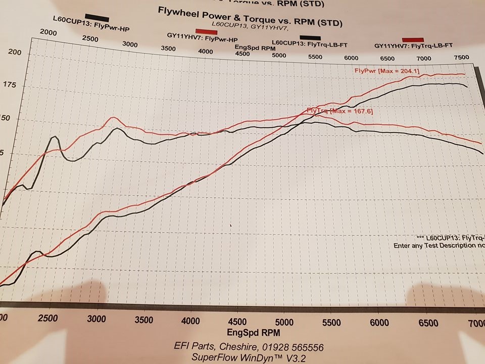

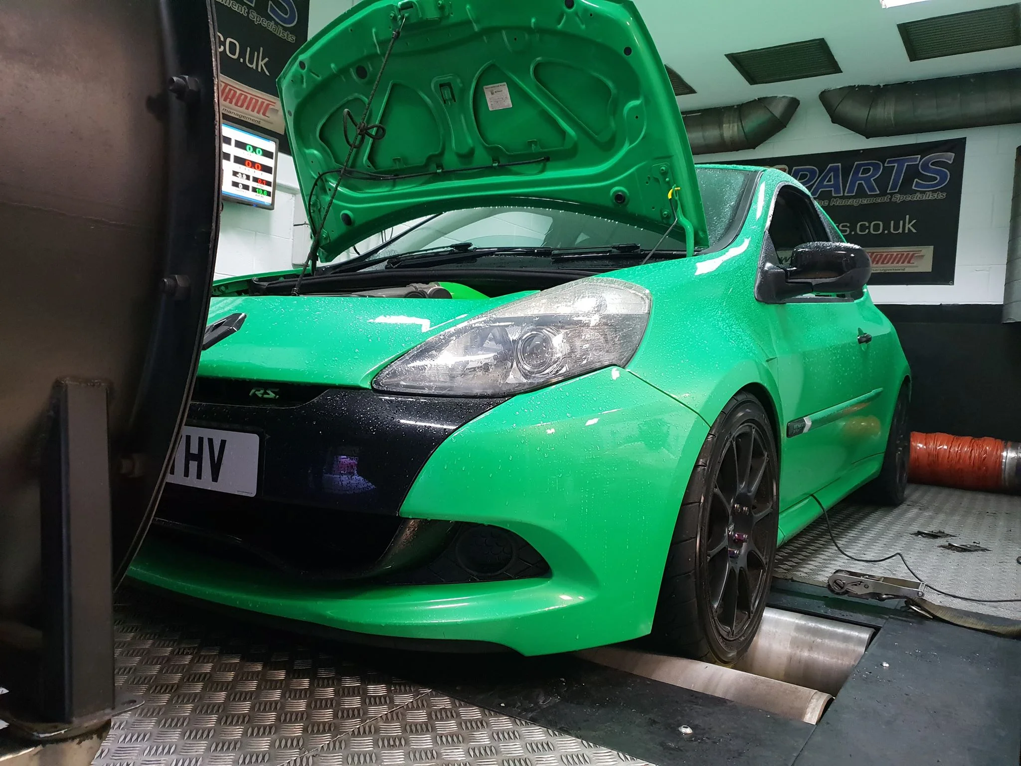

Popped into EFI parts for mapping yesterday!
Car was running lean with the predator manifold making my flat spot horrific and the car randomly being hesitant and stuttery with the ECU trying to adapt.
Everyone always wants to see the graph so here it is, standard map (black) vs retune (red), and cause people love figures; 199.8bhp and 163.4lb/ft before mapping, and 204.1bhp and 167.6lb/ft after!
