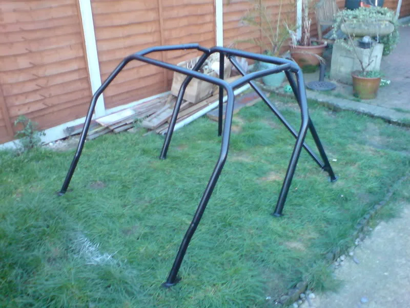

As above could you specify the exact cage? Has it got a harness bar and door bars?

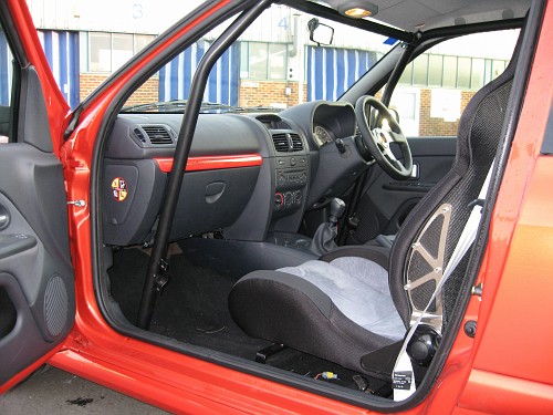

here you go chaps a pic of mine, i'm getting a harness bar done by mark fish in a few weeks time...
OMP according to what he posted above.

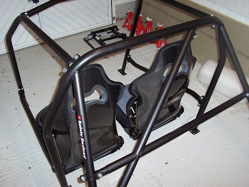

Mark Fish Motorsport can provide a SAfety DEvices cage that allows you to run the full interior.
Excellent! Will probably be going for the Safety Devices one.

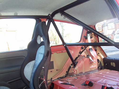

fmp's cage is in my clio now!
take it all out for easy fitting, leave the dash in then put all the interior back in,
Fully interior is back in now -
