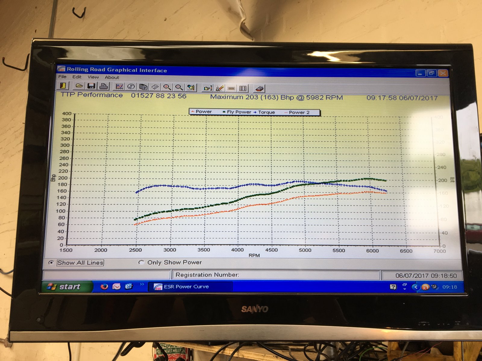

So I bought a 182 for track days and thought before I start spending money on it I'll stick it on the rolling road see what it's making...
The car to my knowledge just has a decat and full miltek system.
It rolled 203 Bhp
I'm not sure what's actually average and where it should be? I've been told to be pushing 200bhp in a clio 172/182 is where the ITB's and cams etc are so?

If the car has just got what you say, it won't be 203. If it is then you need a thread (sticky) just for your car.

This is why I'm saying it may have had previous stuff done then perhaps.. if it's that rare/ridiculous to get near the dyno run I did with what I have on it.. ‍♀️

Don't wish to piss on your chips but I have seen many 1*2s on rollers and with just those mods you will be nowhere near 200 ! did he give you a wheel figure that will be more accurate and if it makes more than 150 atw that's a great result .

Am I reading the graph right?
It's making 180-200lb/ft torque through a good deal of the rev range???

Its more than 20%...
If we assume 15% then the figure is actually 187bhp which is a little more realistic.
163 vs 203 BHP
40BHP difference
20% of 200 is 40
I'm sure you see how I came to my conclusion

Yes but your conclusion is wrong because you are working the wrong way.
Whilst I see what you're getting at there (20% of 203 (162.4 to be precise) as apposed to 120% of 163 (195.6 to be precise))
My point still stands that it's a grossly over inflated figure for a transmission loss on a FWD car. You're just being pedantic and trying to make it appear that i have an inferior intellectual capacity vs yourself, over a minor approximation.

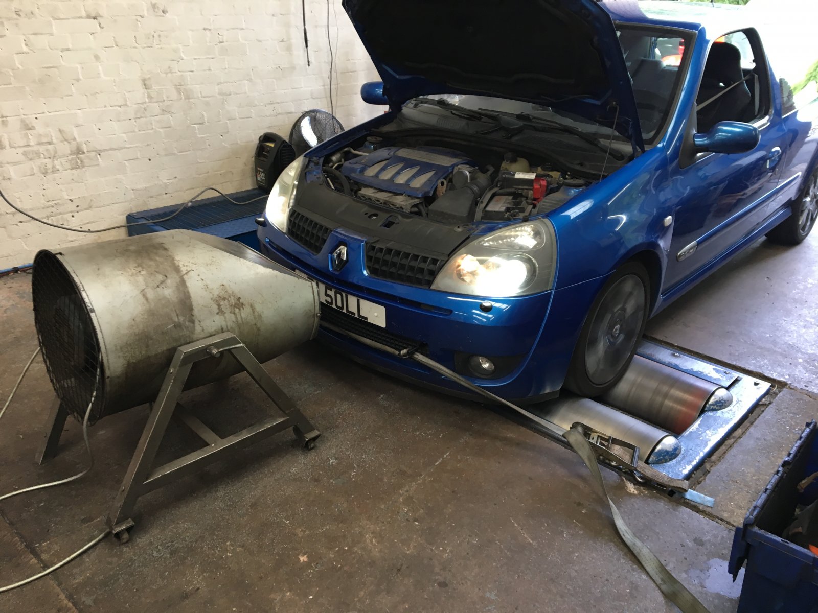

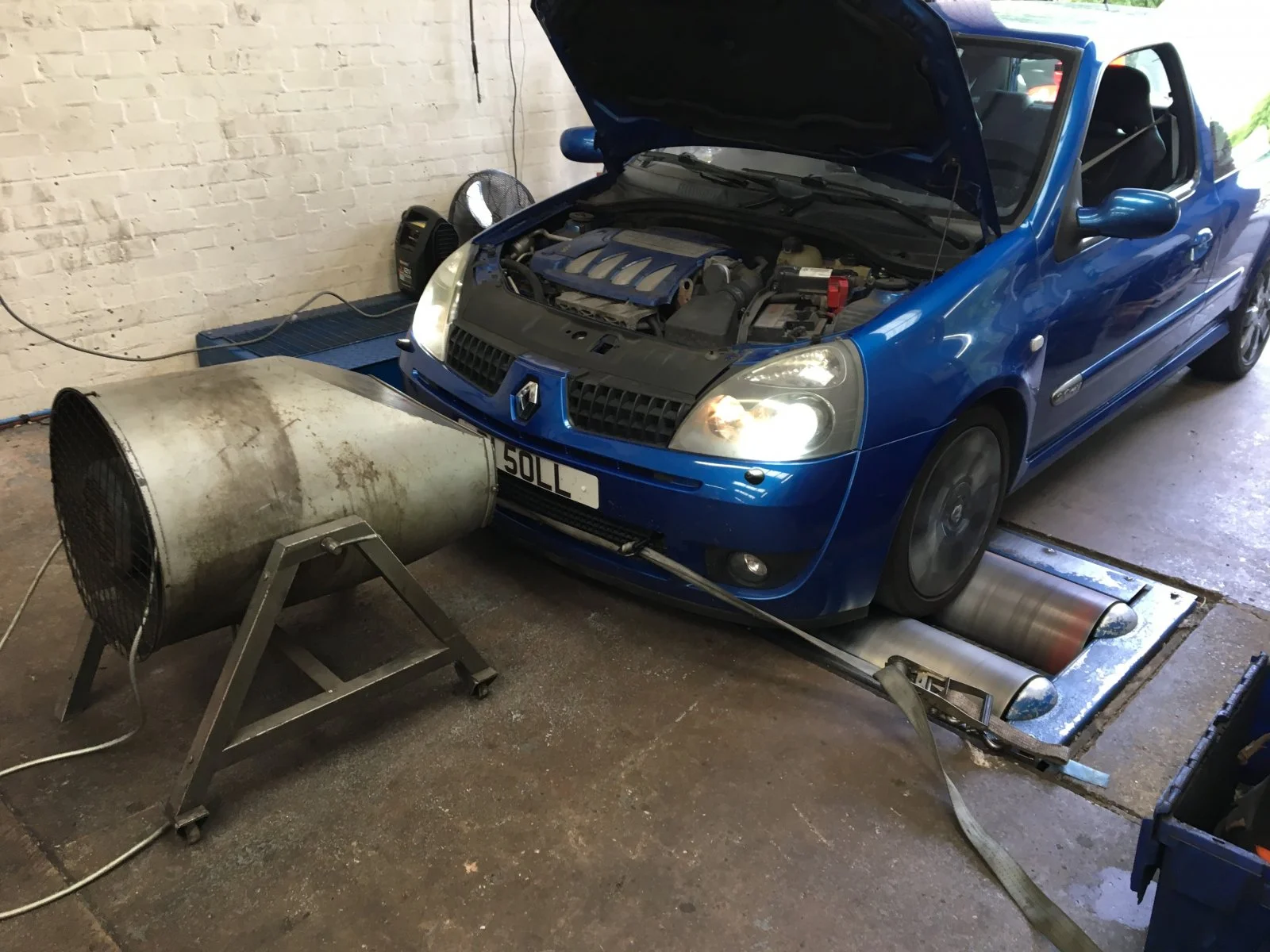

only just looked at the pics and i don't know what's worse, the way it's strapped down or the cement mixer in front of it??
