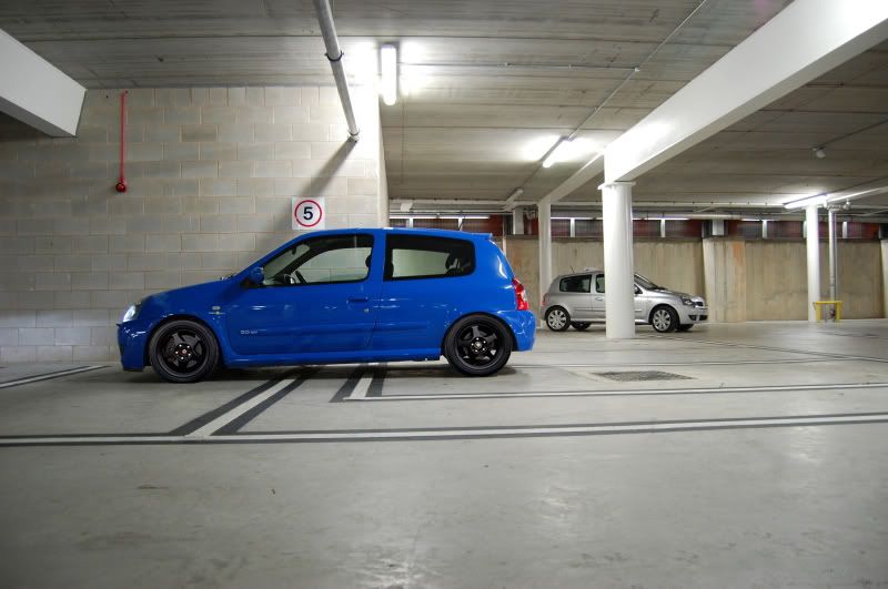

Has anyone seen these on a Clio before?
http://www.rotawheels.com/torque.php
They appear to come in the right fitment I think (16 / 4x100), and are pretty light (about 6kg I think)
Thoughts?
Rota wheels do come in the right fitment (16" and 4x100), they also do ET45 offset which is correct for the 182, but not sure what you'll need for the 172. Though from my experience with Rota Slipstreams says that they need spigot rings to fit properly as the centre bore will be slightly too large (make sure they are supplied with the wheels if you go this route) and I had issues with rear caliper clearance. This can be easily fixed with spacers though and may not even be required with this style. IMO I think they're a little to Honda JDM for me though.
