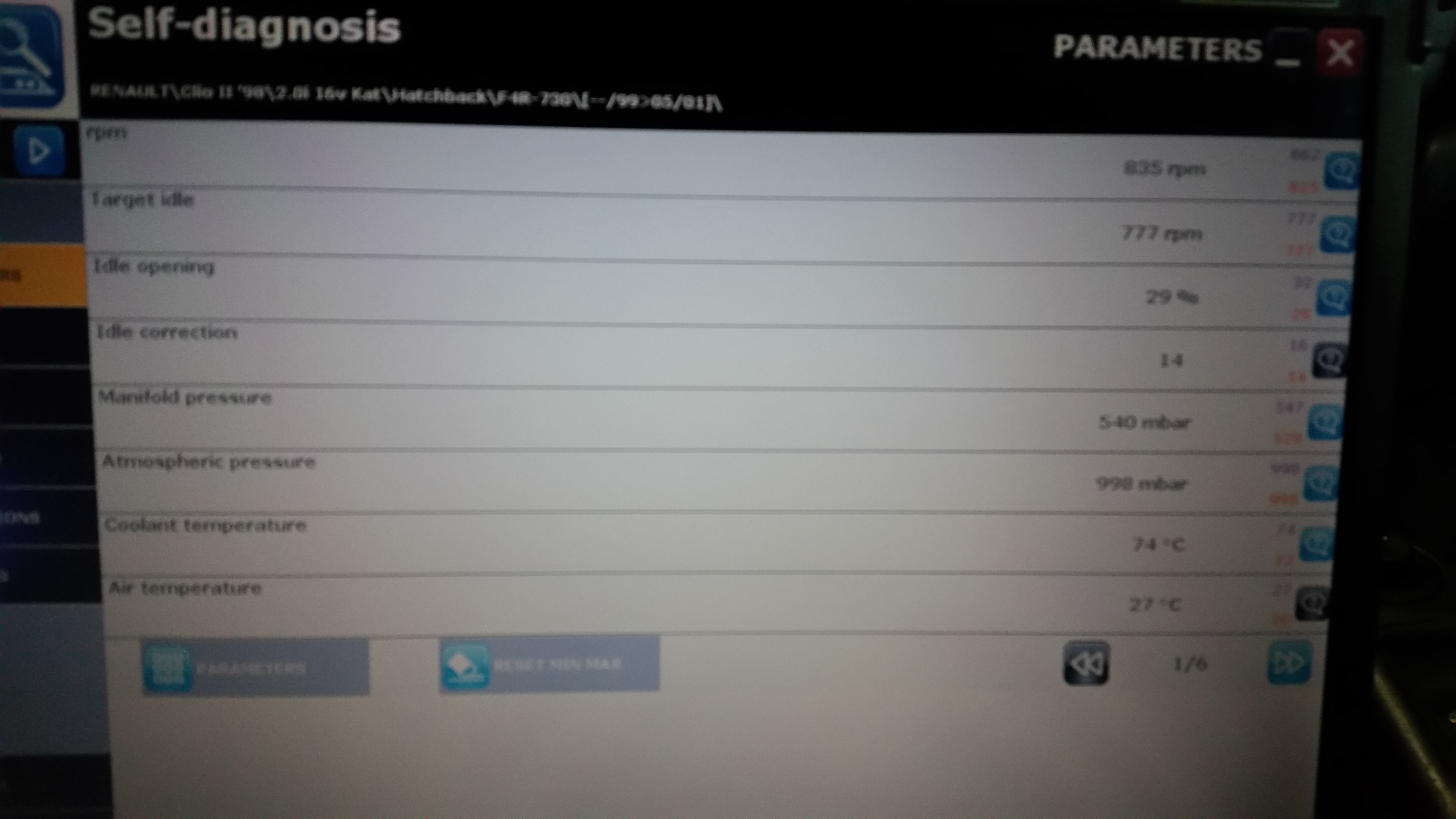

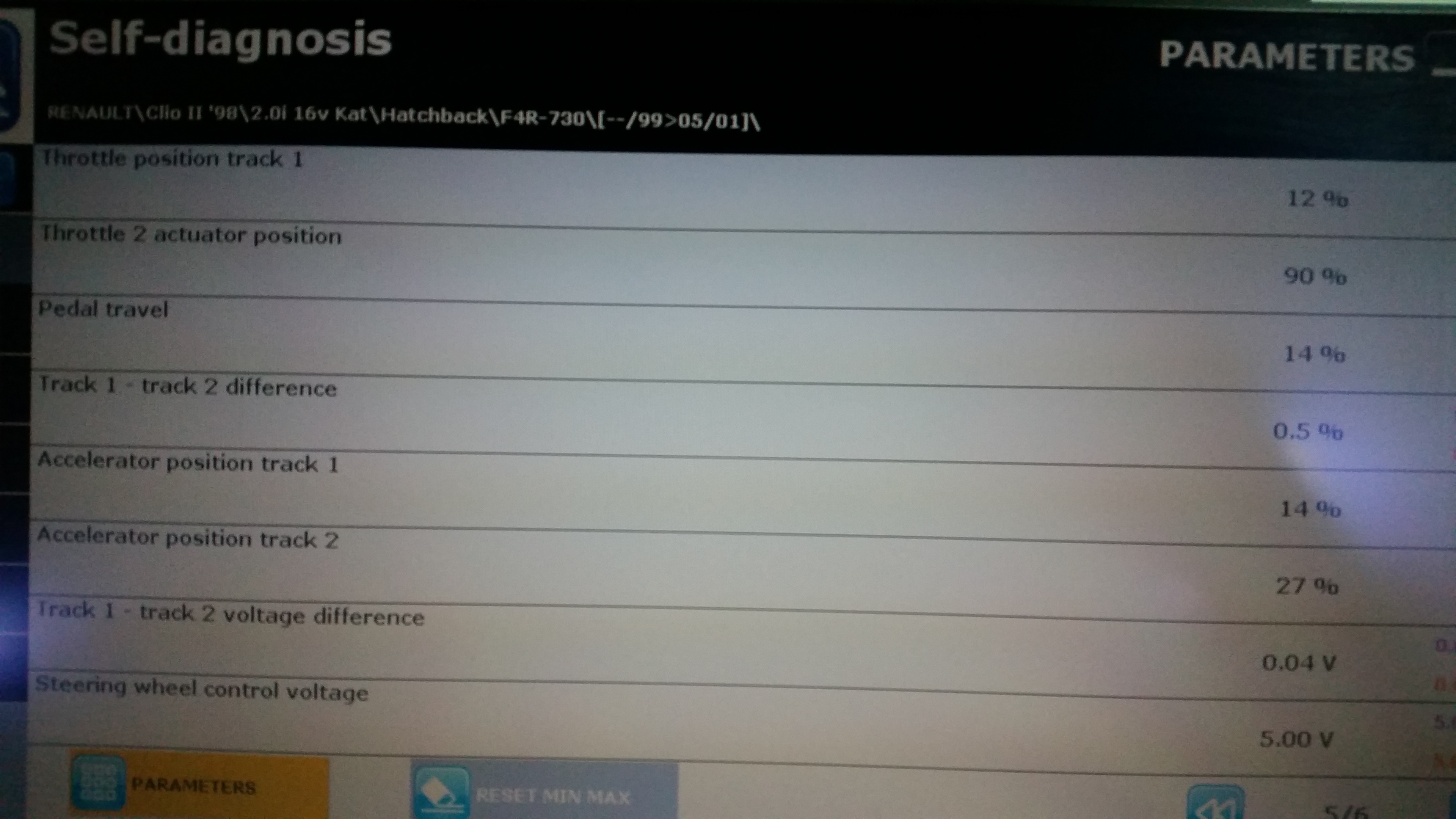

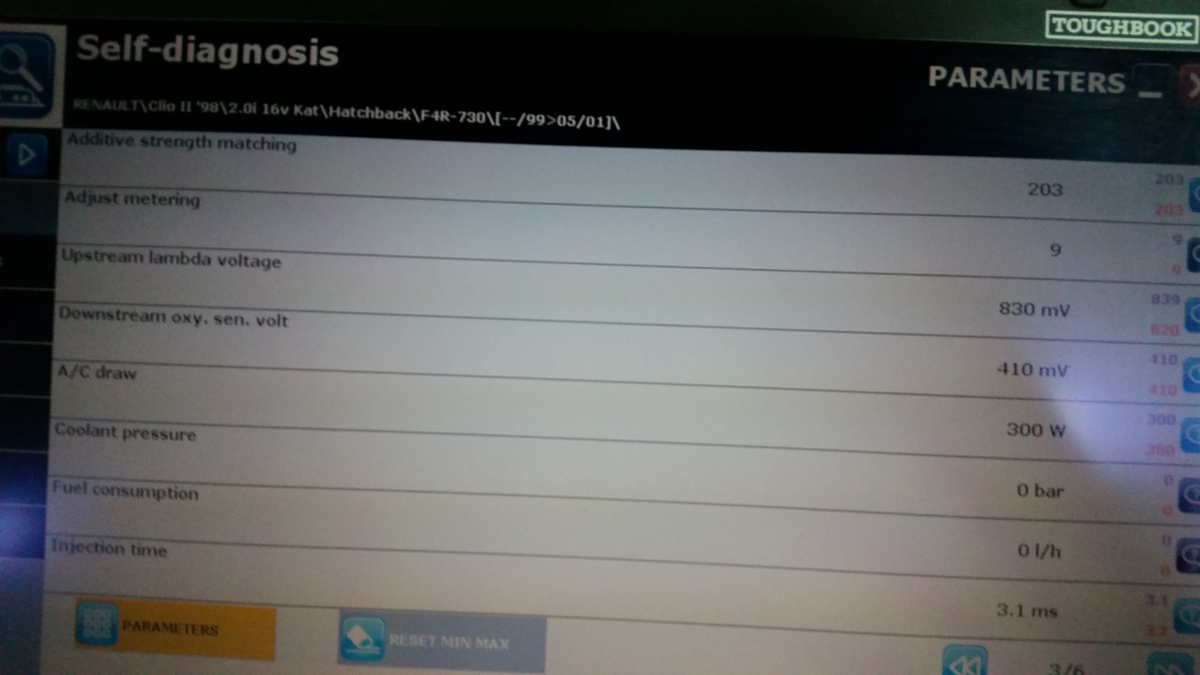

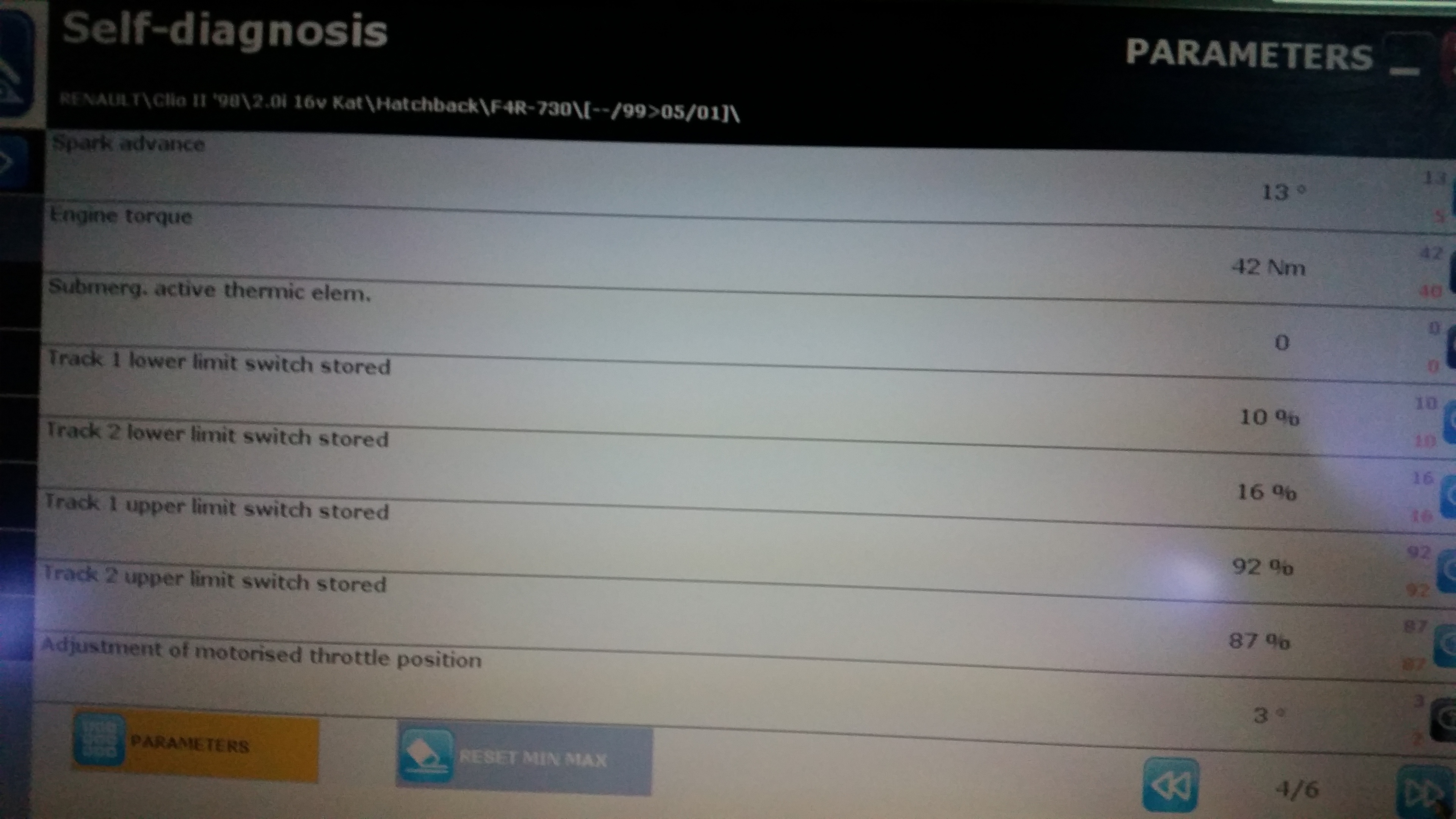

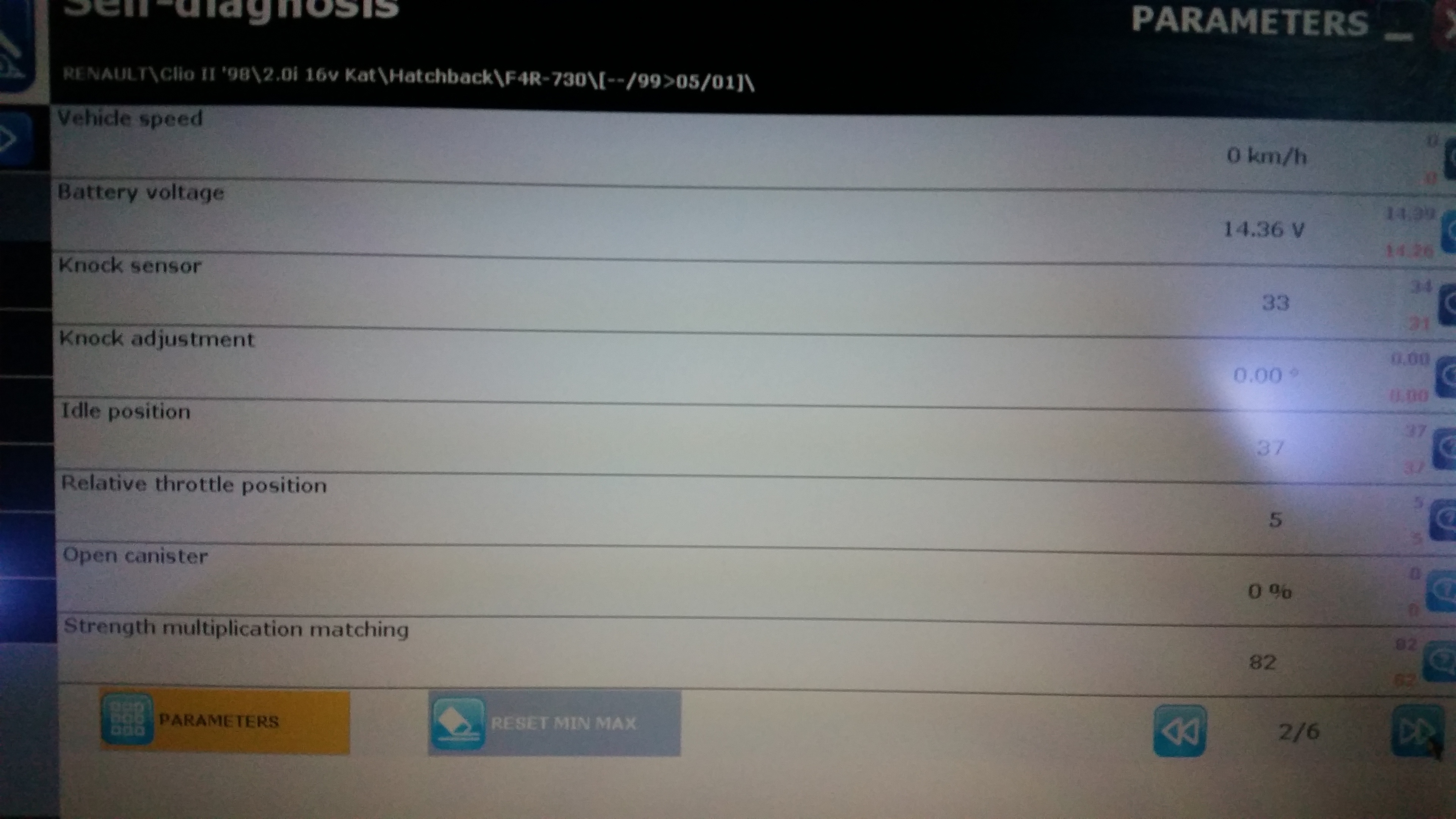

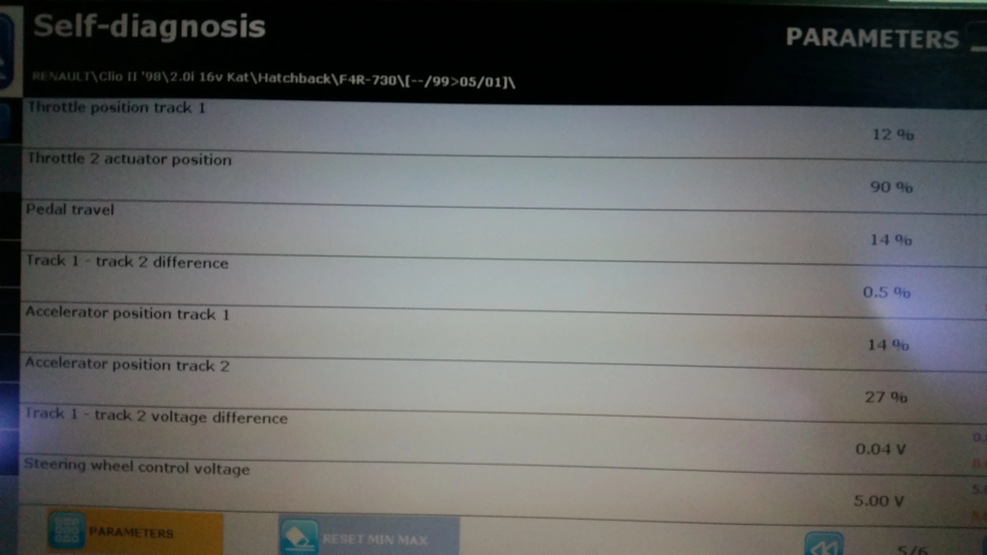

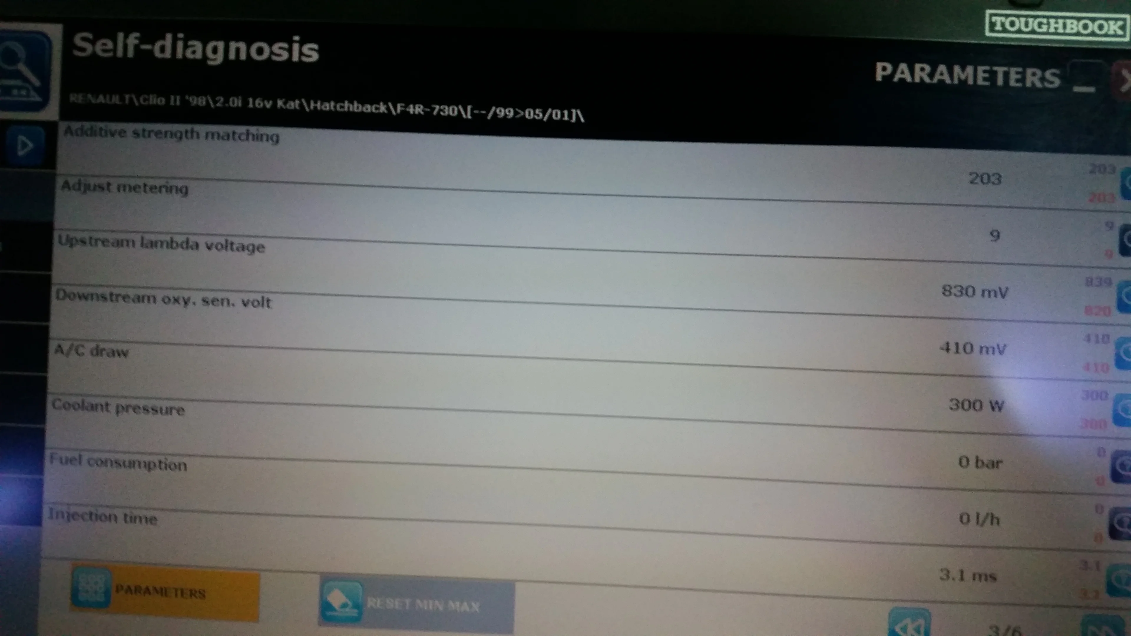

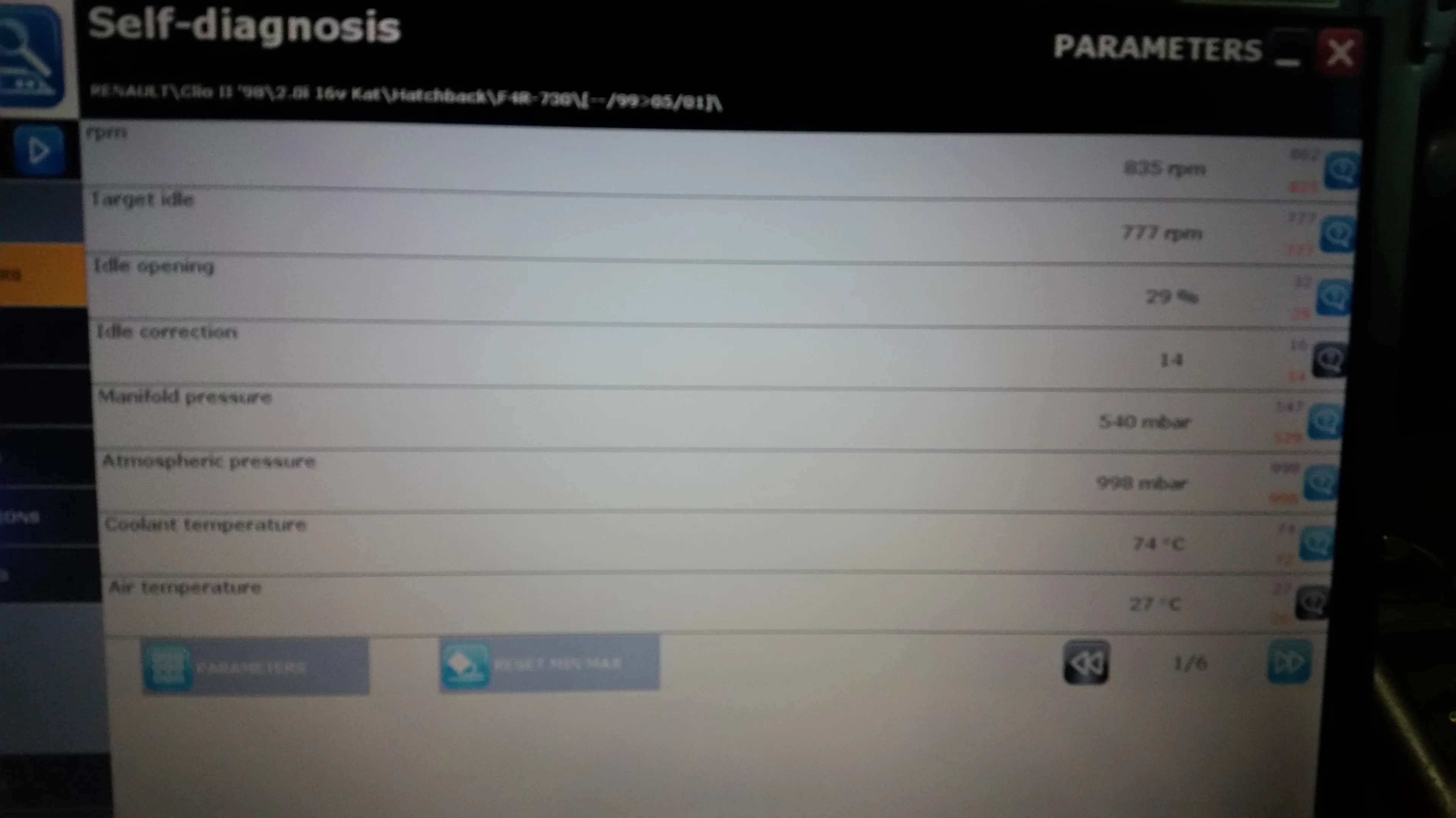

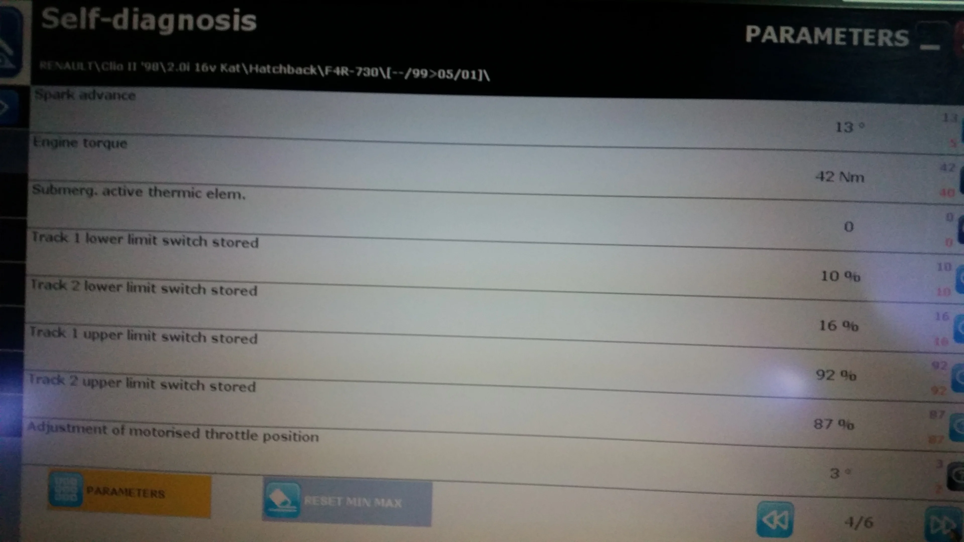

here are my parameters on tickover, i would greatly appreciate if anyone could pick out any issues in the readings as they seem fine to me.
