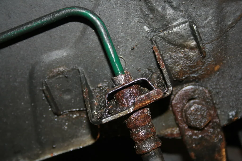

Rounded off Brake Line....
Using proper brake line spanner.....im stuck now, cant get it off to get new line on!
tried mole grips, pipe wrench, penetrating fluid.....how can i get this off? i need the car on the road!!

was also thinking there's no way you'd not get that off with mole grips - it's only a small union and, even if it is seized, there can't be much torque required to undo it.
only potential problem with mole grips is that it looks as though you've not much room to be turning them within the confines of that bracket

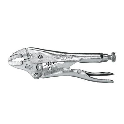

need a set of irvin vice grips will do it no messin. if you still need a set come monday il lend you mine from work
