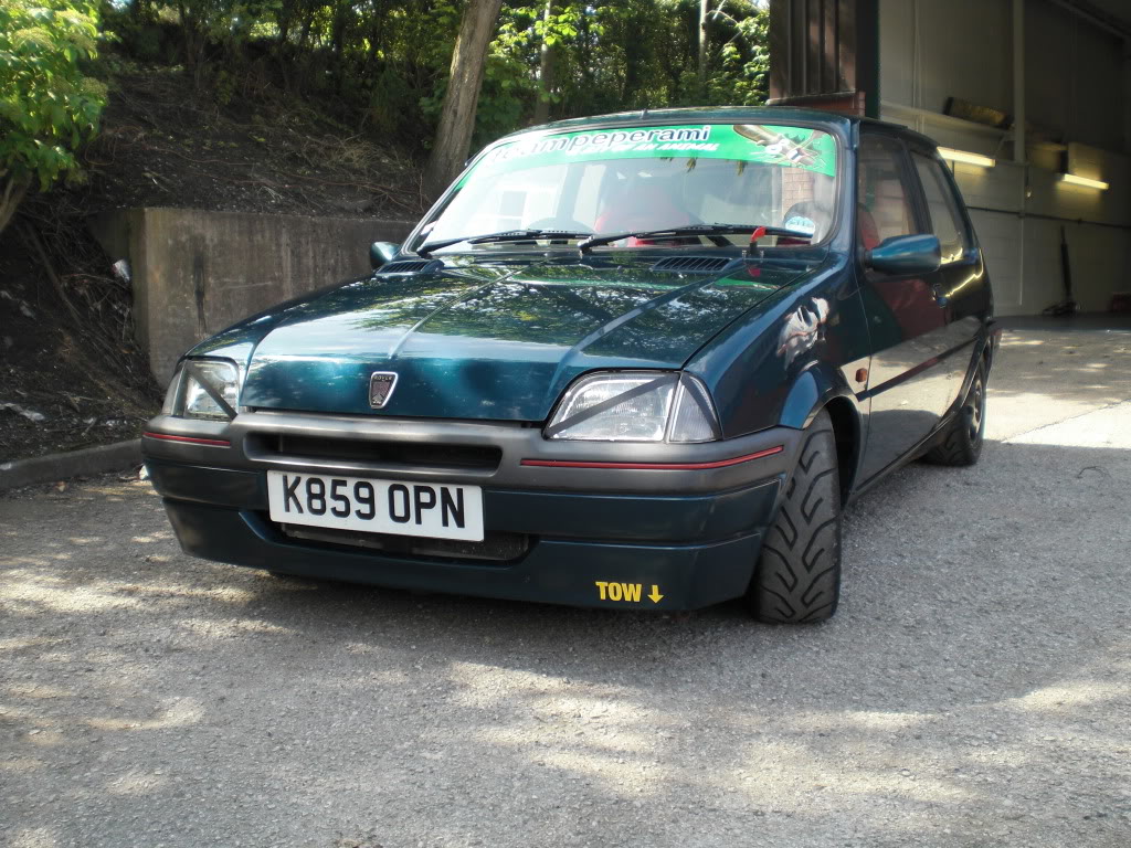

Yeah, it Belongs to one of the guys I work with at Mini Spares, it's a bit of a mad max creation, a 1997 Rover Metro, with an Integra Type R engine...

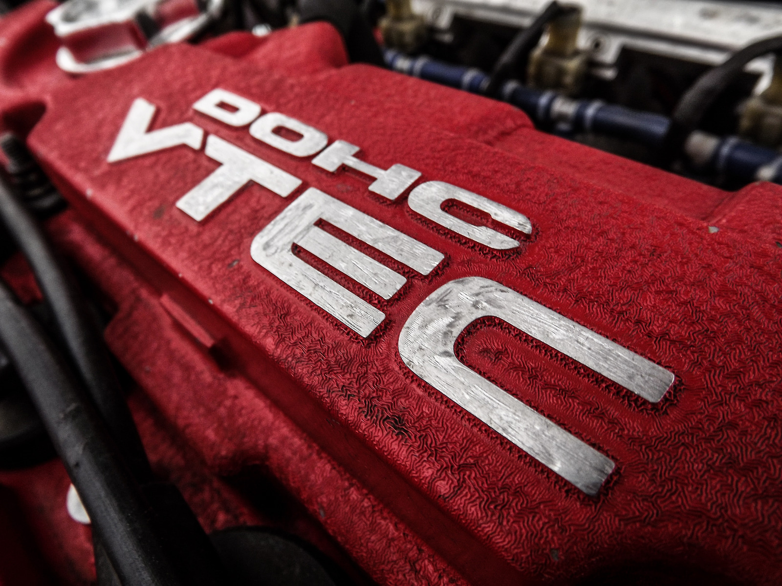

Lol, this is my car, I have a 182 as a daily, the Metro rapes it in a straight line, dyno'd at 203bhp and 155lbft. The brakes/tyres/suspension all been sorted too. It's just something I built to have fun in and not care if it gets bashed a bit.

Rear arch = f**ked.
This shell will be toast in a couple of months without some proper welding.
If you've gone to the effort to drop that kind of block in it, you could atleast extend the rear sunroof drainage pipes.
Why rover thought them finishing inside the rear arch skins was a good idea i'll never know. :cry:
Be interested to know what suspension set-up it's running though.
T3gav
Rear arch = f**ked.
Gee this is why I don't post much on here, the shell is solid hence why it was chosen for the engine swap, the previous owner welded a new arch in and obviously messed the prep up as the paint has blistered there, It's being fixed soon.

Thanks Chip, it does look slow but believe me it goes ok, power to weight is 238, here's a list of similar cars power to weight:
Nissan 300ZX - (180)
Mitsubishi Evo VIII - (199)
Audi RS2 - (201)
Subaru Impreza WRX STi - (207)
Vauxhall VX220 Turbo - (215)
Lotus Elise R - (223)

9/10 times, if the outer arch is rusting, the inner arch was long gone.
If it is genuinely a prep issue, and it is just the outer gone due to a paint issue, then fair enough, but that's very rarely the case.
What suspension setup is it running? Coilies up front and individualised hydros at the rear?
T3gav
It has Watsons coil spring replacement units up front with adjustable dampers, rear is individualised and I have modified new radius arms to accept dampers/coilovers. Has front and rear anti roll bars, poly bushed MGF lower arms (increases camber slightly) but I have a rose jointed set being made to get some more castor. I prefer it to the Clio tbh, the Clio feels more vague due to the power steering imo.
