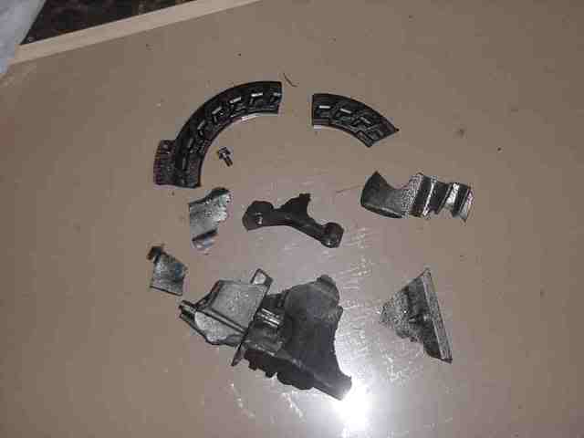

ive still got the damaged gear box and all the parts that was inside
i have paid 400£ only for revision
in turkey the parts are very expensive
and you cant find the spare parts or rs
may be only 50 172's are in turkey
we cant find a second hand input shaft:(
i am driving the car for know because we opened 6 times the gearbox but cant fix the little ticky sound on idle
we think it ws from input shaft and may be its lower bearing
we check it on cnc and turned the input shaft 2000 tr/min
there was a %4-5 shaking on comperator
if you check yours may be i can thing to buy

ok look at this it is in the circle and it is a whole part
the upper bearing is on it
but the bearing which is under it is not there in the picture
there must be a renault number on it if you look at that we can match it
because there are lots of versions of it
