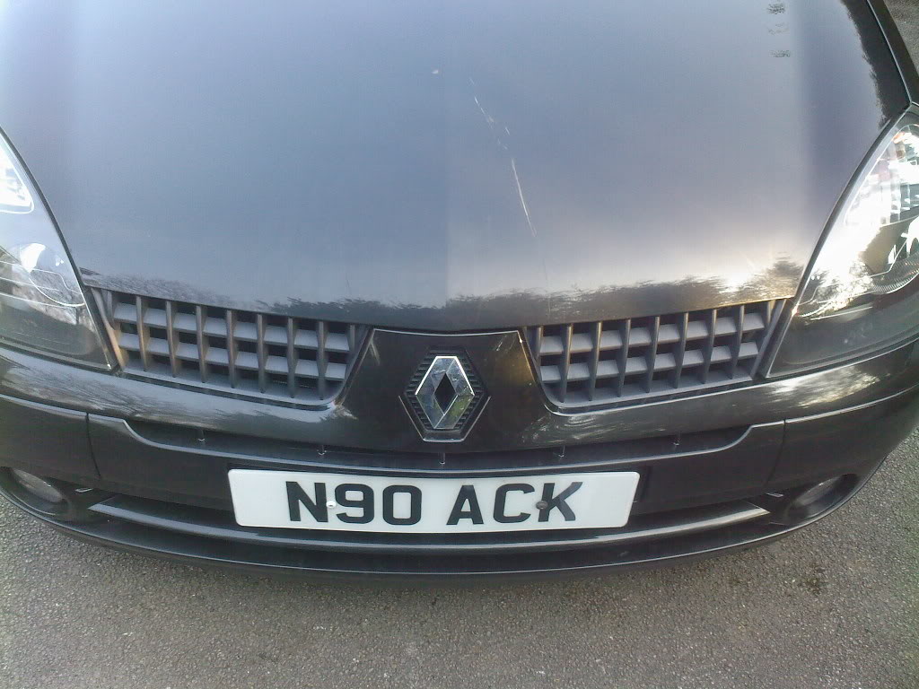

RS Grill fitted pics.
Car  A white and black one
Before
After
Loads better, need to get rid of those blue lights at the front though (in the old pic)
looks nice mate got mine not long ago as well makes such an improvment to the cars look :D
