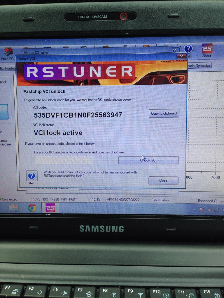

As title guys, apologies for the thread. I've done all the research I can believe me.
I will attach some atrocious photos of my netbook screen from my iPhone to illustrate my problem, which is;
When I go into 'about' on the RS Tuner software I'm supposed to get a 25 digit code to send off to Henk with the order. However all I get is a 22 digit code. I have emailed him but thought I'd pop a thread up because 1: impatient & 2: someone might have an answer.

Only 25 digit codes are processed, if not the interface is outdated.
Hope this answers your questions,
Kind Regards Henk

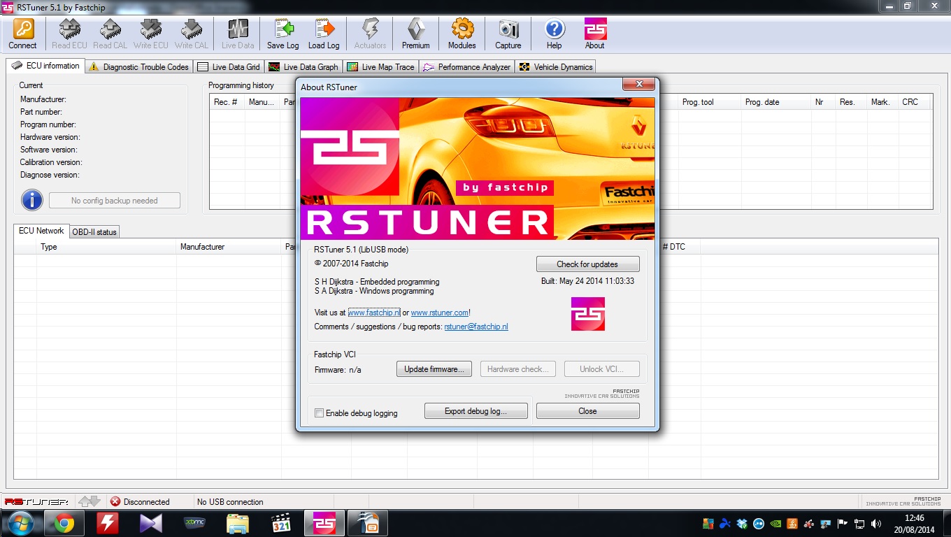

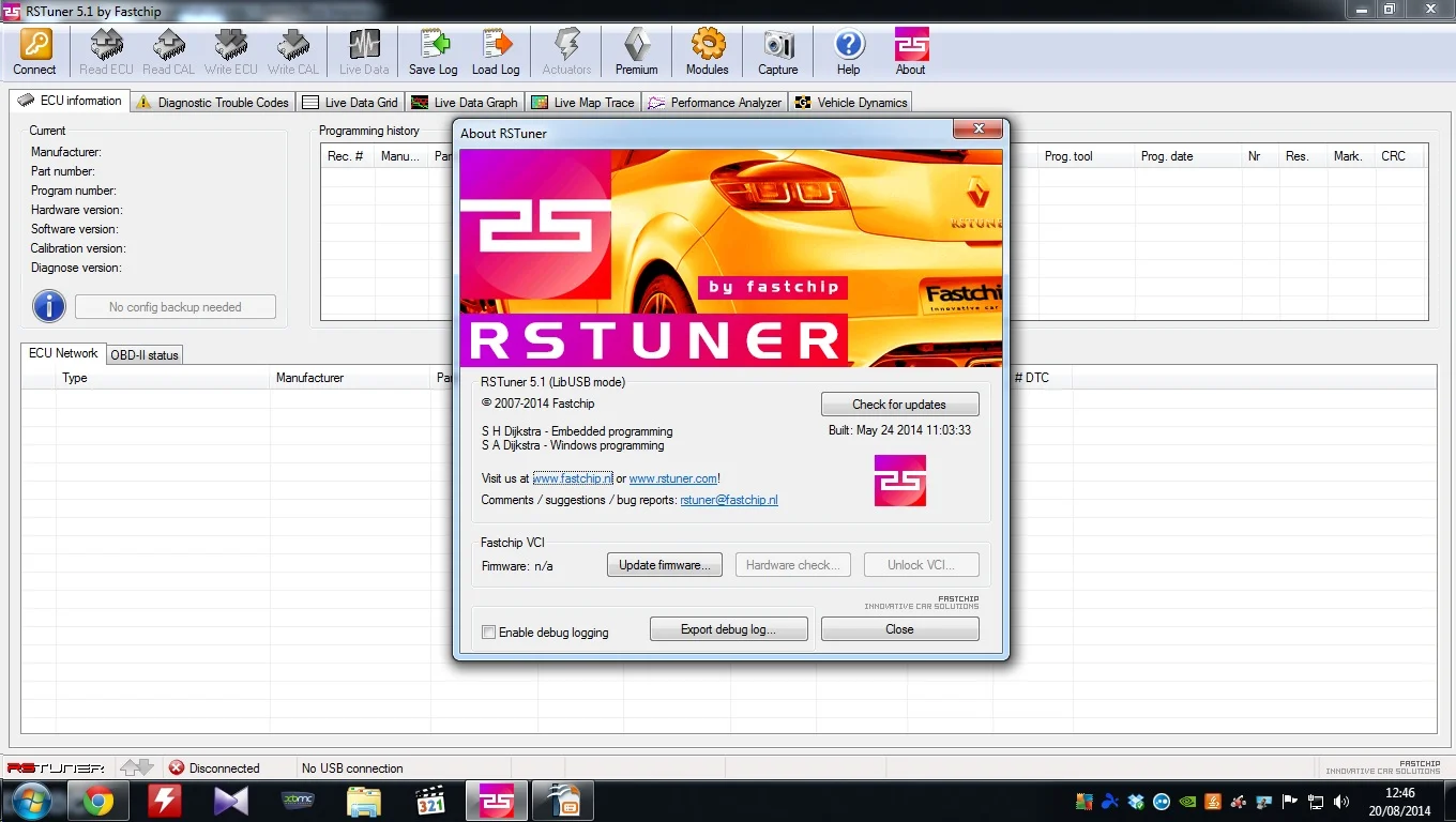

When I click 'about' i get this screen
see at the bottom where it says update 'fastchip vci' and a button 'update firmware'. That i reckon is what you be looking for!
You will need to download the latest firmware from the fastchip website which is in the downloads section.
Should have you sorted i will send you my fee.

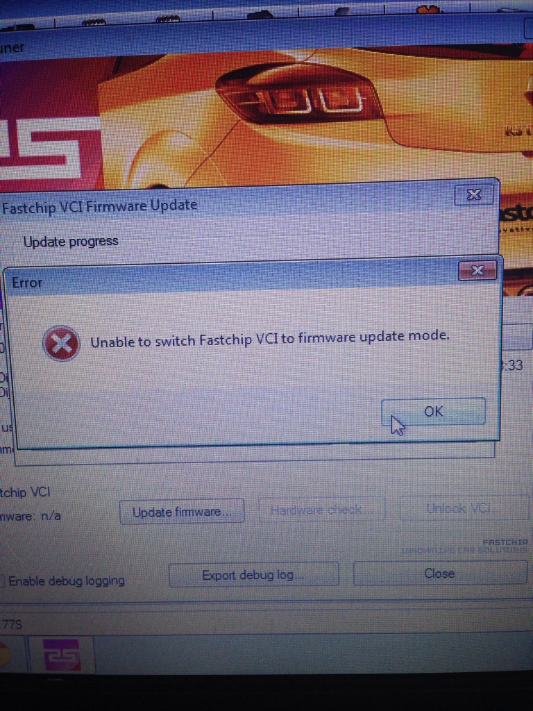

Just downloaded the update from the site, clicked firmware update & loaded the file, then got this error message
I've read things about versions of windows not working with it. I'm using my brothers netbook rather than a proper laptop. Gonna pop round sisters & try it on hers.

These boxes are locked to the car they're used with initially.
If you've brought it 2nd hand from somebody and they've already used it for programming their own car then you'll need an unlock code from Fastchip. That's my understanding of the official process and your situation anyway :)
Although, I might be misunderstanding the circumstances..
  AB182, Audi A5 3.0
that's not his situation. He is trying to buy the unlock code but cant as the firmware is outdated on the VCI. The older VCI's are NOT updatable via the software and needs to be sent back to fastchip as advised. I think update via software started somewhere after fw181 iirc. To give you an idea how out of date it is, mine is on fw189s1-100.
You may however still be able to map your car provided you are using the older version of the software and have the old 'unlocked' version of the maps + get henk to do an old style unlock (bit of a long shot on that last bit mind you). Make sure you make a full backup first in case it goes wrong.
