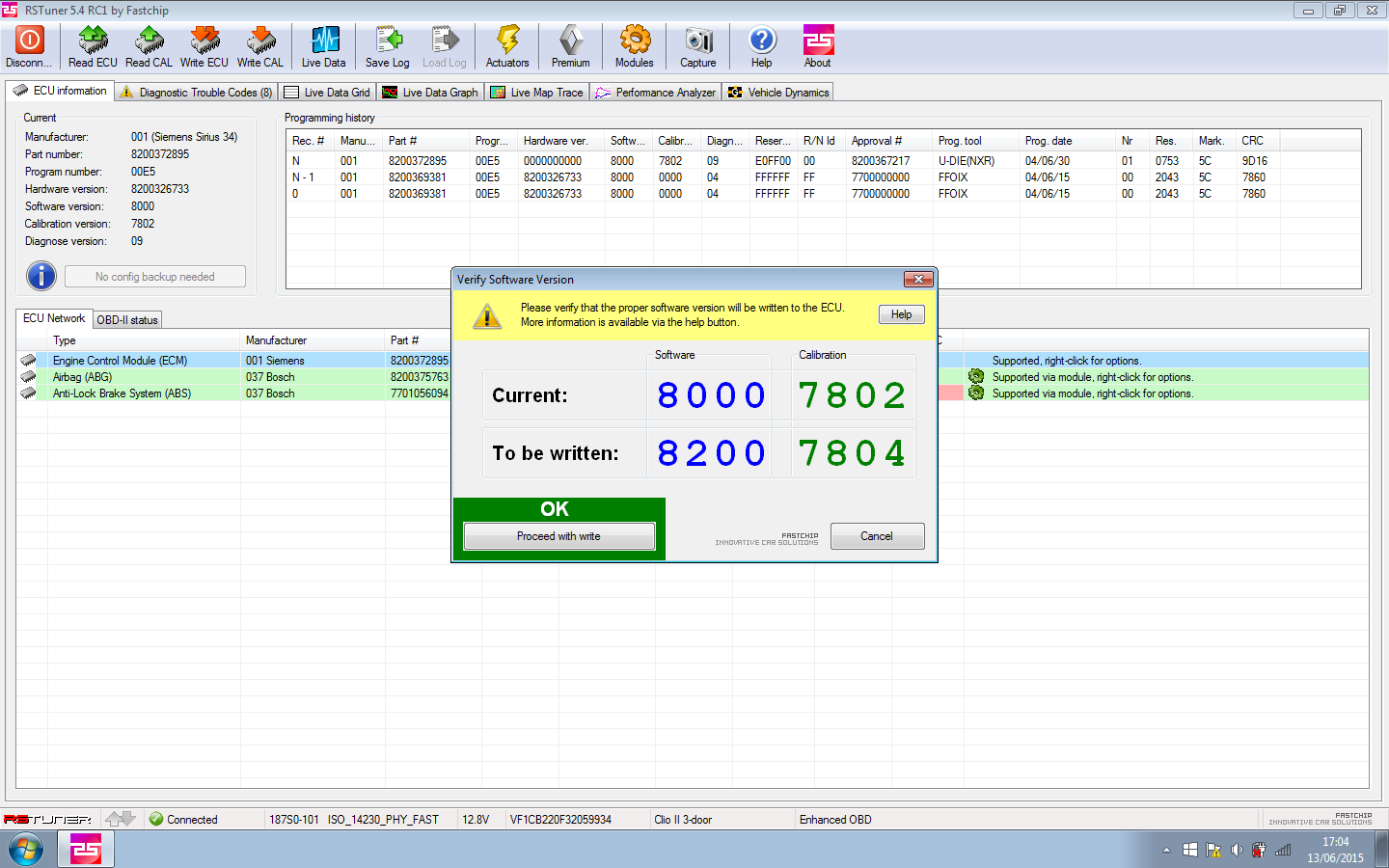

However when I click write cal this message is appearing...
  Yozza'd Titanium 182
Kaktus
  182 FF
You need to update the ECU software before you can apply the map (after backing up though). Can't remember the exact steps from memory, will see if I can find original email and post up the instructions

First update your ECU software to _8200_7804.rst.
Takes about 30 minutes. Recharge Battery before next step.
Next apply the RON 97/98 performance .cal, which requires RON 97 or higher quality fuel.

yes and I have done the following
"About" (entered 8 digit code)
"Read cal" (copied the first link) - rstuner_8000_bla bla bla
The green bar appeard for about 2 mins....
Am I correct in thinking that I now need to
"Write cal" with the same link and then...
"Write ecu" with

Im up to this bit.... I have backed up my data on read cal and read ecu....
Is this a safe calibration
