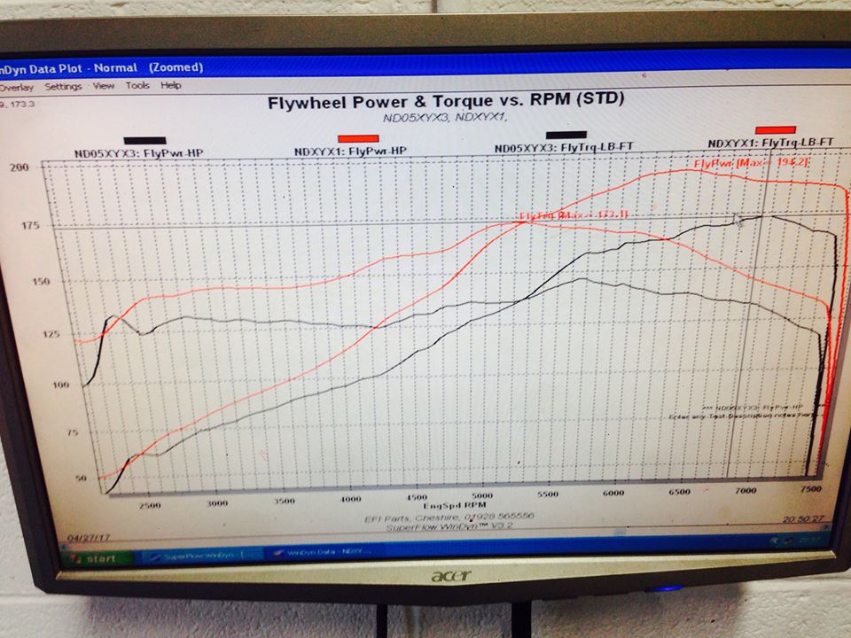

  dan's cast offs.
not a graph, just a pic sorry. the black was before cams and matched inlets etc. car also running epas.

Very nice, was this graph with standard 172 timing? or optimised secret 197 timing?
Thanks
It's my super duper secret secret timing, even more secret than the normal secret one:tongueclosed:

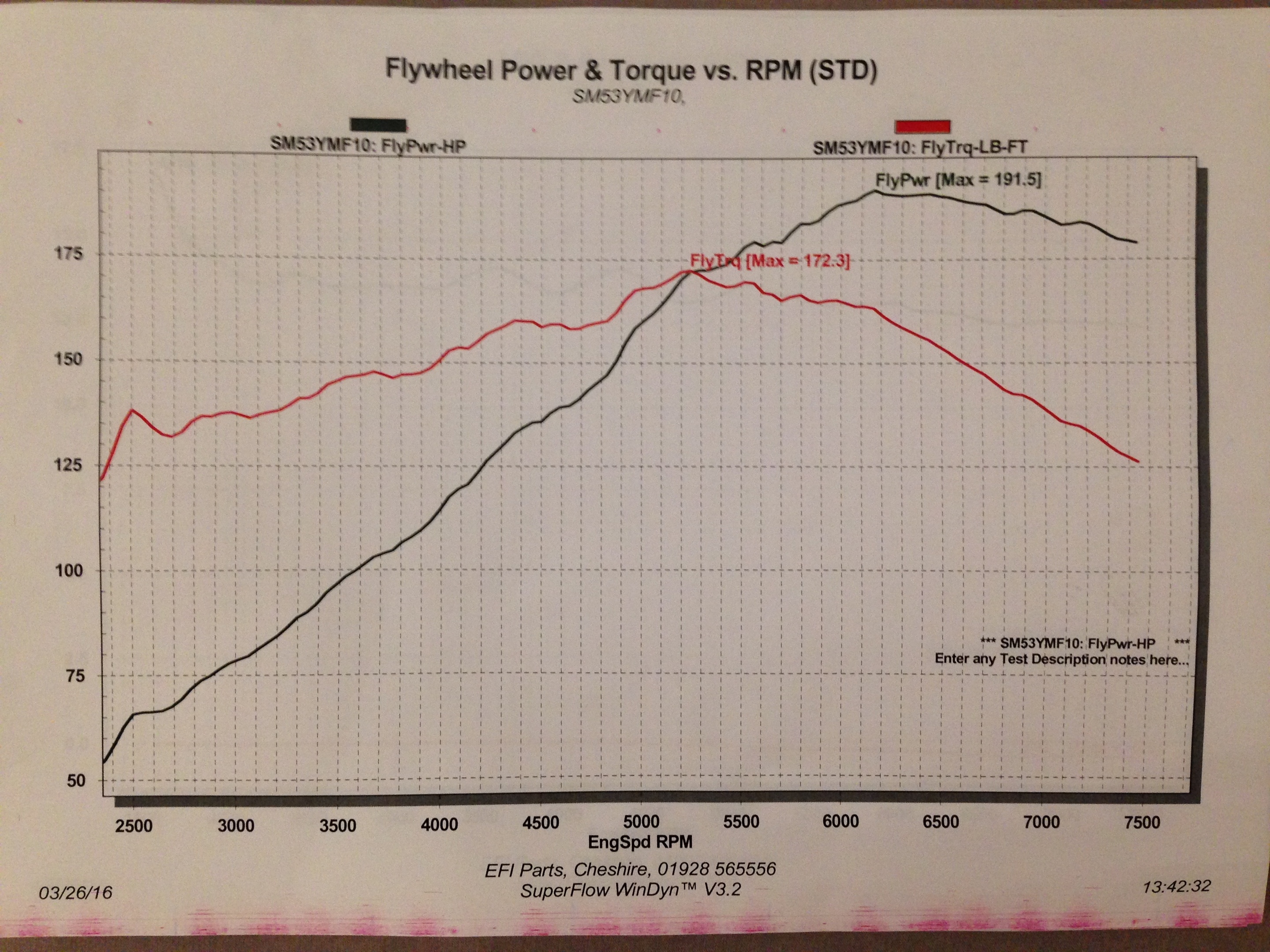

  S/C Iceberg 172 Cup
This was mine when I was running n/a with the 197 cams and matched inlets. Drove brilliantly!
Seems to be the norm this sort of power/torque with the cams etc. Get it mapped at EFI if you can too
