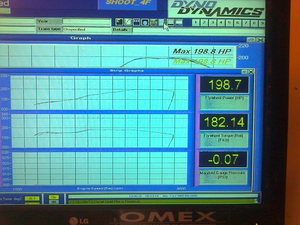

FYI Engine Dynamics swapped my injectors for 197 items when mapping my car with 421catcams as the 182 items were at 95% duty, im running matched inlets, ktec induction kit, janspeed supersport exhaust and at the time a de-cat.

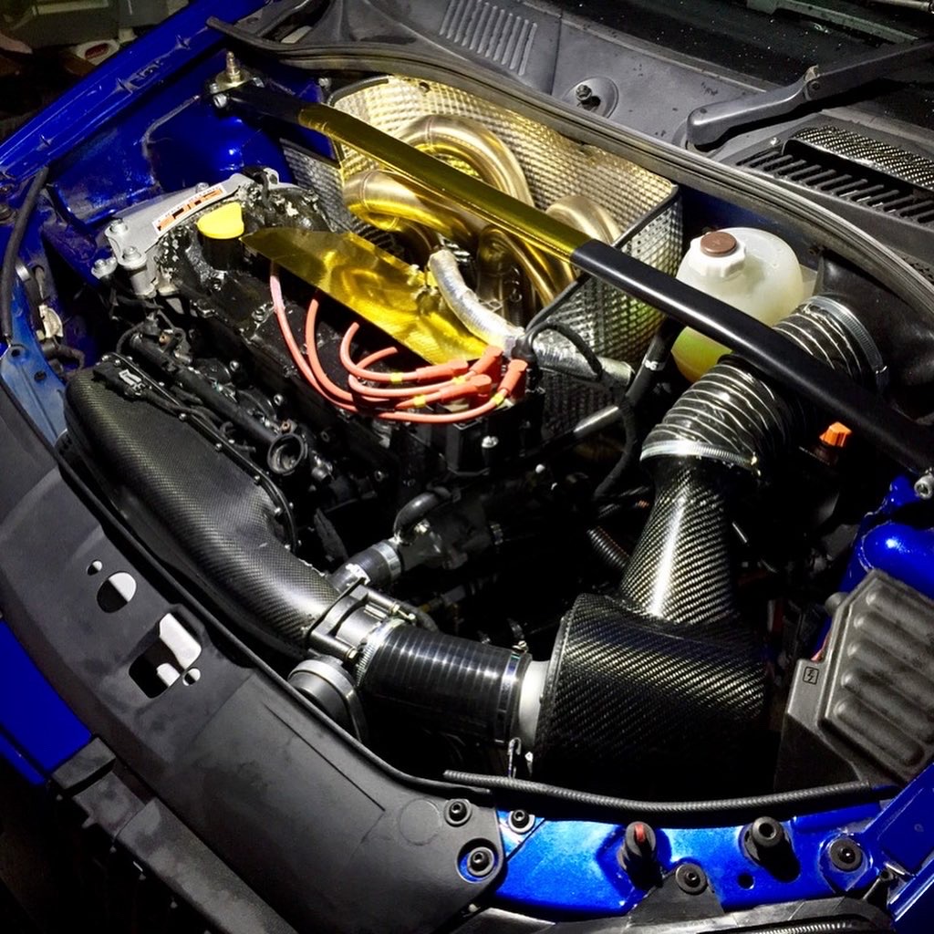

I wish I stayed on the RS2 manifold and grpN timing. Drivability was spot on, simple and reliable.
Was your engine untouched, just bolt ons? That's pretty much the spec I'm looking at but with 438s instead of group n timing. Did you have different injectors and what bhp/torque were you getting?
Also what air box is that?

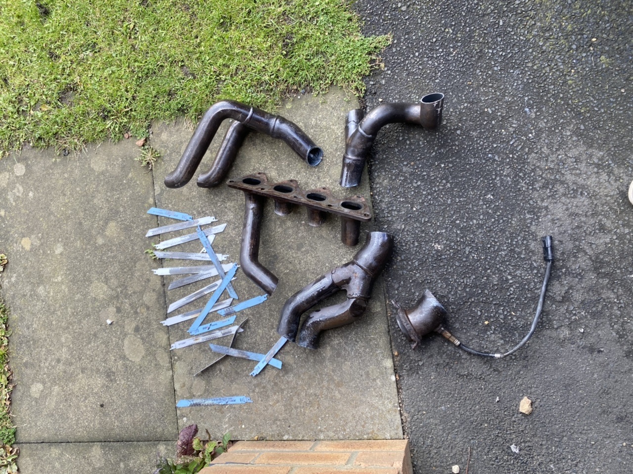

the 182 manifold comes out no bother with both engine and subframe in situ. It’s quite a recip blade heavy process though 🤣

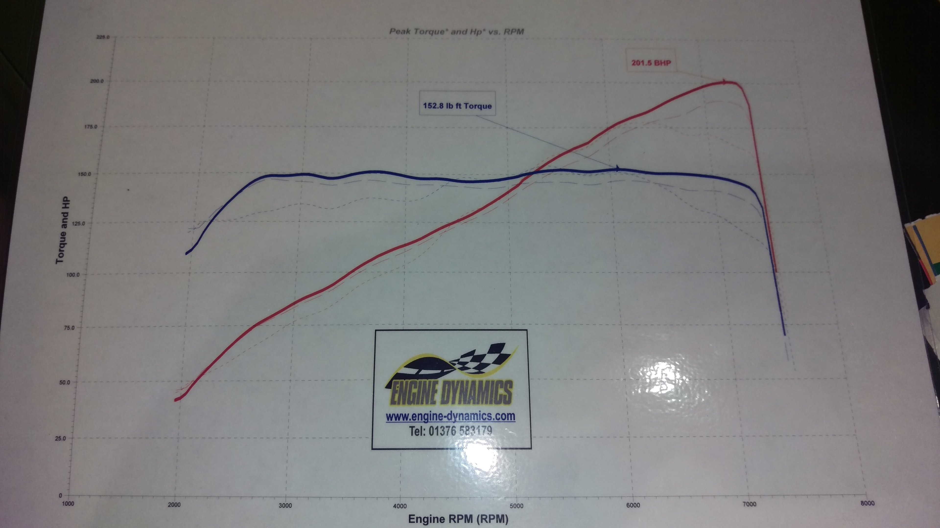

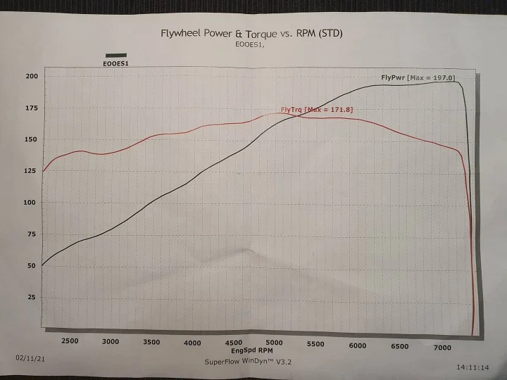

Torque curve
fair enough. shorter intake runners will reduce mid range torque and that doesn't bode well with the 438 cams on standard timing marks, re-time them to 421 cam timing for a better match with something like a RS2.
personally id be going itb's and well ported head
Torque curve on RS2 and group N looks spot on. itb's would do nothing for low/mid range torque lol
You won't better that for a torque curve.

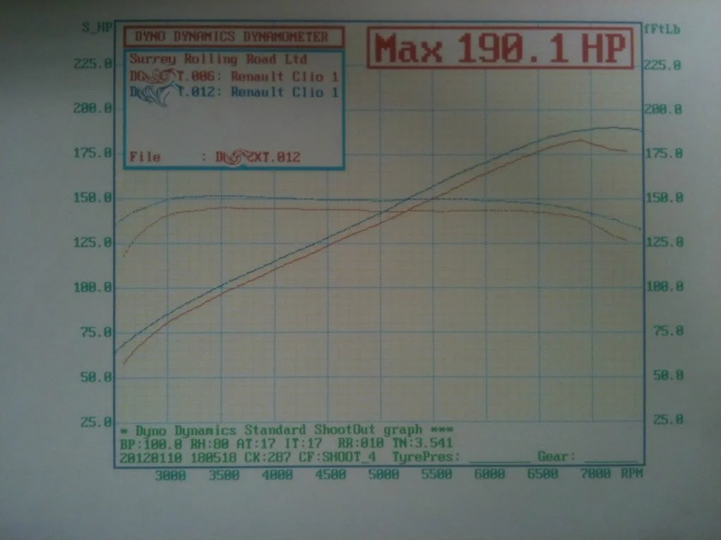

Torque curve

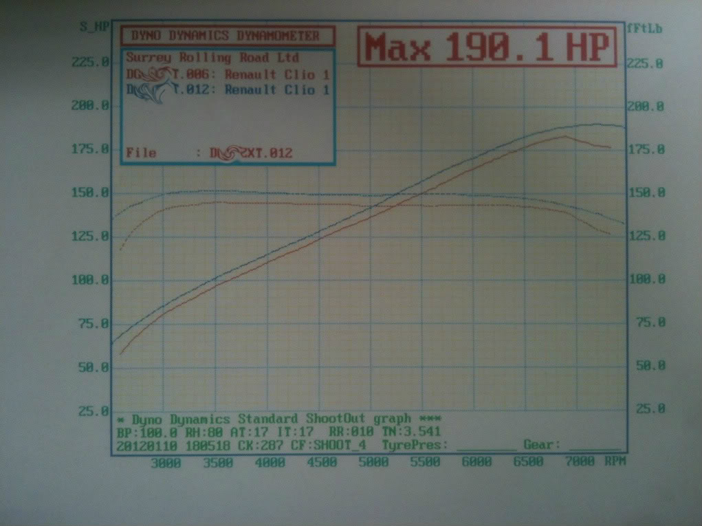

You're producing 13ft lb less than the op and only producing the same HP but at 1000rpm higher rpm
the argument towards against the RS2 is that 438's suit standard inlet manifolds as the long runner lengths work nicely with the high lift short duration of 438 timing but are nearing the upper limit of the standard inlet power wise,
by fitting the RS2 you'll loose the mid torque on 438 cams at a cost of a few hp high up the revs which due to the JC5's poor gearing isn't that useable on Hillclimbs,
The argument to fit itbs over an RS2 is the ability for further tuning potential
The RS2 torque curve is completely flat, so yes it has a little more torque than stock between 2500-300rpm but it loses out everywhere else at the gain of some bhp right at the top or the rev range. Pointless unless you're on a circuit where you're at 7k all day long. For hillclimbs & sprints, the torque right through the middle will be what makes you quicker.

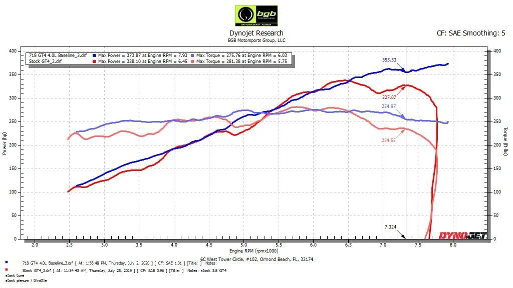

Can't talk about quality of the new ones but I'm all for a flat torque curve even if that means losing a touch of low end and mid range torque. Although looking through some of the old dyno graphs on here some cars with RS2 inlets seem to drop a load of mid range for only a touch above 6k which as you day is an odd price to pay, suspect the RS2 could have done with being longer or tuned for a lower rpm.
My M3 is basically flat from 3k to 7k. Makes for a slightly undramatic but very predictable car, also like the feeling of consistent pull right up to the limiter rather than tailing off.

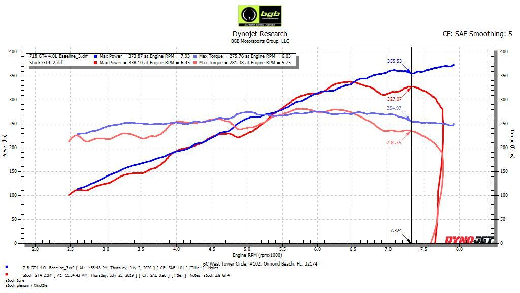

Out of interest blue line is GT4... ends up being a preference/subjective thing I guess but same is true for all the bikes I've ended up keeping - the ones which ride well and easier to ride quickly have all had a decent section of flat torque.

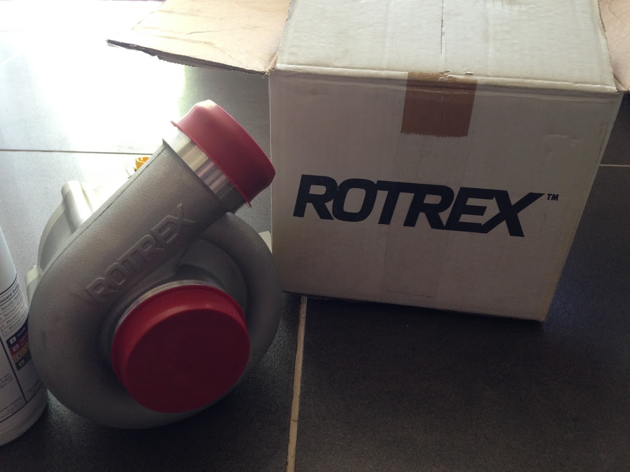

Rotrex type blowers tend to feel very N/A, a mate has one on a type R and I had a smaller one (than pictured above) on a 328i for a while and both feel/felt very natural. Weirdly they are basically the worst compromise between a turbo and an eaton type blower but they have the big advantage of fitting where most other things dont.

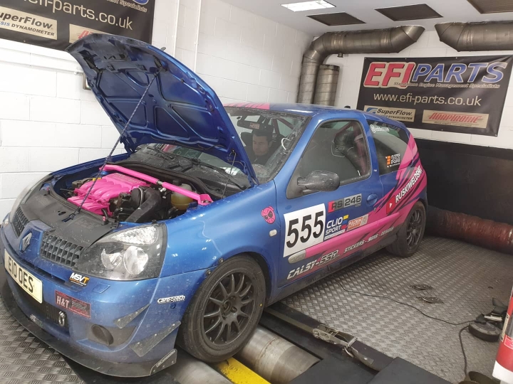

I think Will Roberts has the only Clio thats consistently beaten me up Harewood and he has ITB's, guess thats the way to go.
