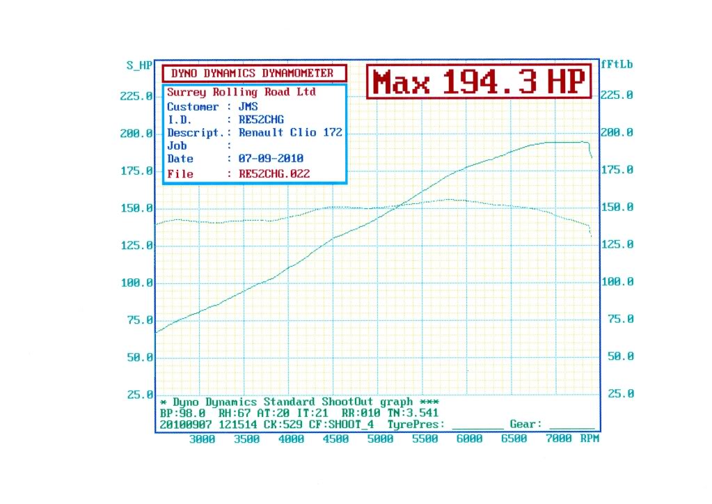

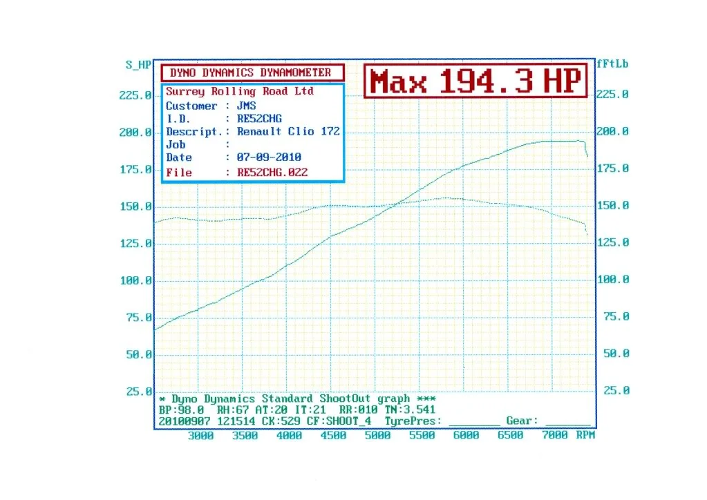

Apart from that Russian guy who made epic figures with forged setup, I've never been that impressed by any of these cam 'choices' for the RS2...
Standard cams with 50mm spacers on standard timing, I'm almost certain that with playing with the timing you could make some better figures, without spending a fortune on camshafts that loose you torque.

The standard profile is pretty decent though. The RS2 just doesn't seem to respond to wild cams as well as ITB's do Nick but you are right.
I must admit I'd like to see what mine does on Surrey's dyno as it's another respected setup.

IME Surrey is consitantly 5-10bhp higher than RST. They both seem consistant in their results which is what matters I guess.
Just a general observation. Bound to be anomalies obviously.
RST has a more up to date and comprehensive weather station or something doesn't it? But I won't pretend to understand it all.

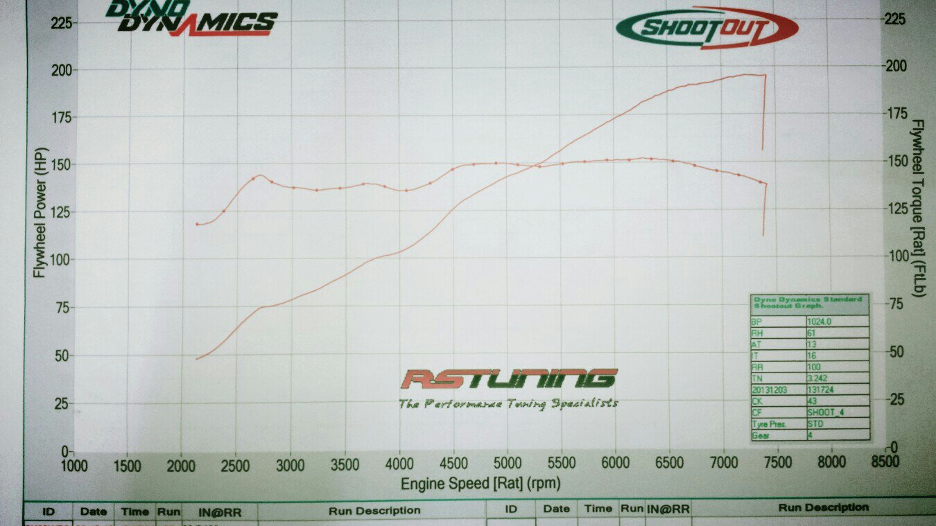

For the first time (in a long time) I'm actually happy with the car. It's always been run and mapped by Paul so the gains are consistent. Just from driving it you can feel the car has totally changed character on this inlet which for me is a small triumph as a lot of people hate it.
I am not dismissing or hating on the Surrey/Standard Cam chart Nick but my setup on standard cams also pushed 195.3HP (Historically on TDF's rollers) yet on Pauls it struggled to do 186HP so something amis there. Tweeking the timing is just such a pain in the arse, not to mention costly in travel and remapping, the camshaft upgrade was just an easy way to add some actual improvement in the the midrange and peak values. They came as part payment on a job to so not really a huge expense. I would just like to see what it would do elsewhere.

So you're saying your car made 195bhp on TDF's rollers (which are a different set of rollers to RST/SRR and well known to throw out some bullshit figures given what all the Clio racecars have made), and you think that's a reflection of what SRR's roller would show?
For reference my standard length RS2 made 191bhp / 151lb/ft at RST on one of the hottest days of the year, which says to me that if the engines good/timings right then you'll make good figures.
There's no doubting it was a cheap upgrade for yourself, however I think for a full paying customer its a lot of money to shell out for not a lot of gain.
But if you're happy with the difference it's made Mick then that's the main thing, however it's probably the lack of torque pre 4k and then the rise in torque from the (laughable) 197 cams torque that's made you feel like its much quicker.

No, thats not what I said at all so don't twist my words Nick... re-read it.
These engines vary loads, so comparing one engine to another is a bit pointless TBH, and comparing between rollers only makes it worse.
Mick's car on the same rollers, is way better with the cams than without so it makes them look a good option?

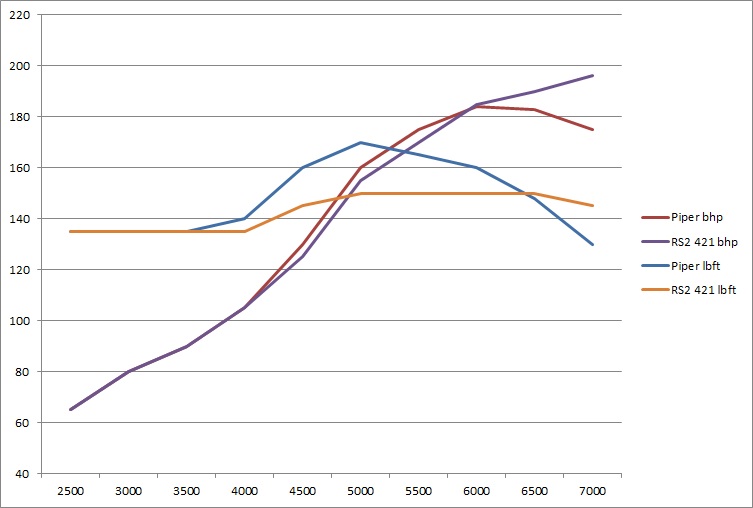

I wouldn't mind having a go with a RS2 inlet on mine.
I've got the Piper cams with headwork and 182 manifold. It makes 184bhp and 173lbft on the RS Tuning rollers.
I think with the RS2 and 50mm extensions I could make some more power and extend the torque curve a bit.
But its a big risk when I know I could just go for ITBs and make the numbers.
I've overlayed our graphs, although yours holds on for a bit longer.
Just an update, after looking at various graphs especially Ph1Toms ^iv decided on just getting matched inlets with my current mods and spending rest on suspension refresh and is now booked in at RS Tuning for Tuesday 17th so will post graph once I get it back. Still tempted by RS2 maybe later down line and at least will have a graph can overlay to compare differences. If I had choice again would have been much happier going for RS2 and leaving car standard as the results people are getting on this look really well.
