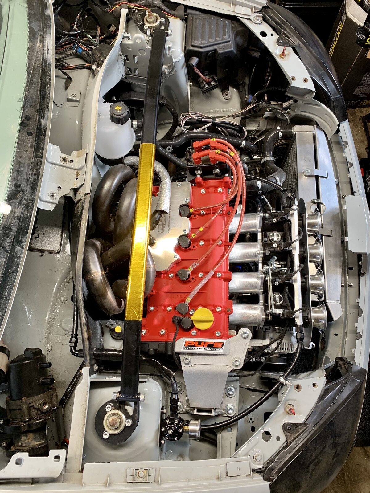

So I already own the ITB's, ZX12R kit from DanST
They're still sat in the box I had them in & I guess I'm getting cold feet now
I've always admired the engineering of the RS2 & wanted some extra info on it
Does it run off the OE ECU/loom & are there any extra sensors required?

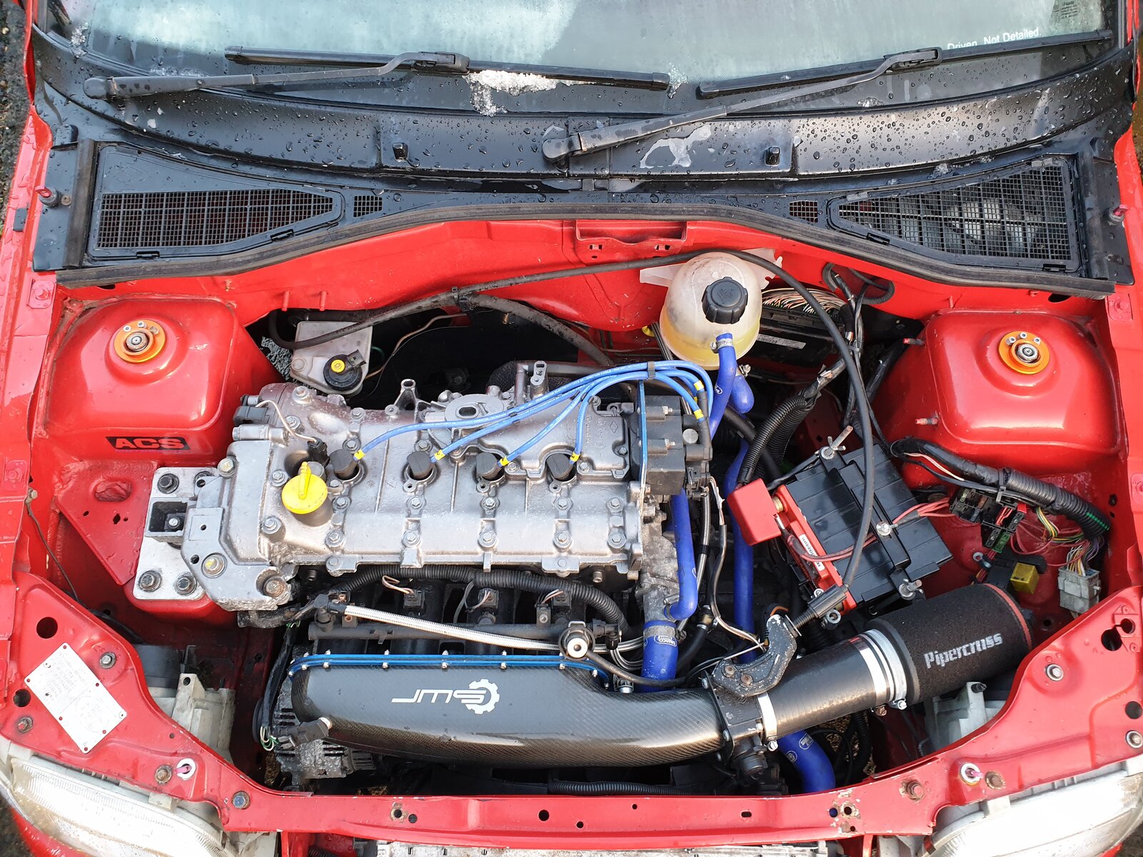

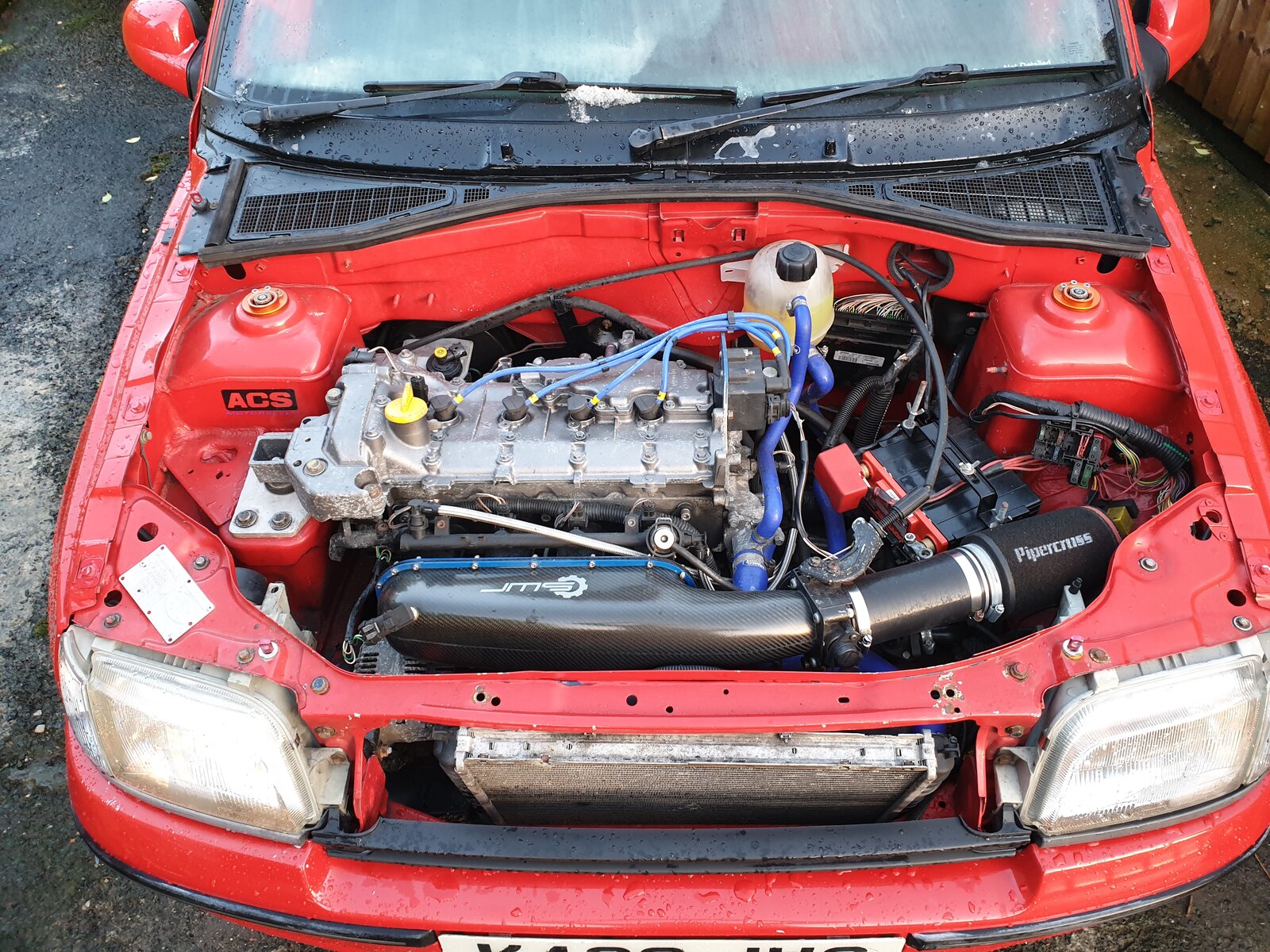

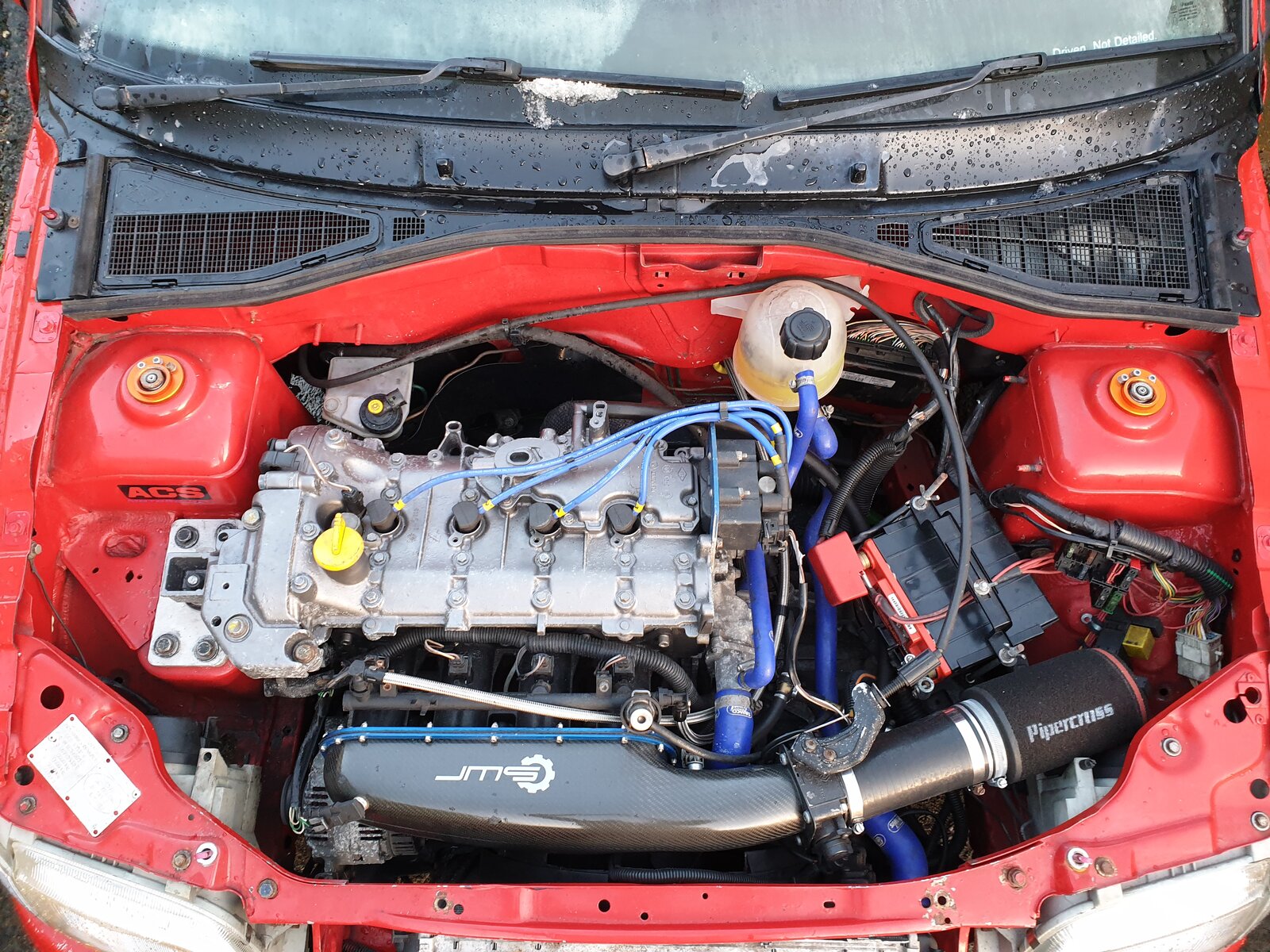

I'm an RS2 fan, bought mine second hand. Bolts straight on, no additional mods, run stock radiator etc and original wiring, sensors and ecu.
I fitted 197 cam, 8 degree inlet advance, 182 exhaust manifold and 197 injectors. Everything else stock.
Made 212bhp and 160lbft but from much lower down so very drive able.
It runs lamdas mapped out but still cold starts, runs and idles like a stock car

Loved my RS2 inlet aswell. Sounded really good especially with GrpN timing. Nice a torque curve with the inlet.
I’m moving Over to ITBs tho 😂
missing the simplicity of the RS2

Had jenveys on my cup, 438cams, gen 90 ecu but only made 200bhp.
Look good, sound good, but they’re not that fast.

If you've got all the throttle body parts and it's ready to go, I would probably just go for that. Selling it all and then finding an RS2 is probably going to be a bit of a pain. You've got the bits, so get to it (y)

I have an original rs2 (not copy) that I took off to put on Jenvey ITBs. It is a straight swapover just bolt on the factory throttle body.
If anyone is interested in it just private message me and we can discuss a sale price.
It does sound awesome.
Sent from my CPH1611 using Tapatalk
Brucefil
  Renault sport Clio
Had different head and cams so no direct comparison. The rs2 gives a very flat torque curve through the rev range and as a personal opinion gives a better induction sound than the it's. I think it is the carbon fibre that allows for such a good sound.
