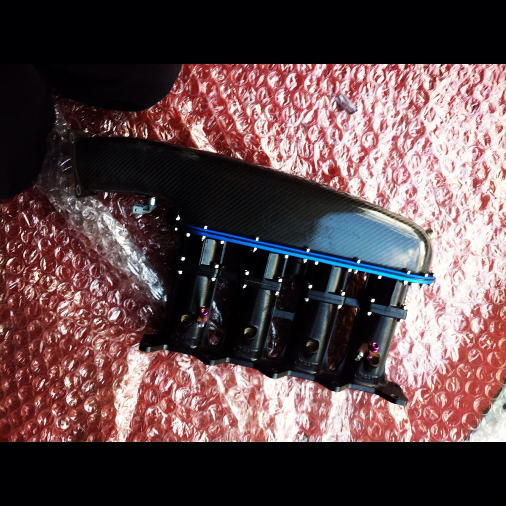

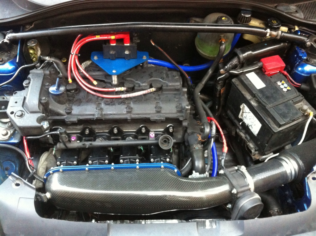

i then set about fitting my new recently purchased Rs2 Xtra and my aero catches
and finished
My only problem now is that i seem to have a judder as if the throttle body is cutting in and out.
i have changed most things including :
Sparkplugs
Throttle pedal
coilpack
checked injectors
new magnacore ht leads
the only thing i havent changed is the throttle body do people think this could be the problem ?
Cheers
