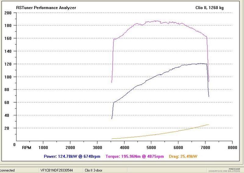

PA takes into account aerodynamic drag when calculating engine performance. Vehicle drag co-efficient and frontal area are the parameters required to calculate power lost to aerodynamic drag. These parameters are known by RSTuner after connection to the vehicle.
How does the PA compare to a chassis dynamometer
PA gives real world performance figures in power at the wheels. Not a single correction is made during calculation of the result. This is the power that the vehicle is putting down onto the road, plain & simple.
Every chassis dynamometer is different with different cooling setups. Therefore results will vary amongst different dyno’s.
NOTE: PA results are influenced by outside conditions like wind and road surface.
